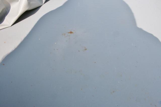

As I said in my last picture post,  Winter had not been kind and this was everywhere

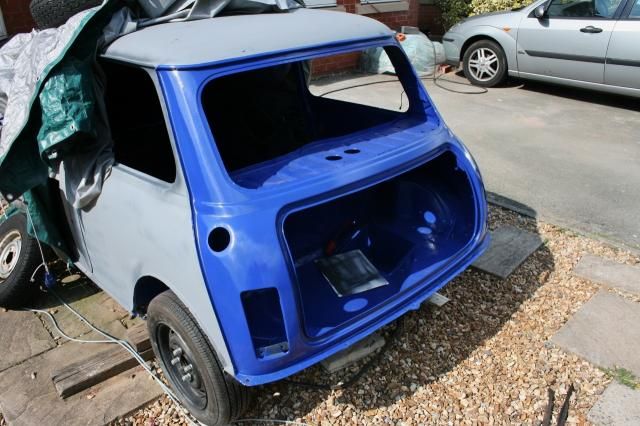

Every panel had it on so I got my fleabay DA sander to work with some 240 grit and took it back to metal,  etched and ready for paint.  I was going to spray paint it but have decided it needs protecting asap and rollering seemed the least messy way to get some paint on and keep the rust out.

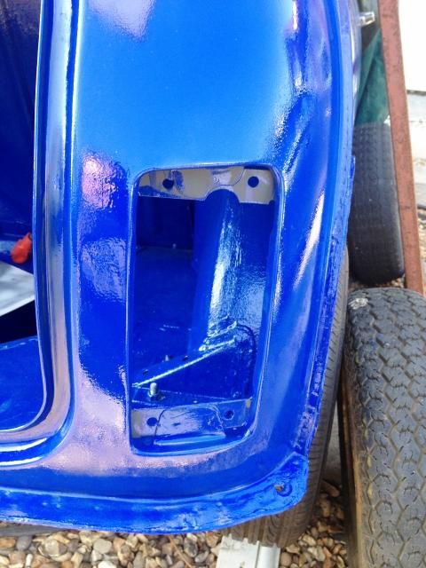

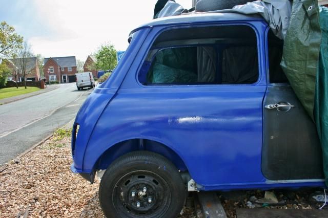

Not very good first panel,  very orange peely,  but I will be flatting it after every coat.  Here goes

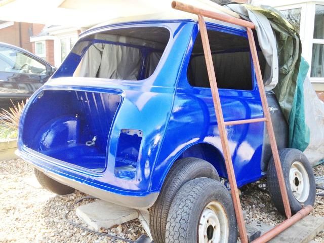

As I said the orange peel is horrendous and a lot of wet sanding lays ahead I fear,  still it will all come right eventually.  The rear panel went better and the orange peel was less
It is taking a bit to get the hang of it to be honest,  but each rollering is an improvement.  Only the two panels done as a test really and I need some foab brushes to get in the tight bits but pleased to have some on.

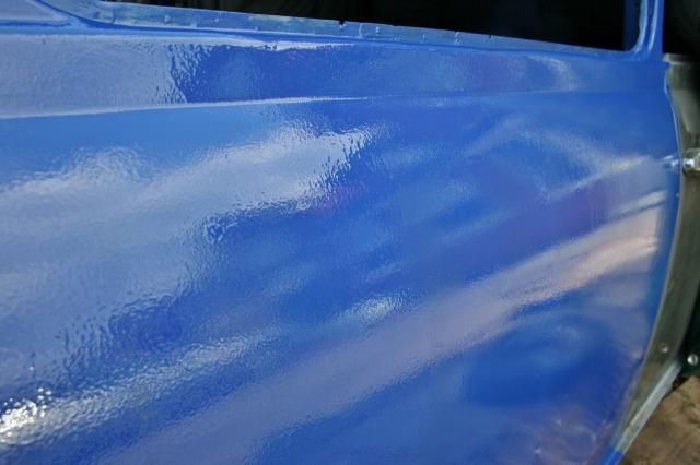

Have been asking a question and it does indeed look like I have put too much paint on and lots of sanding is indeed ahead.  It is as I said a practice coat so will adjust the next coat on the other rear qtr panel.

Maybe thin the paint a little bit more to reduce the orange peel. Should settle better. Worth a try! :thumbsup:

Have decided to experiment on the remaining panels to see what works best,  then have a good rub down and put some more coats on.  50:50 is as thin as I thought practical and have been told to try thicker mix,  very hard to get a feel for it so will play around next good sun.
