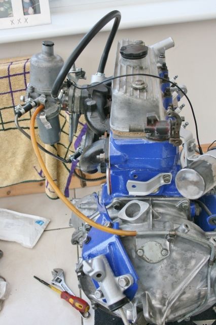

Hi all,

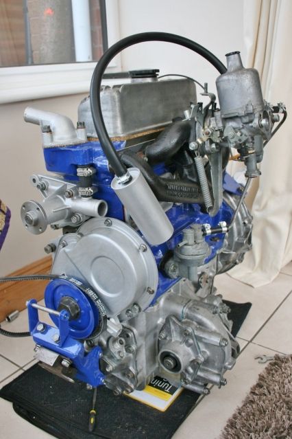

small update again, post Xmas a few bits arrived I have been waiting for, gaskets, pump etc so here is my engine now

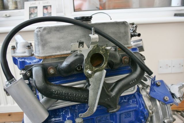

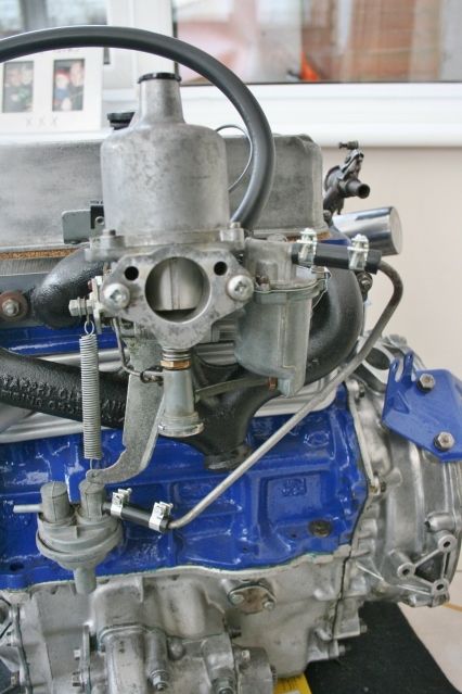

Carb has 3 gaskets on which I had forgotten, and is like a sandwich with the component parts. Gasket, spacer, gasket, spring plate, gasket and carb. As seen I used as I have done pretty much everywhere some gasket sealant which is supposed to take up any discrepancies in the mating surfaces of what you are putting together.
A sandwich later it was on

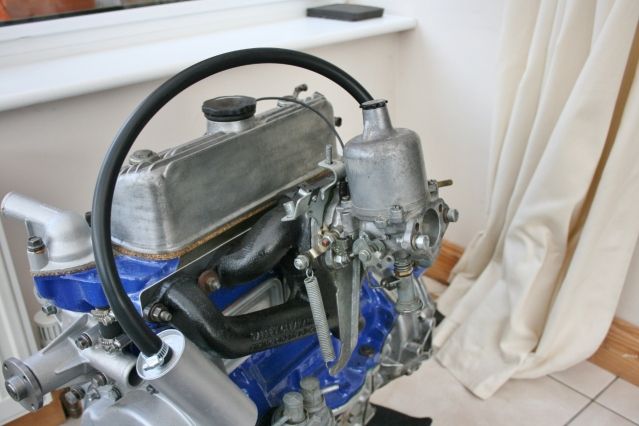

Tubes arrived too so they went on, breather pipe from crankcase to carb and fuel lines and clamps as the old ones were perished. I did have a crank case filter/breather pot on, but was told the pipe allows the crankcase fumes to be burnt up in the combustion mix and therefore not linger around the engine compartment, so it's on, although not happy about the huge pipe !!

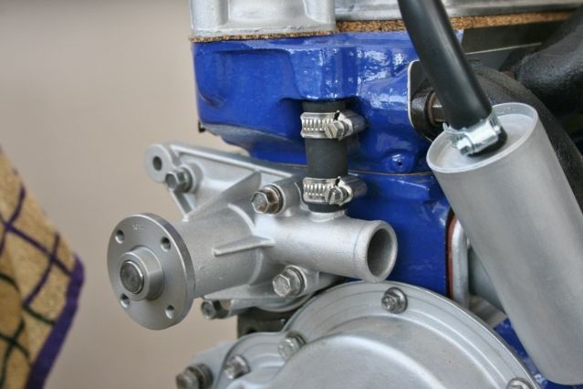

Last few bits were the carb float chamber overflow pipe, (I think it is that, the yellow tube), and new water punp with bypass hose. Not sure what the bypass does but it was on before so it is back on.
Nearly ready to fire it up, plumb in the water side, oil in, time and go. Or not as I am dreading !!
regards,
Graham
Edited by grahama, 06 January 2013 - 04:57 PM.

That engine is looking superb.
Are you going to put it in the car to fire it up ? Or start it on the bench ?
I hope your son realises how lucky he is
Andrew.

It looks fantastic if mine looks anything as good as yours I will be a very happy boy!!. Don't forget before you pour your oil in to put the pot joints back in or the oil will just run back out the bottom you prob know this already but you never know with all the other things to worry about on first fire lol good luck
#750 grahama
grahama
  • 2,442 posts
  • Location: Warrington
Posted 06 January 2013 - 05:13 PM
Ta for that Darren, had completely forgotten that. They are outside on the driveshafts all cable tied up, bugger !! Better to get them off than have oil everywhere tho lol.
