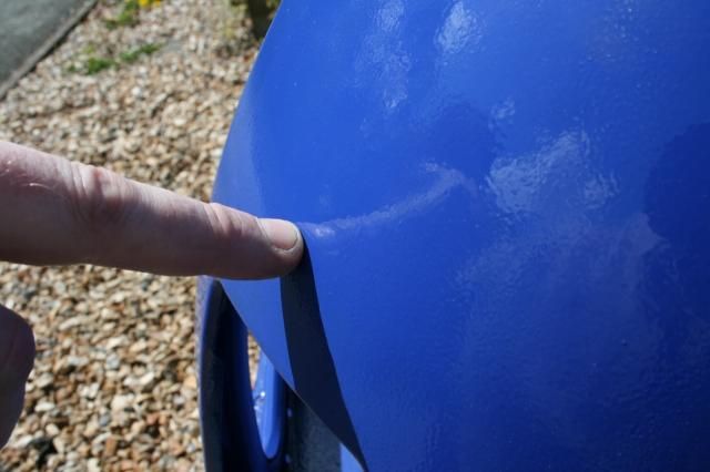

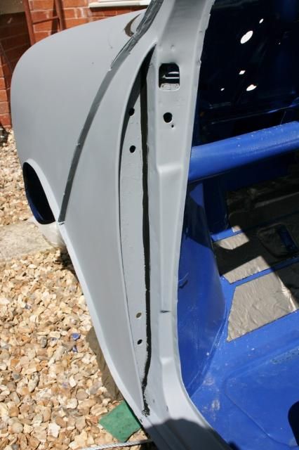

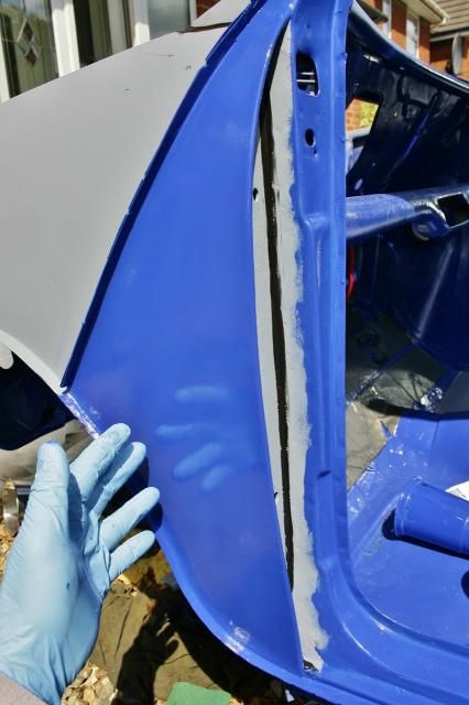

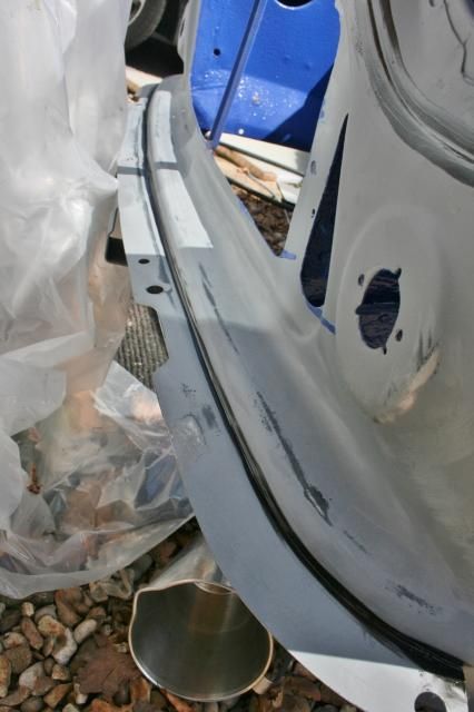

Started with taking off the surface rust again around the door apertures and front and tiger sealing the scuttle and front panel joins.
Looke a bit messy,  as my sealant work usually is,  (just can't get the hang of it,  never have),  but it is smothed off and feathered out so should look fine.  I also did the bumper panel lip and found a gap in the door hinge panel area so did a line there too

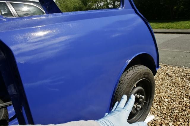

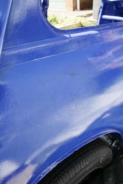

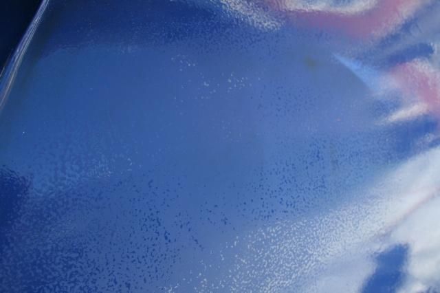

I looked over the first attempts and in places the orange peel was poor but in others it had settled better and had a shine to it
The rubbing down I mentioned earlier came out well in daylight too for the couple of minutes I spent on it in darkness !

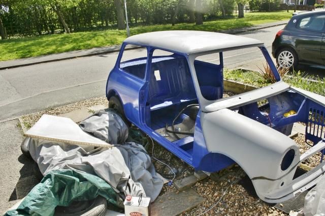

I then set about rollering and foam brushing the rest of the rear section up to A panels
I seemed to be getting the hang of it as it was showing less peel and more depth than my first attempt,  still mixing at about 50/50 with thinners.  I don't think that with rustoleum it makes a great deal of difference getting mixes exactly spot on ratio wise.  Too thick more flatting,  too thin,  more coats and then flatting so will continue with my ratio as is for now.  When I really get the hang of it I will up the paint a little.

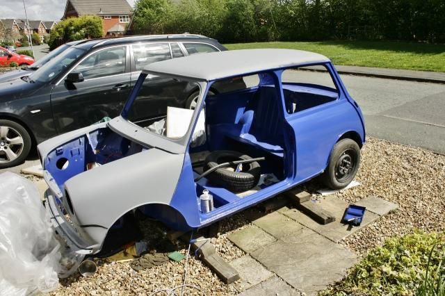

This is where I left it
Let the sun get it nearly touch dry,  covered up and as the last sheet went on,  the heavens opened and we had a hail storm with thunder and lightning,  bloody British weather lol.
feeling more optimistic at present about finishing.
Graham
