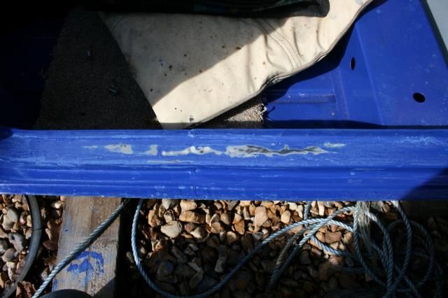

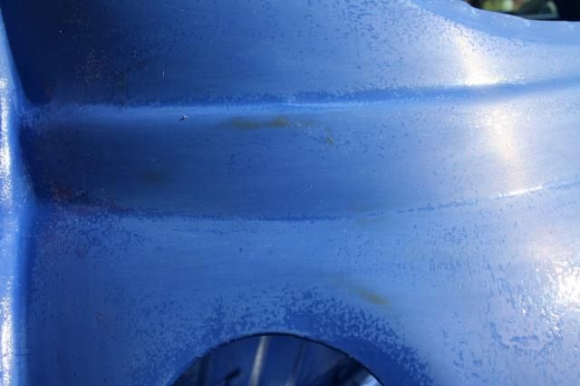

Hi all,
another day,  another opportunity to slop some rustoleum on the shell.  Windy as hell but sunny and one shower so not ideal conditions,  glad I am not spraying as would have covered the neighbours' drive in paint !!

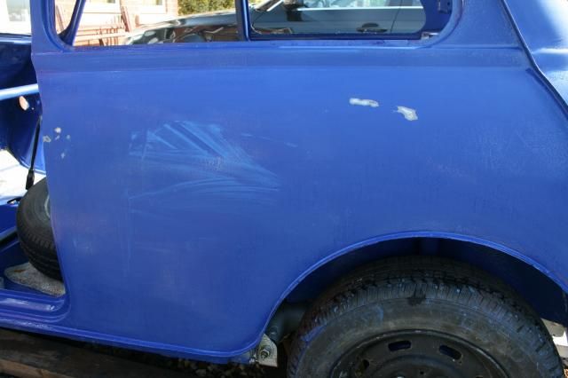

All going well,  2nd coat now,  new rollers,  trays,  sponge brushes,  even a new pot of paint !!  Orange peel a little less than the 1st coat after a 600 grit rub down,  but then noticed a few problem areas on the shell.

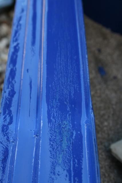

The doorstep isn't that much trouble to rub down and re do,  but the a panel and a couple of other small areas are more of a worry.  Did the 4th coat on the boot,  no reactions and is looking good,  and the bonnet,  which I had the worst reaction on.
There are a few patch, rather than lines on the bonnet too,  just don't know what I have got contaminated with.  The lines on the bonnet suggest tray or roller contamination but I panel wiped the tray first after the shell problems,  which leaves the roller!!  Gave the bonnet and shell a good panel wiping before any paint,  maybe a little wet sand residue left,  just don't know,  VERY frustrated,  thought Rustoleum was pretty bomb proof !!
Anyway,  more sanding to come lol !!
Graham

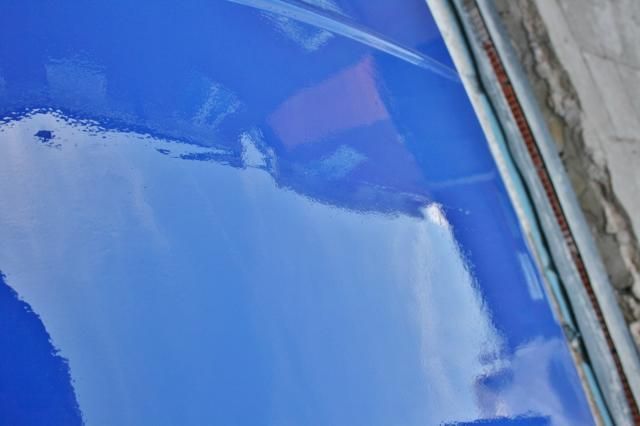

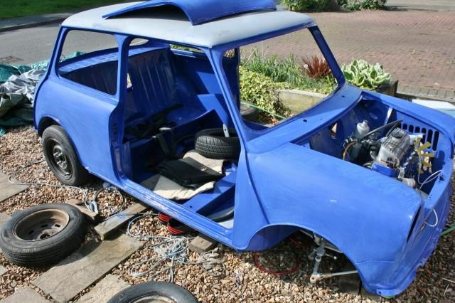

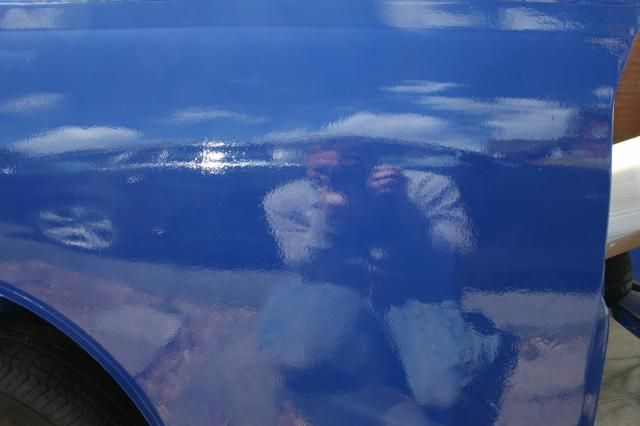

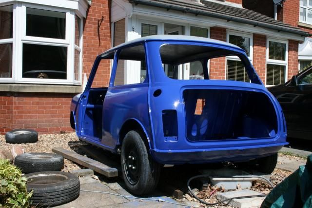

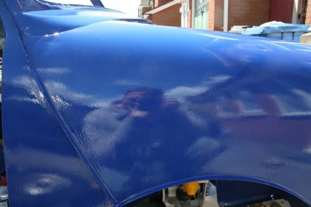

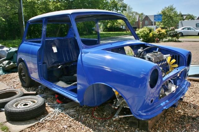

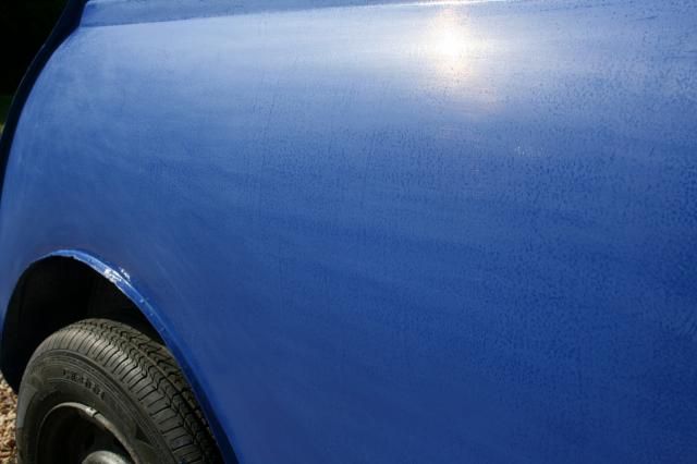

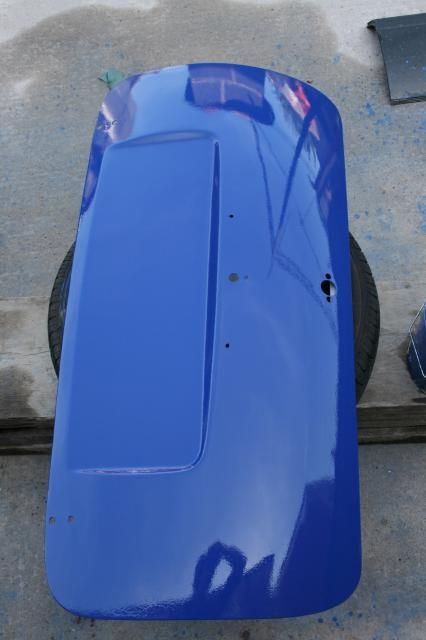

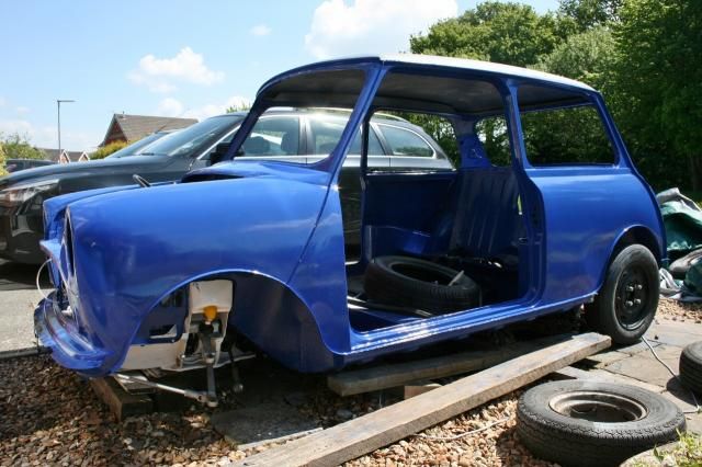

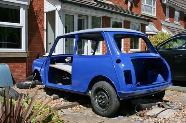

Hi all,
Dave,  glad you are finding the thread helpful, there are so many good build threads to choose from for info.  Thanks for the comments fellas,  always appreciated.

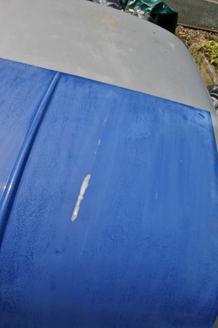

Sooooooooo,  reaction sort of dried,  I flaked it off with me thumb nail and gave it a good 400 grit and went to bare metal in a couple of places.
I patched a bit of paint on the shell areas so it could dry in the sun and rollered on another coat on the bonnet and boot.  Looks ok but the reacted areas have a small dip which will need some extra work if I can be bothered when it is done,  depends how it turns out.
Rubbed the affected areas on the shell with 400 grit and the rest 600 and cleaned thoroughly with soapy water and then panel wipe leaving a typical area to roller on like this
Can't get much cleaner than that !!  Rinsed rollers,  brushes and trays in panel wipe just to make sure and went for it.
Rubbed down, again, lol ,  a bit too much in places !

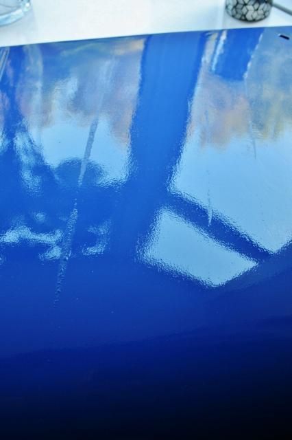

3rd coat on
Sun was warm and the paint didn't half dry quickly,  sometimes once I had done the tricky bits with a foam brush,  a line had formed when I started to roller,  fortunately it was just wet enough to remove after a couple of minutes.

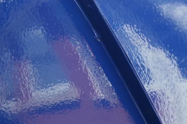

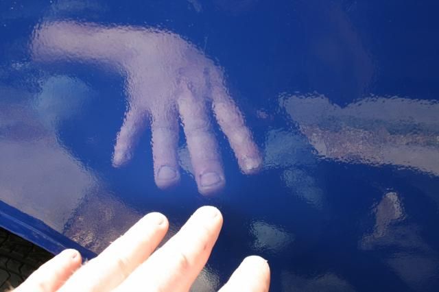

The peel is still there but the wet sanded surface is getting better and this is showing a bit more depth to the paint,  if as I said,  a little peely at the moment.
Almost dry already after two hours so well pleased I got up early to get a coat on.  I think this will be a 10ft paint job to be honest,  but at least it will be protected.
Graham
Edited by grahama, 26 May 2013 - 12:59 PM.
