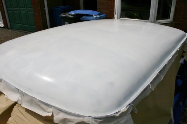

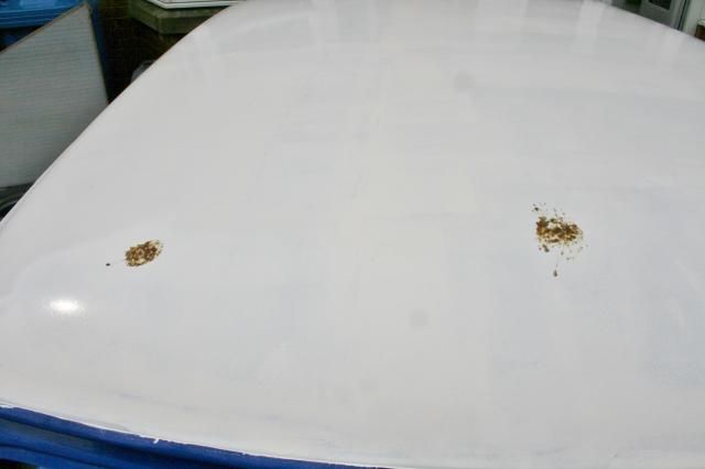

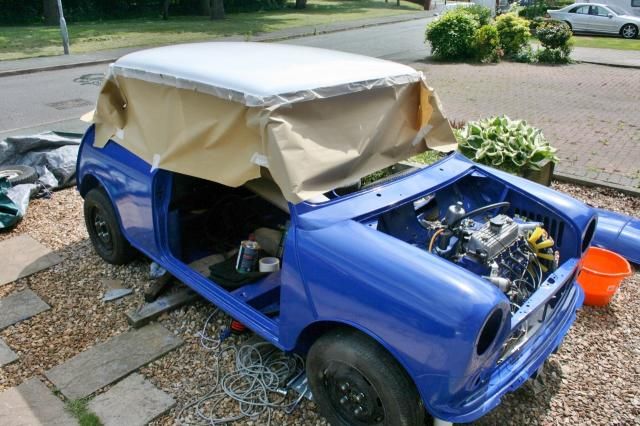

Had a nice visit from Carlos (My engagement present project thread),  as he was passing,  and I blew him away with how well I have hidden all the bodgery that I have done lol.  As soon as he went, (that sounds bad,  but you know what I mean),  I taped up the roof and slopped on a first coat.
Very patchy as the first blue coat was but being white it shows more.  It's on though and should stop the rust coming through.  Got to be very careful whe doing it as drips are the enemy.  Very close to dripping it on the blue paint.

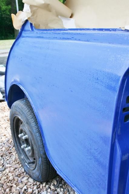

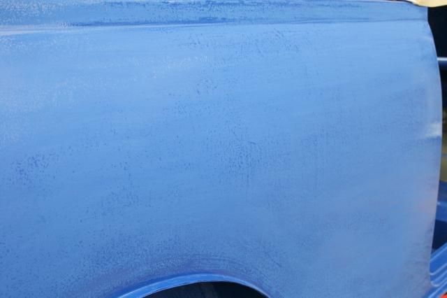

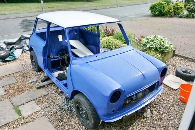

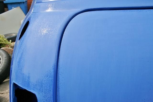

While that was drying I rubbed the shell down with 1200 and the peel is getting less each time

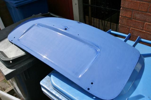

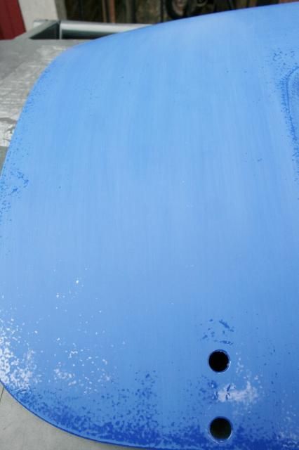

The boot lid I did the same with and after 5 coats it is nearly smooth
As a comparison boot to shell
I think another coat on boot,  6,  and will be enough.

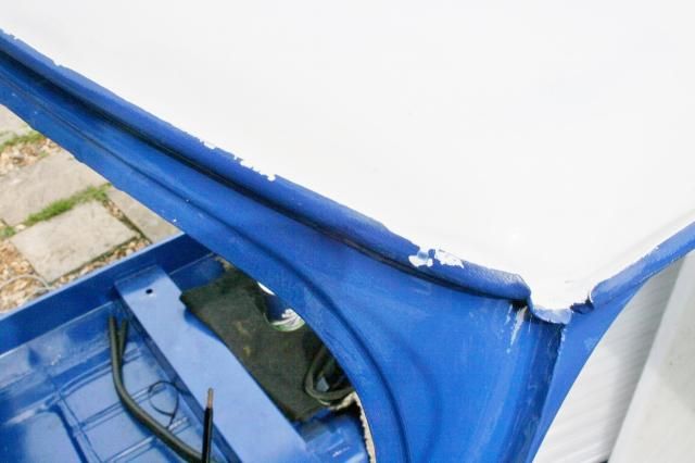

The roof gutter will need a touch up but it will have a trim on it so not a problem

Just dry enough to get off but the back of the car was covered,  roof,  boot,  rear qtr,  nice !!
Left it like this but not convinced about the white,  maybe black would be better??
