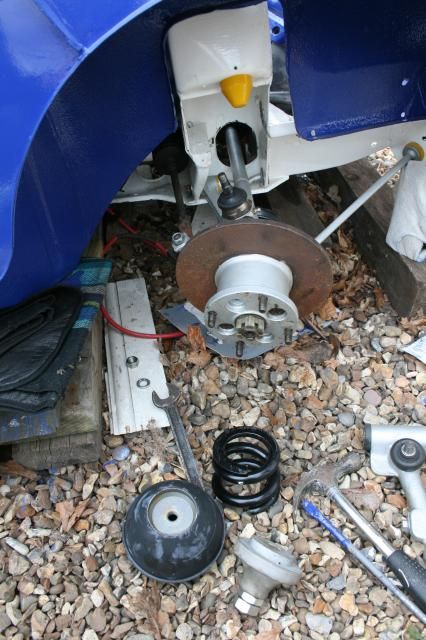

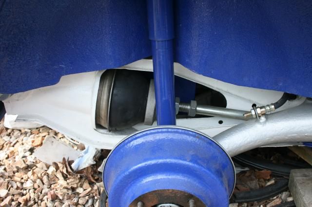

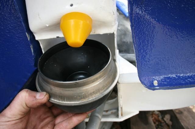

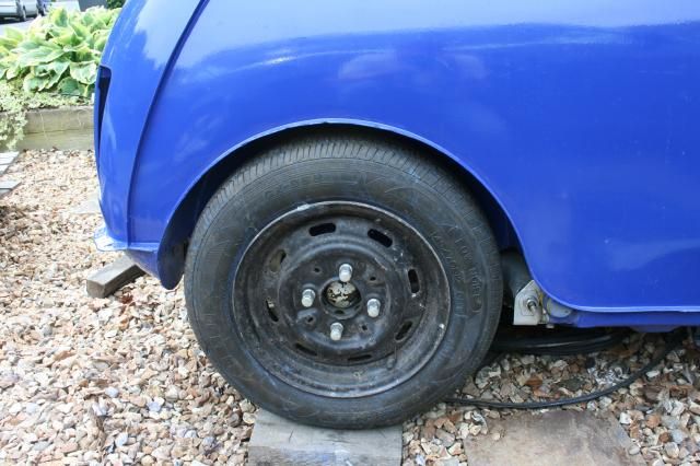

Started by fitting the rear cones I bought recently as I just didn't like the way the springs sat,  but that is just my personal opinion.
Went in a treat but need adjustment lol

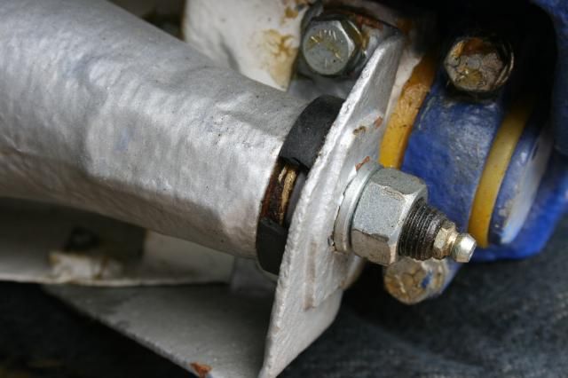

One thing that has not faired well is the dust seal on the end of the radius arm which has perished and split on pretty much all seals.

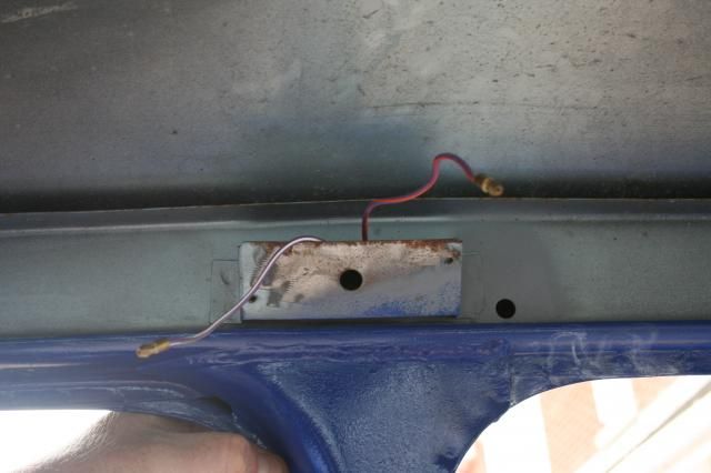

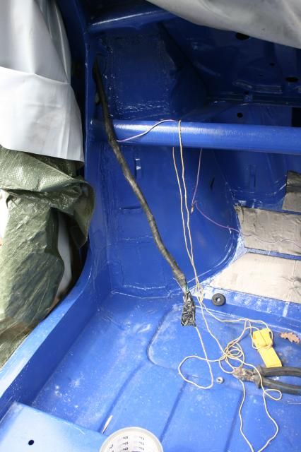

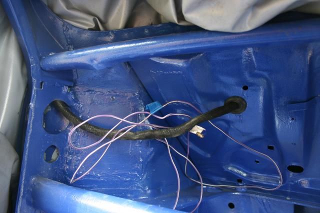

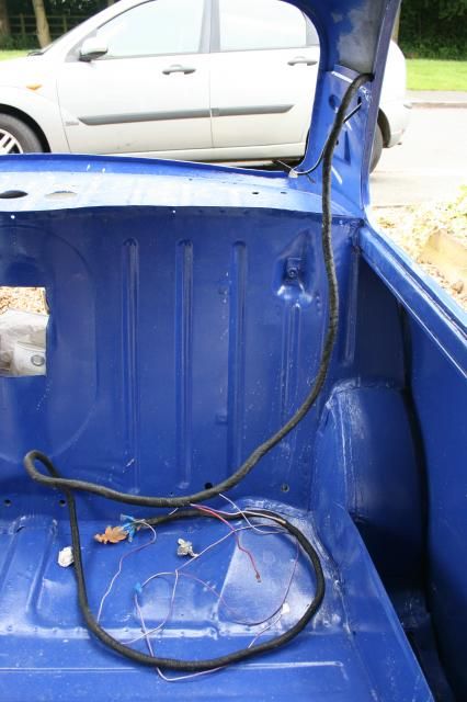

I want to get it water tight asap so the rear loom was next,  threaded in using some cord.
No problems and everything wire wise seems to be in the right place so happy days.  Popped the loom through to the engine bay,  amazingly I still had the grommet !
That done I can get the headlining in soon and windows,  but tried to sort the front cones first but they seemed too wide to fit up the turret.
I have to wiggle them up apparently to get them in,  it's been so long since I stripped the front subby I had forgotten.

cant believe its been that long!! its faired fairly well really!
the donut should go in, turn it sideways a little and it should go!

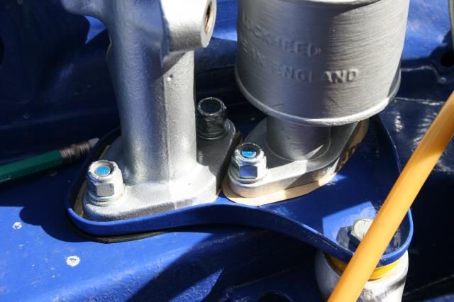

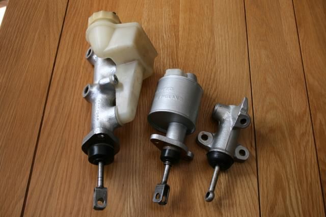

A little more done today, just rebuilt the brake and clutch cylinders ready for fitting.
Also sorted out how to fit the cones but have to wait for dust seals before I put it all together.

Sun out so did a few bits,  first a pic of my master and slave cylinders from last time

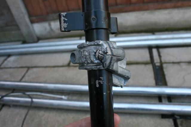

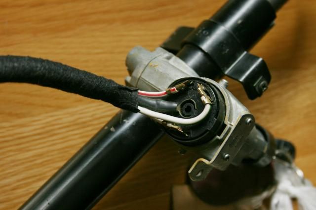

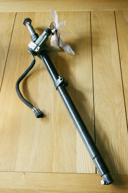

Next was back to the grinder to get the old sheered off ignition barrel,  cutting discs don't like aluminium but they got it off and I fitted my fleabay replacement.
Not sure if this should have a cover on it though?  All the ignition wires are open inside the steering column cover if not.

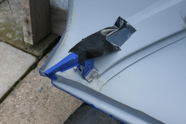

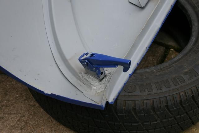

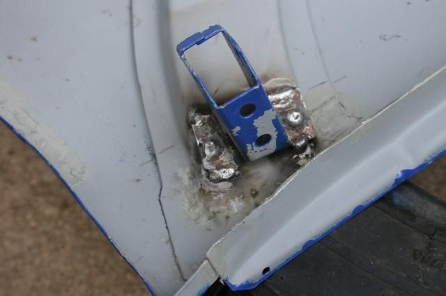

Next welding,  thought I had finished this part of the resto but I had not put the bonnet latch back on. I marked,  welded and seam sealed the welds.
Not my best welding but a couple of plugs ans a few bits on the side and it's not going anywhere.  Just needs some paint on the inside now.
My radius arm dust seals came but I desperately need a cone compressor to get the cones in,  ahhhhhhhhh,  but I will sort soon.

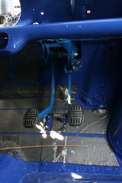

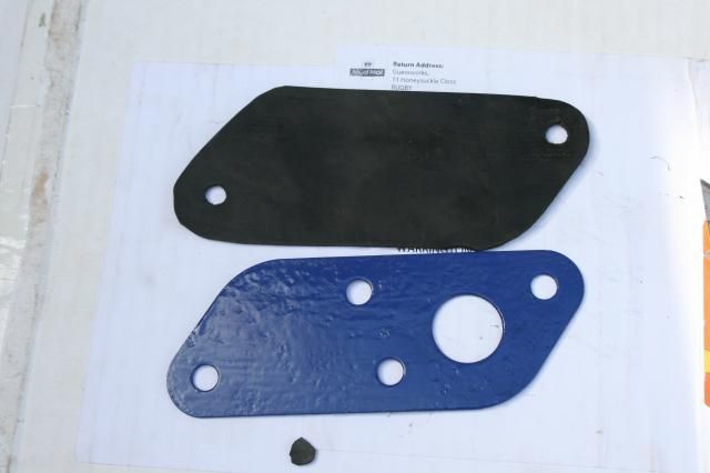

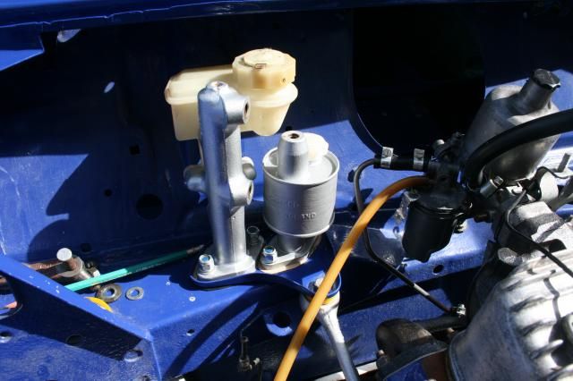

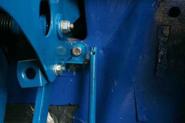

So I decided to fit the pedal box and master cylinders.  What a faf,  I forgot how it came out so scratched buggery out of the footwell paint but it will be ok with a touch up,  it's under carpet anyway.

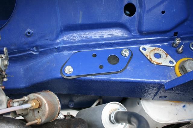

I made my own seals and paper gaskets as I couldn't fine any proper ones and I hav some 1mm rubber and gasket paper.  Also did the blanking plate for the other side.
Inside
I fitted a piece of the pedal box with a little bit of rubber on it.  Can only think it goes here as a stop for the accelerator pedal. Am asking in tech section.
Things are slow as the paint means things are tighter than they were originally,  and I can't find all the bolts because they were probably rusted !
