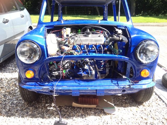

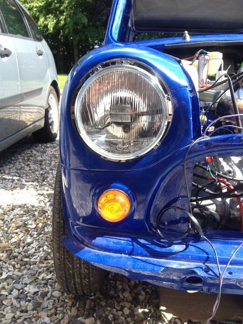

Cover off and it seems to have stood the Winter nicely. Electrics were the order of the day, testing, fitting stuff back and trying to find earthing faults.
It now looks like this...
I went for the landrover style indicators as I like the look better than the chrome mini ones, purists dont shoot me lol.
After spending a day trying to find out why the hazards weren't working or the brake fluid indicator I found three earth problems, easy 2 minute fix, but finding them was very time consuming.

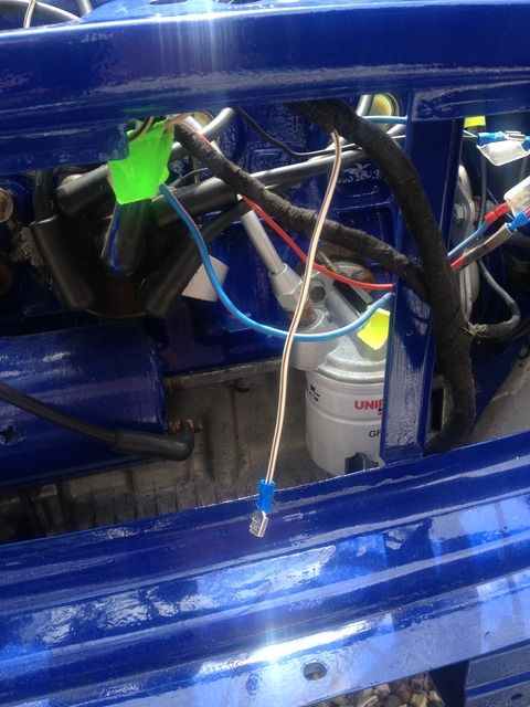

The only thing that doesn't work is the single use wiper function of the stalk so I will do some investigating into that. The binnacle I got went in and lights are coming on but I have a short wire which I think is for the oil sensor switch on the block.
Pretty sure this wire is for the oil switch !!

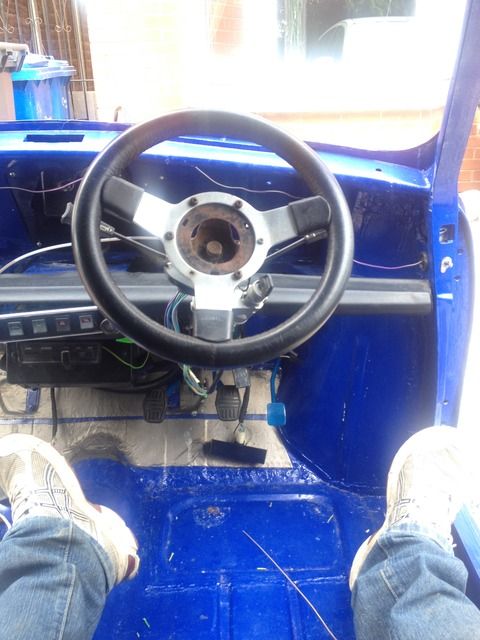

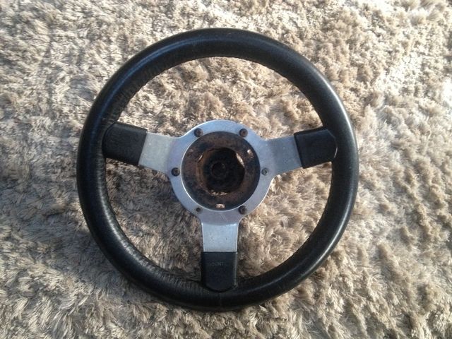

Ebay bargain again this week, new steering wheel.
Nice 12 Mountnay wheel in great condition with a simple but effective boss all for £6 !! Looks nice on
I have had to extend a few wires as the wrapping of the loom seems to have been a tad too extreme and there isnt enough wire showing in a couple of places. The headlights are the worst and the new halogen lights have to be extended by about a foot on the passenger side, not a major problem but annoying all the same.

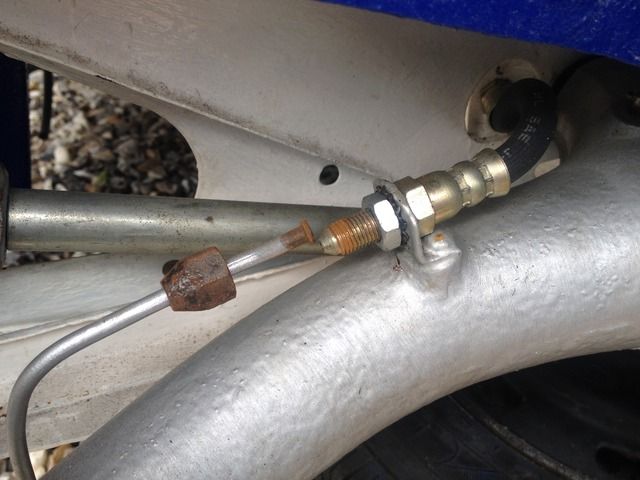

I also started to bleed the brakes with an Eazibleed kit, however when I tried to leak test the system I realised after an hour I had no bleed nipples in the rear brakes so that job stopped lol !!

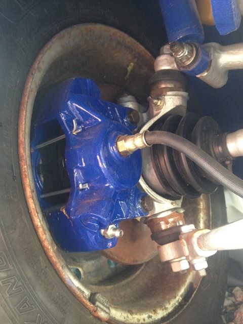

All sorted and air tight but no joy.  Fluid came out of all four corners in the correct sequence but still a spongy brake pedal.  I have been reading around the subject and I may have my callipers on upside down but can't think why it would be a major problem.

Thanks for the advice in tech section, I have done it again with calliper swapped around and I have a brake pedal now. Such a small mistake and such a problem, but I suppose the master cylinder isn't pushing much fluid to make the brakes work so only a small air gap will stop things working. Lesson learnt !!

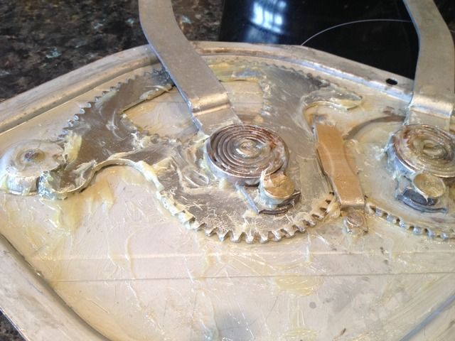

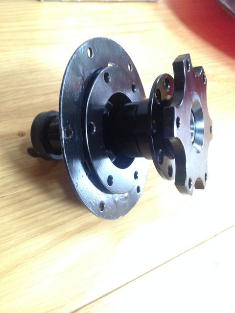

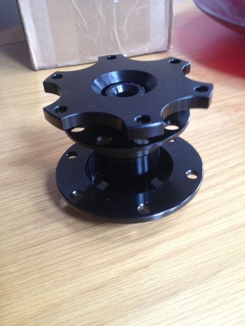

First a few bits cleaned up and re greased like these bad boys

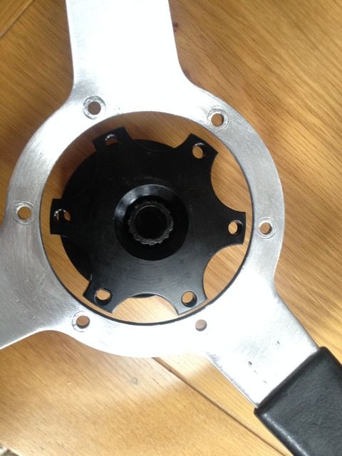

and got my quick release through off ebay,  a sparco one but will need to make an adapter plate for my steering wheel.

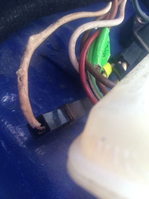

no spark, although I had one b&w wire connected to the +'ve side of the coil and instead of looking properly I swapped wires about retried and fried a points set.  New points in, wires correct on coil still no spark and when I let off the ignition switch I melted a wire.
It's the ignition white wire that connects to the ballast wire in fuse box terminal 1.

Took the loom out of the mini today to check for burnt wires but after stripping it back it looks like the only melted sections are on the exposed ends not into the wrapped sections which is a bonus.
I originally extended a white wire with a white/black wire and mistakenly connected it to the -'ve side of the coil when it is actually connected to the switched live so a mistake there  think.  I have posted to the tech section with a wiring diagram to check this.
I have to cut back and extend the crusty wires with good wire now and try again.  I do however have my test loom that I will try before I put my loom back in.
