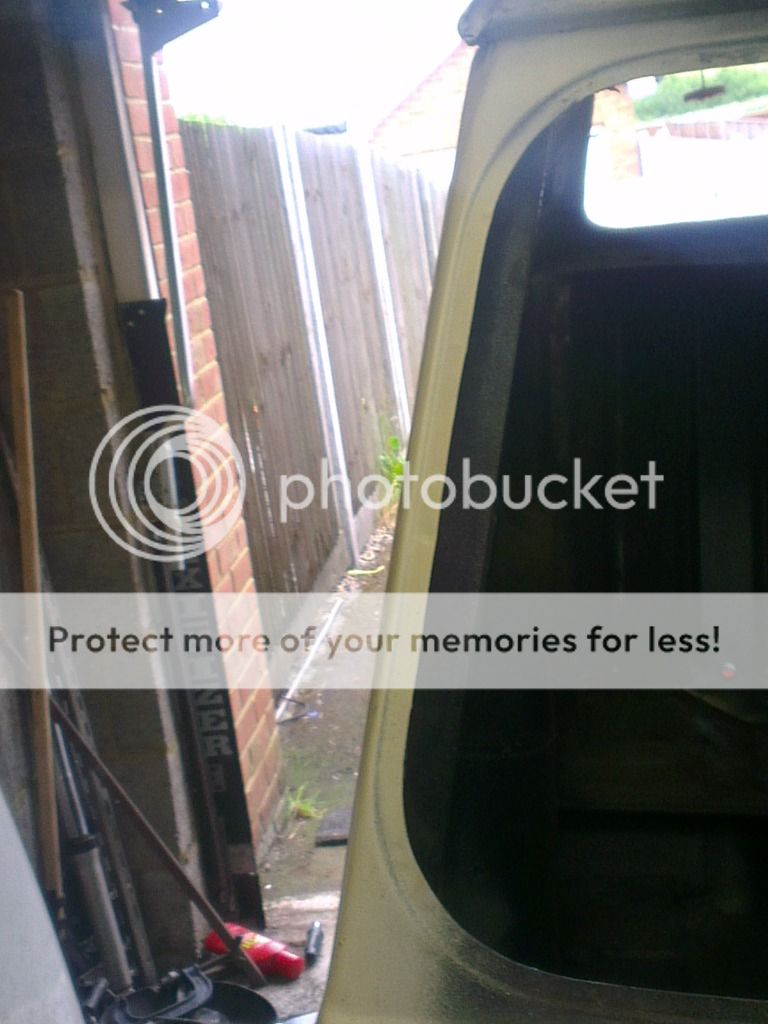

#288 Carlos W
Carlos W
  • 10,115 posts
Posted 06 June 2013 - 04:18 PM
Lovely door back from my dads!
I'll be able to get the o/s A panel fitted now
