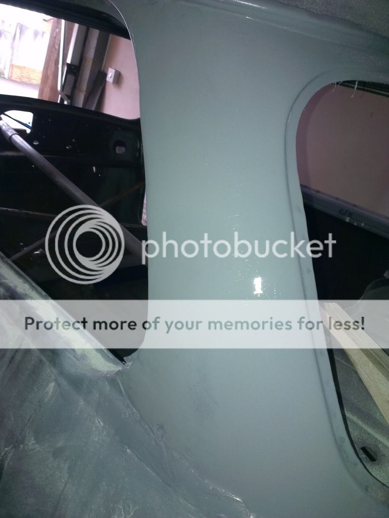

This is finally somewhere near how I want it, I've just sprayed it with high build primer, which I'll rub down tomorrow then I'm going to try and get the lines right at the weekend!

After making a mess of the C Pillar by putting on too much high build primer whilst it was too cold I abandoned that and went back to the front end.
