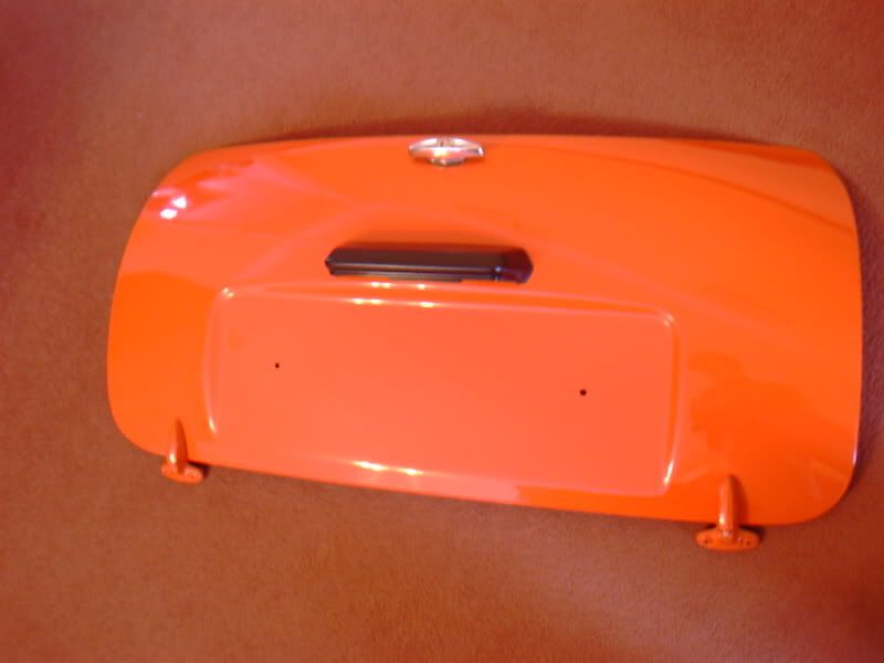

Next week = Bodyshop, or at least I hope so ^_^

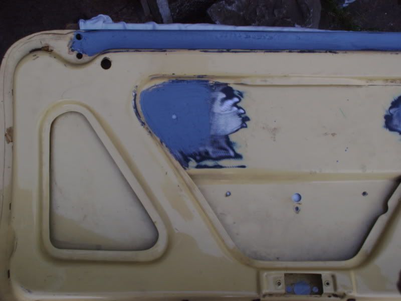

Preperation:
Daddy having fun :(
Same colour, honest!

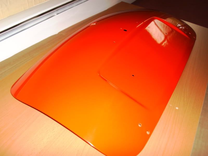

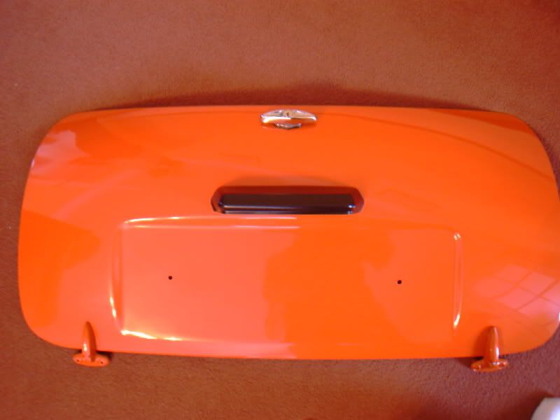

:( Semi smooth boot:
(No badge)
Due in bodyshop...

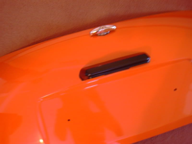

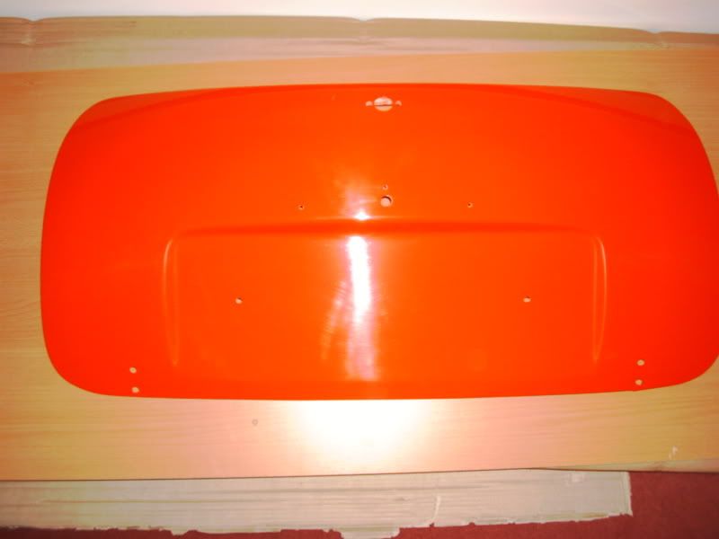

Progress... Its Vermillion red...Honest!
:) :proud:

Looks good B)

Either your using too much flash, its in direct sunlight or someones seriously buggered up with the paint code :proud:
wayne
#191 Lund
Lund
  • 1,864 posts
Posted 10 July 2006 - 01:22 PM
wayne
:) Under an orange street lamp it turns brown/green ;)

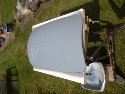

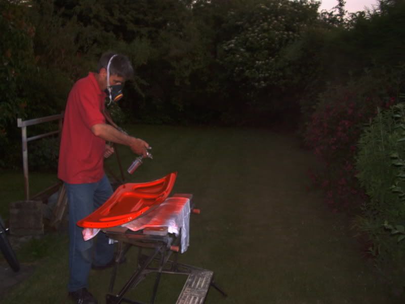

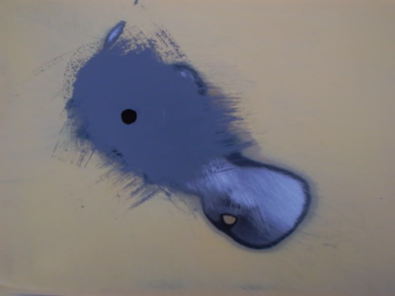

What sandpaper did you use to feather the boot again i know it was wet and dry but what grade? I love the finished project did your dad do it it looks good :proud:
#193 Lund
Lund
  • 1,864 posts
Posted 10 July 2006 - 07:02 PM
What sandpaper did you use to feather the boot again i know it was wet and dry but what grade? I love the finished project did your dad do it it looks good :)
*Takes a breath*
Ok...
Well started with 320, sand it! Then used 800, primer it, 800, primer it, 1000 , top coat, 1200, top coat & Buffer until your hearts content! Yes daddy did it :proud:
Tom ;)
#194 clarks.2006
clarks.2006
  • 545 posts
Posted 10 July 2006 - 09:37 PM

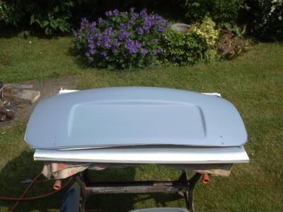

So do you like start with 320 sand that until top coat is off? Then use 800 till it feathers out then primer then 800 agen till feathers 1000 till feathers then top coat then quick 1200 then top coat then buff it up? thankyou for your help!
#195 Lund
Lund
  • 1,864 posts
Posted 11 July 2006 - 11:56 AM
I dont think theres need to take the top coat off completely, I had loads of high spots and low spots in the paint, so I used 320 until I got a fairly smoothe layer of paint. Then used 800 to feather in parts, then primer light sand of 800 again, primer another light sand of 800. Primer then use 1000 and get it real smoothe, use luke warm soapy water here as it helps smooth it! Dry it, top coat it. Then 1200 it even more smoOOothe! Final top coat and buffer. :)
