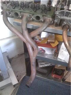

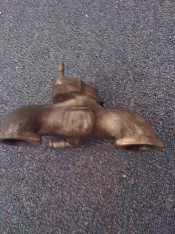

Hey all, I have been busy spending money on my pocket rocket! Spent a few bob on ebay, including a Smiths Dual Oil and Water Temp gauge
and also an unleaded head!
What do you think? Is it worth getting the head gass flowed? Or making an modifications to the head?
Its a Cam 4810 to go on my 850.
I am also currently buying a Cooper Freeflow and alloy inlet manifold:
Tom.
