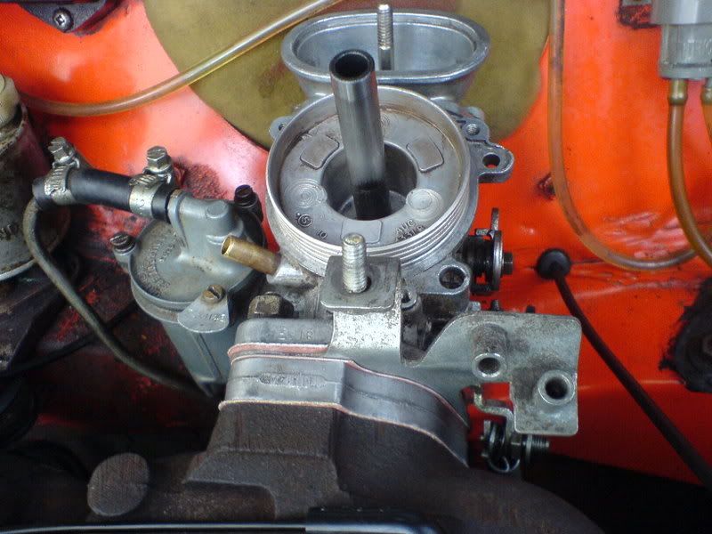

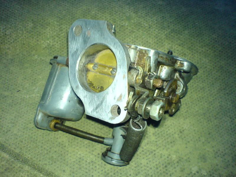

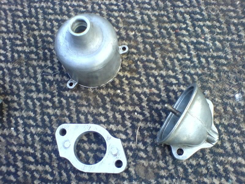

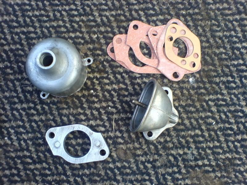

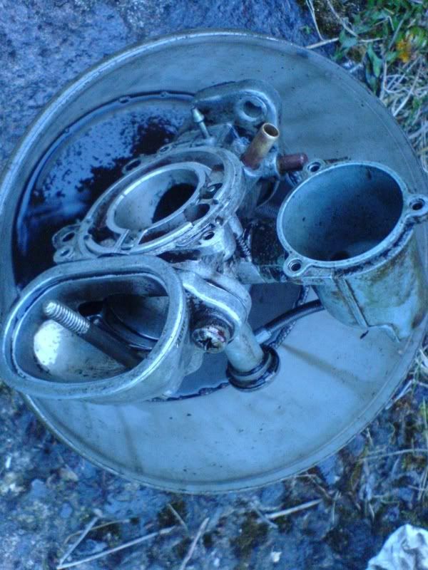

I am currently refurbing the carb as it leaked alot of petrol from the hose between the float chamber and shaft, so have tightened that back up and cleaned the carb in petrol and with panel wipe. Takes ages to get all of the grime off! I have given it a light sand inside also, pics so far, will continue with it tomorrow to hopefully get some better results. The carb is a HS4, I hope to try get it setup again tomorrow, might need your help! Will keep you updated:

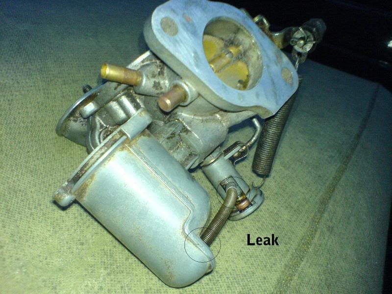

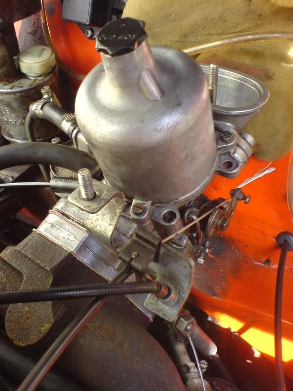

Finished re-rubishing the carburettor now, the bloody thing still leaks! ^_^ :o Which is frustrating. Also managed to sheer the pin and bolt that holds the accelerator cable on ;D I overcame this problem finidng an early HS2 carb in the garage and took the one from that!

i think yours is a waxstat jet which are prone to leaking i believe. i think you can get a conversion kit from http://www.burlen.co.uk
Its leaking from the small pipe that connects the float chamber to the shaft, whats that bit called? Its a small pipe with a spring coiled round it.

yep that the jet assembly-capstat type. just get a new one of those from burlen.

did you even look at the link? this is the other type of service kit for an HS4 and it aint nothing like yours: http://www.minispare....aspx?pid=38188

Sorry, yes I looked at both links, got mixed up by the red ends! You're correct , mine is a waxstat. I have just ordered the service kit, many thanks :cry:
