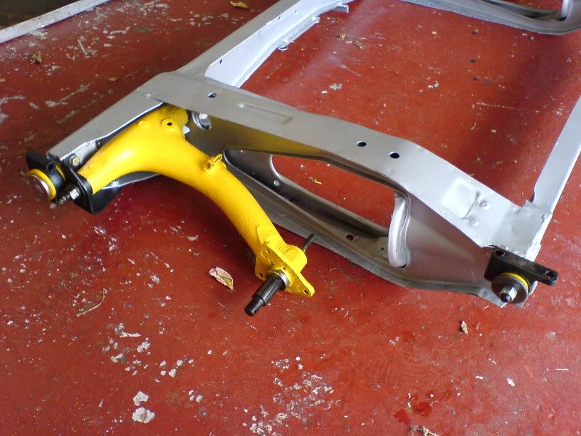

Hammeriting rear subframe
Got to get some late subframe mounts to match up with the bushes and bolts I've got! Then paint them all up black to contrast the silver subframe and set off the yellow bushes!
Dont forget to cover up those big holes in the back edge of the subframe that can be seen in the picture with some duct tape :(

Yeah? Wasn't done on this or the subframe that came off the estate but ok! :D

yep defo do it. its how they came from the factory and it stops them filling up with crud from the road, and rusting from the inside out

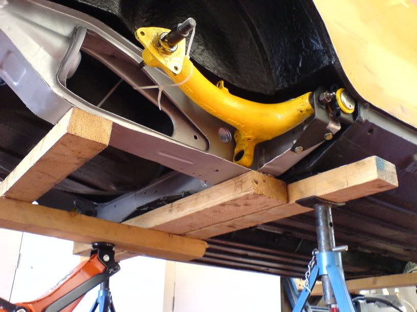

right, started putting the rear subframe on today! (sorry about big pics, new phone camera!)
Offering it up (but i've got the rear trunnions the wrong was round :withstupid:
What do you think of the colour coding? Too much? Tacky?

think the colour coding luks good!!!

As above, yeah.

looks quality!! you ned some backplates for those radius arms though :withstupid:
did you mean the the front trunnion poly subby mounts are on the wrong way round? because i put them on the other way round!

Nah the rear cast iron trunnion mount is on the wrong way
(well i followed a picture in some parts catalogue (that huge one they were giving away at L2B (another story)) but in the Haynes and on my red mini that trunnion is on the other way round.
But should that bush be the other way round then? As in big side on the inside?

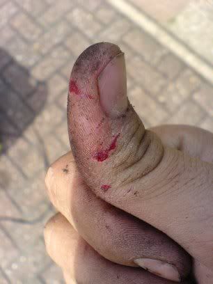

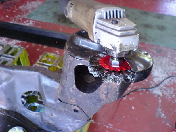

Had to stop work on the rear subframe, awaiting a few more new parts from SC Parts (anyone used them before?) so I've dug the front subframe out and started cleaning it up. Should have a layer or two of hammerite on tomorrow, then I gotta get some paint on the bulkhead before that goes on! :proud: big step!
Here my new wire angle grinder brush that is gonna abuse the surface rust and underseal on the subframe!
No pain no gain. My thumb got a bit close to the brush (after i took the guard off ;)) there was actually a bit of wire stuck in my thumb there :) I didn't cry

That wire brush is one of the best tools I bought, but, it seems you have already found out that it can be rether dangerous. My advice is to use a full face shield when using this as those shards of the steel wire will make a real mess of your face or more seriously your eyes. Also be VERY aware of the tool when in use. Other than that it makes light work of cleaning things up for welding and paint removing, just dont get carried away near the edges of thin metal.

^^^ as above i seem to use my angle grinder with the wire brush add on and i seem to get millions of etal spikes in my jeans lol! ow it hurts when they hit u in the belly :'(
