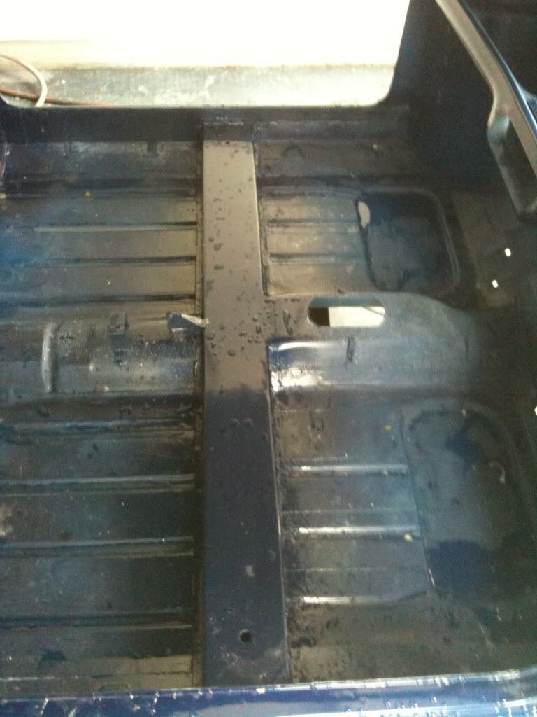

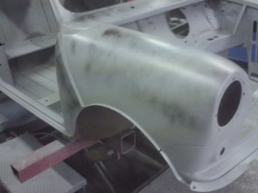

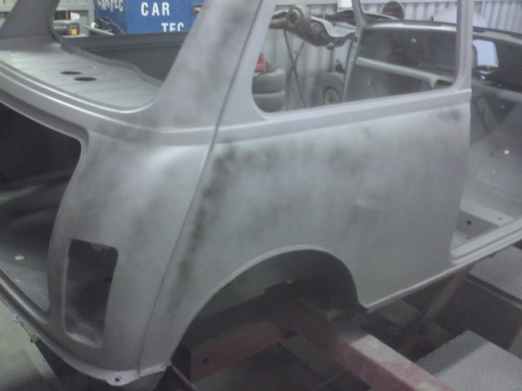

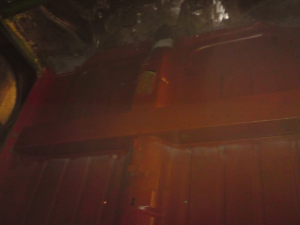

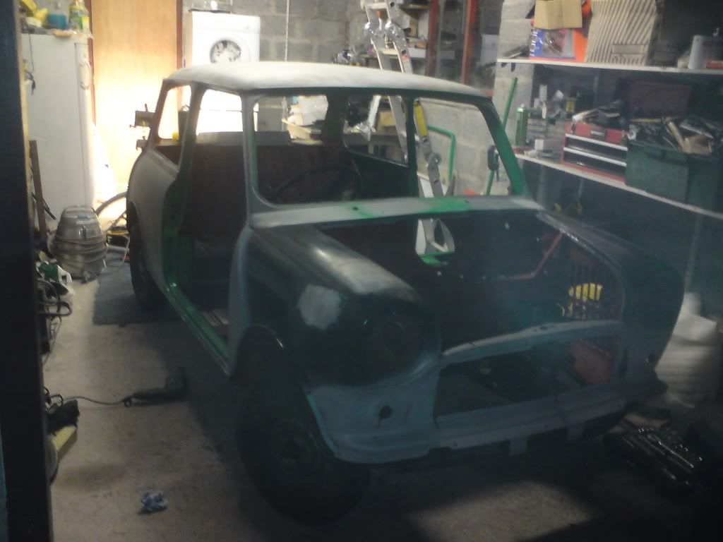

plans are going a bit tits up to be honest :( no way it will be done by the end of february and il be just doing the prep work on the inside and leaving the rest to a professional. started to refurb parts to get it to a rolling shell and the front hubs and radius arms where in worse condition than originally thought, im just re-doing the brake system basically and stripping it all apart to paint
all the bottom is stone chipped and undersealed now

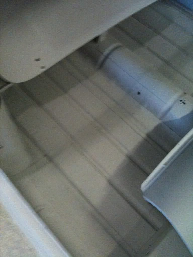

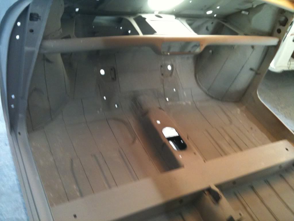

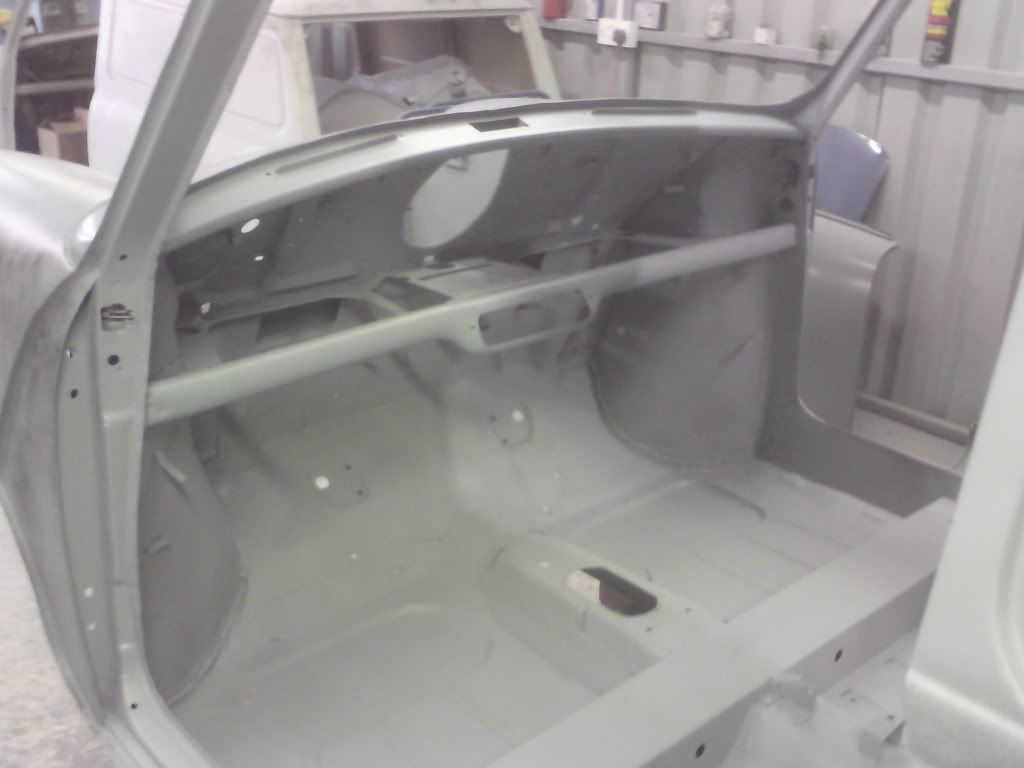

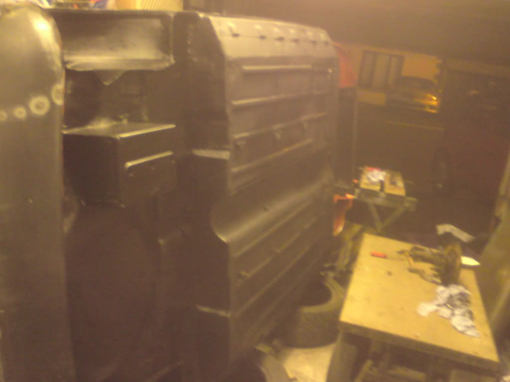

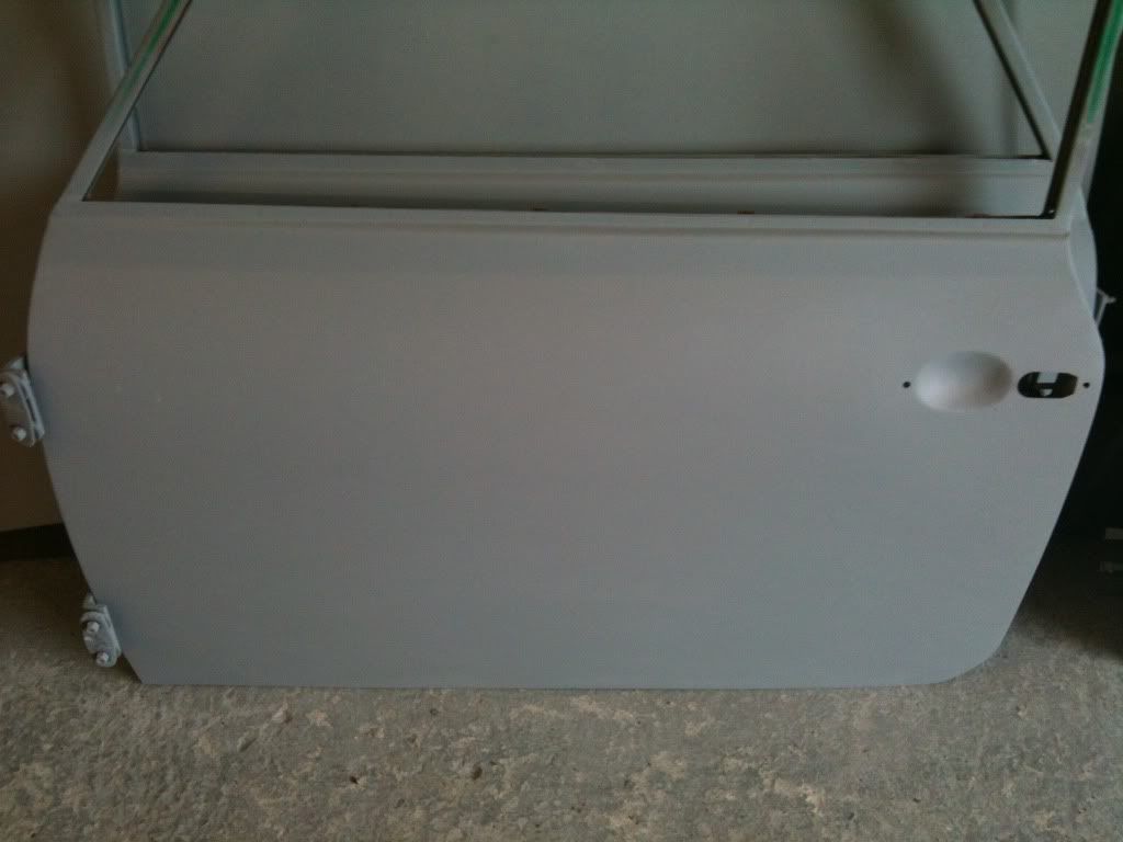

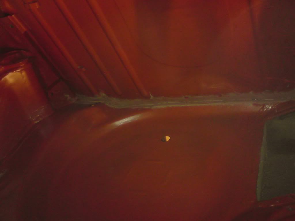

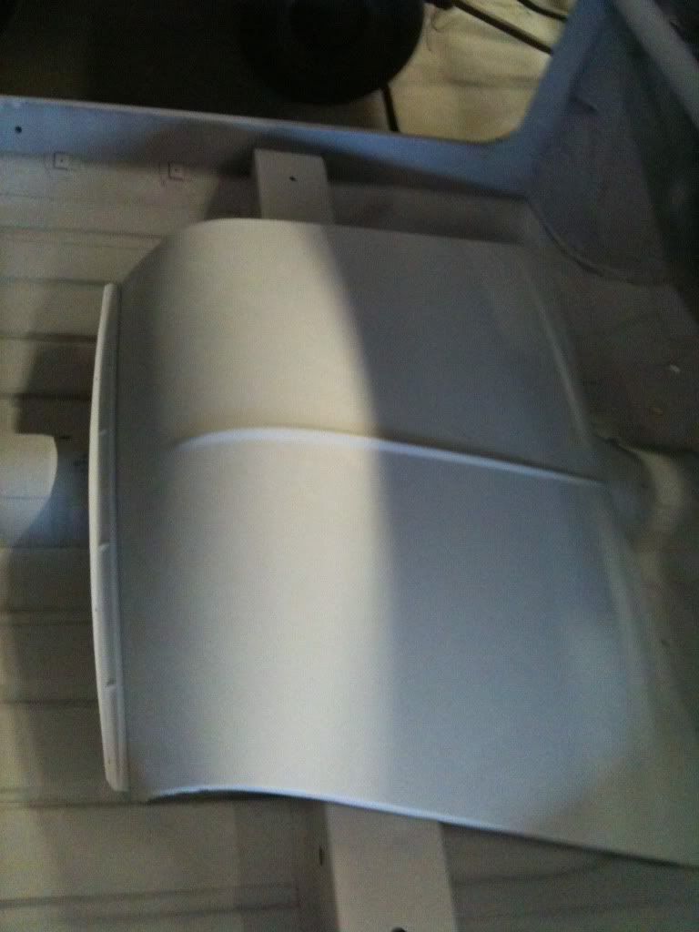

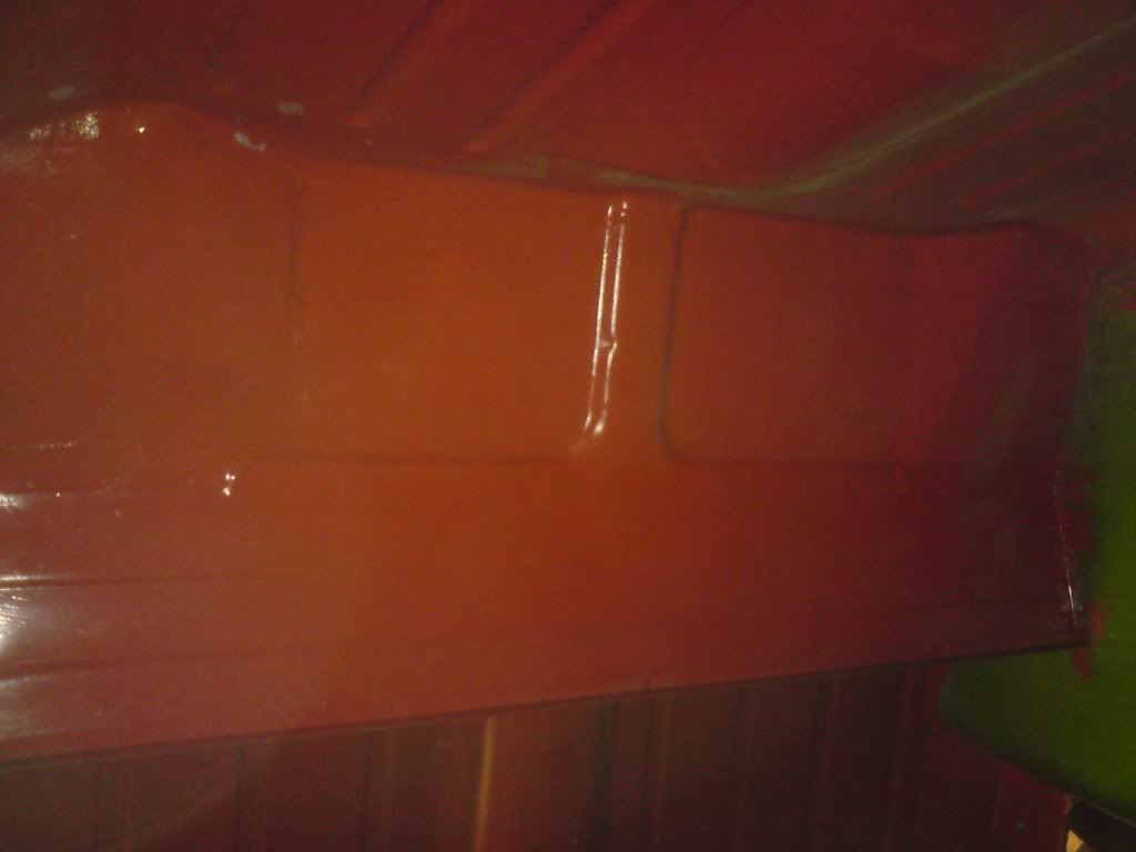

stripped back the inside and boot area back to bare metal, etched then red oxided so just need some high build primer and flat it back apart from a couple of wee areas needing a light skim of filler :)
started to re-furb this but im going to drop it in a bucket of petrol and de-grease it and fully clean it up before i re-build it
im goin to be ordering alot of new parts tomorrow so i can get the shell made into a rolling shell and then the work can really fly along or at least.. thats the theory anyway :-)

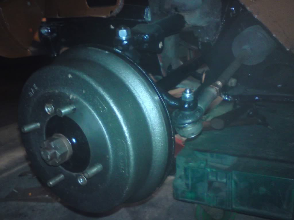

been busy with alot of tech work recently but ive managed to get a good wee bit done on the mini :-)

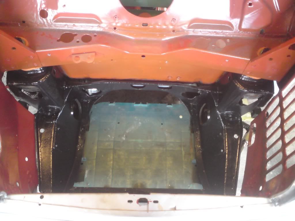

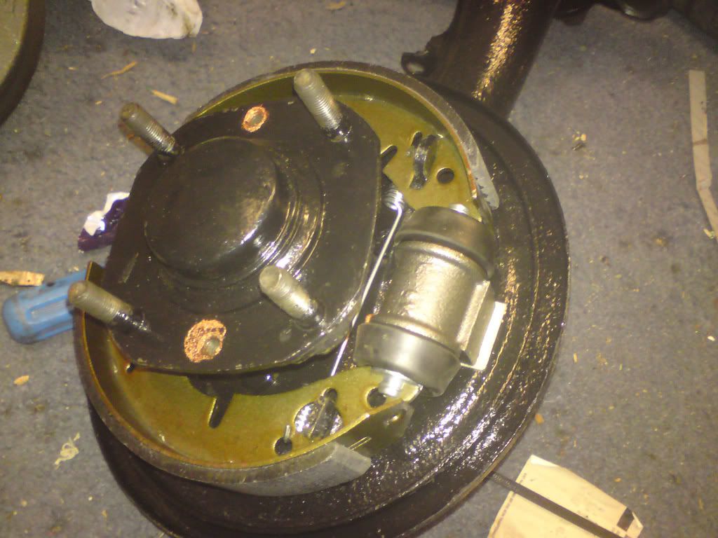

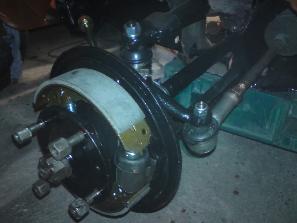

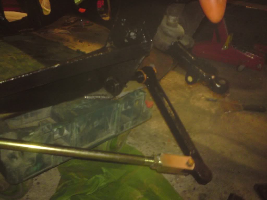

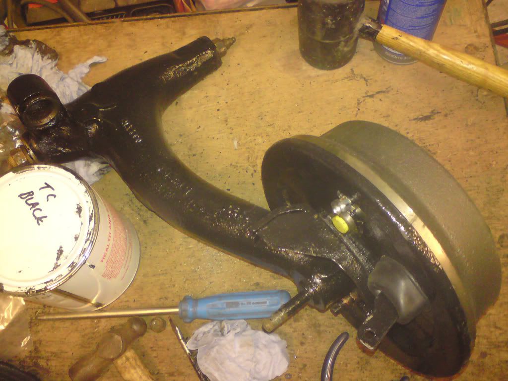

i completely stripped the radius arms of anything that could come of without having to take the backplate off etc, cleaned up and painted everything and replaced everything, cylinders, drums, pads and springs. although some parts were servicable i decided to just not take any risks and replace the lot

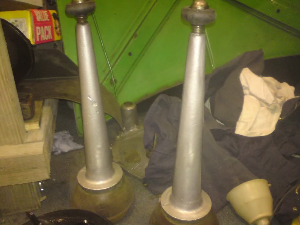

cleaned up the trumpets and gave them a spray to tidy them up a bit :-) replacing the cones and getting hi-lo's is on the list of future things to do but just no money to do it haha

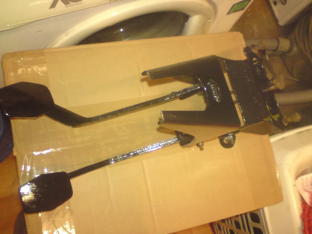

the pedals looked a bit tired so i gave them a wire brush and painted them in black and i found out the brake light switch was broken so now i know why they didnt work when i got the car :-)

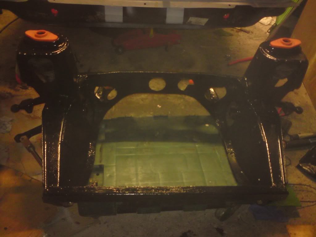

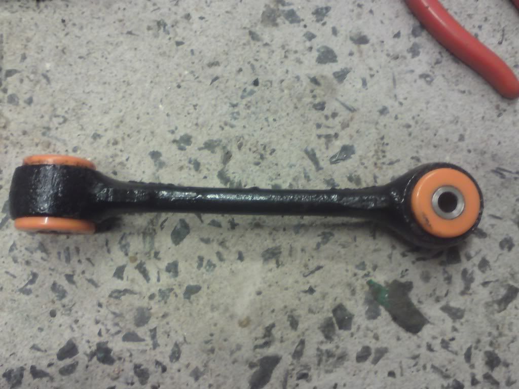

last time i test fitted the rear subframe i didnt have the big polyurethane bushes at the front and i used the old rubber ones, at the time it fitted perfectly and i assumed it would be the same with new bushes, theory didnt work, i put all the new bushes on and the fitted all the components to the rear subframe and when i tried to fit it, it wouldnt fit
spent ages trying to find the culprit, had to take apart the rear subframe again and make some very slight modifications to the steel mounts to get it to fit since polyurethane obviously doesnt compress and mould in the same way as rubber
finally got it on and the old wheels fitted :-) 2 and a bit days it took to work everything out in it haha
currently re-building the front hubs and then it will be into a full rolling shell for the 1st time in nearly 2years, just realising that O_O need to really get a move on now haha
all comments welcome, Adam :-)

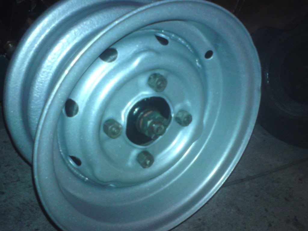

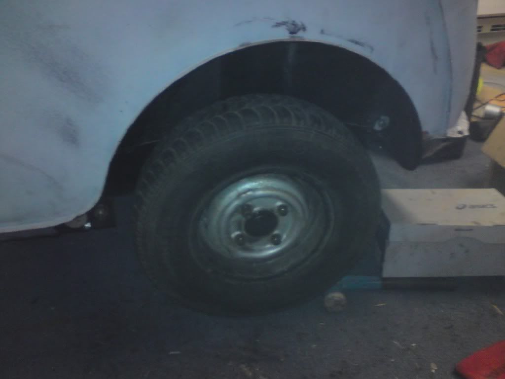

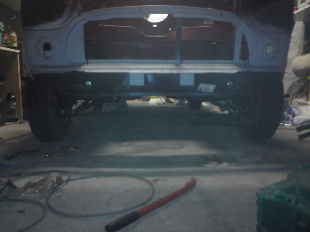

alrighty then :-) really got some good work done now and its a full rolling shell :D

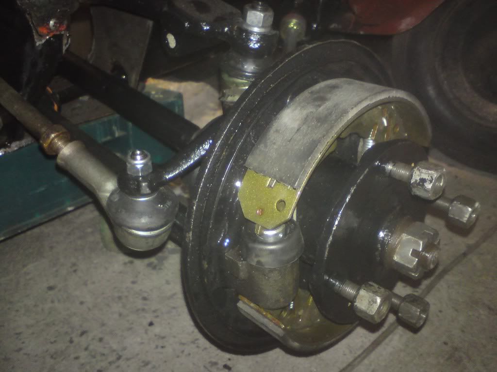

gave the front subframe another lick of paint along with the bottom arms and stuff and got it fitted into the mini awaiting the hubs
did a full refurb of the hubs. new bearings, gaitors, brake cylinders, brake pads, drums and ball joints so everything should work perfectly when its finished :-) and of course fitted them
couldnt resist fitting the wheels that will go on at the end just for the crack :-)
need to get it re-sprayed now and get some things bolted back in so its not sitting as high :P

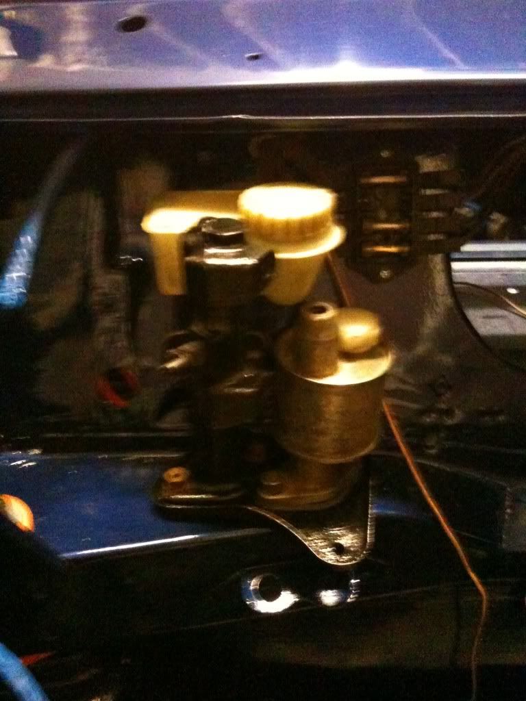

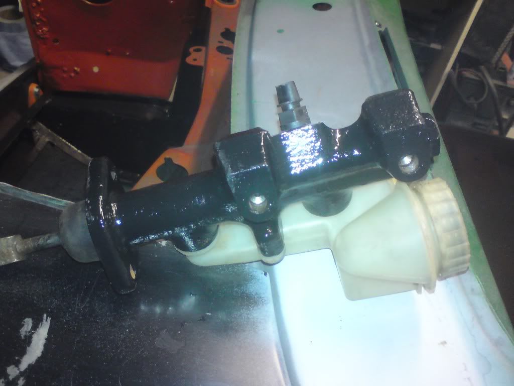

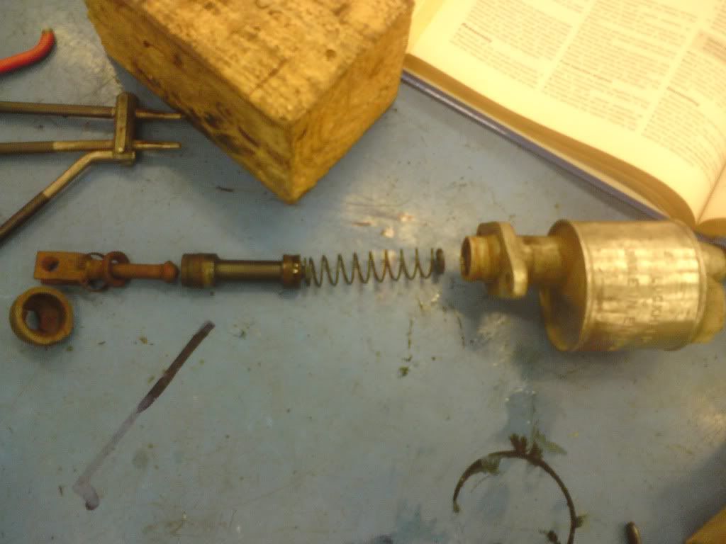

also got a couple of other small things done while i was just bored. re-wrapped the wiring loom in blue tape, im still not sure on it but aww well and i also took the brake master cylinder apart a wee bit and painted it so it looks respectable instead of a rusty mess :-)

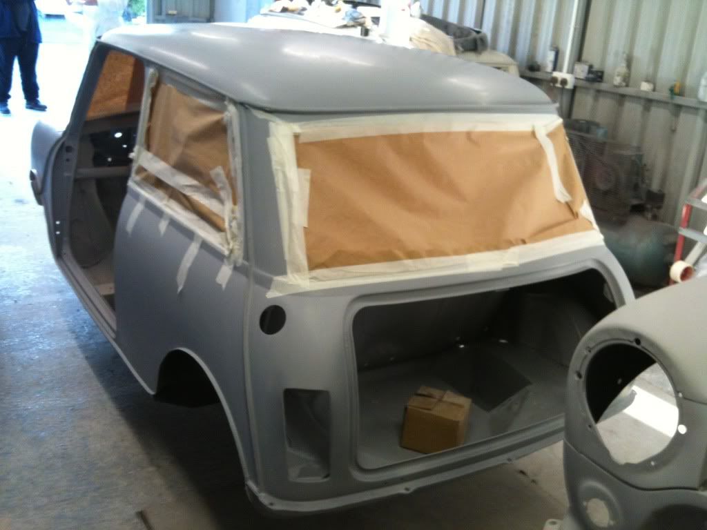

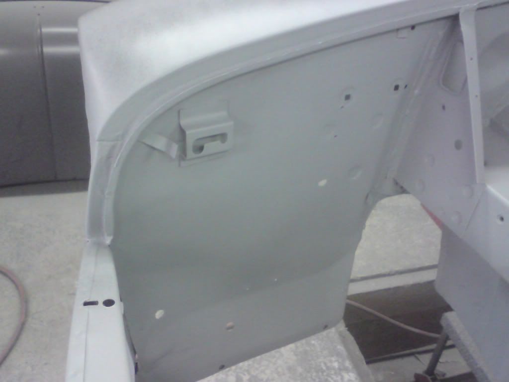

Posted 21 March 2012 - 12:41 AM

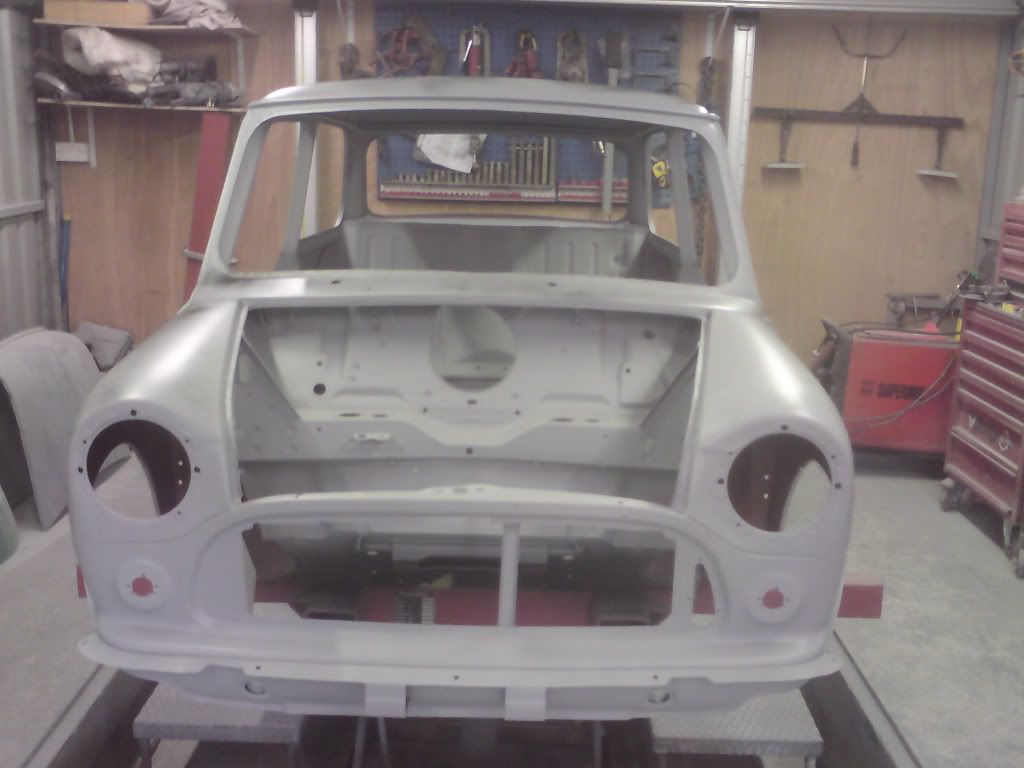

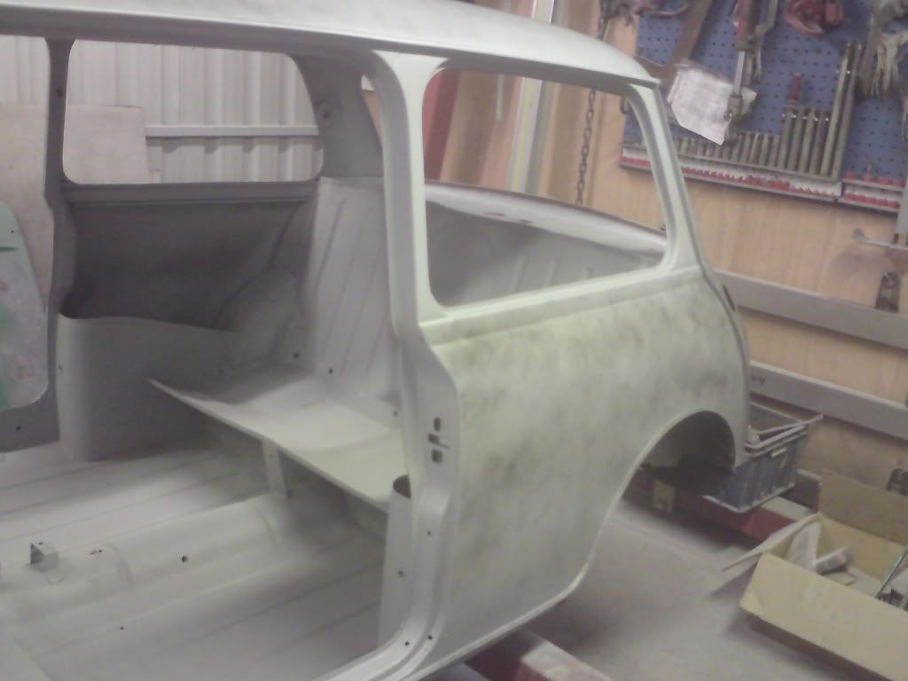

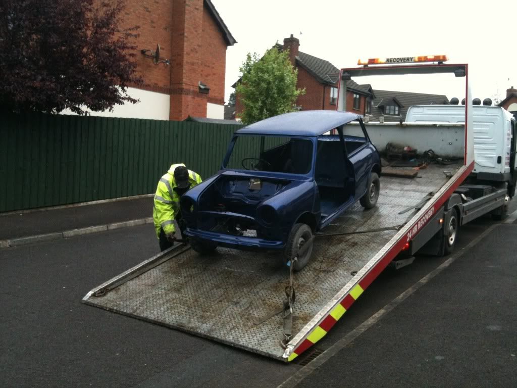

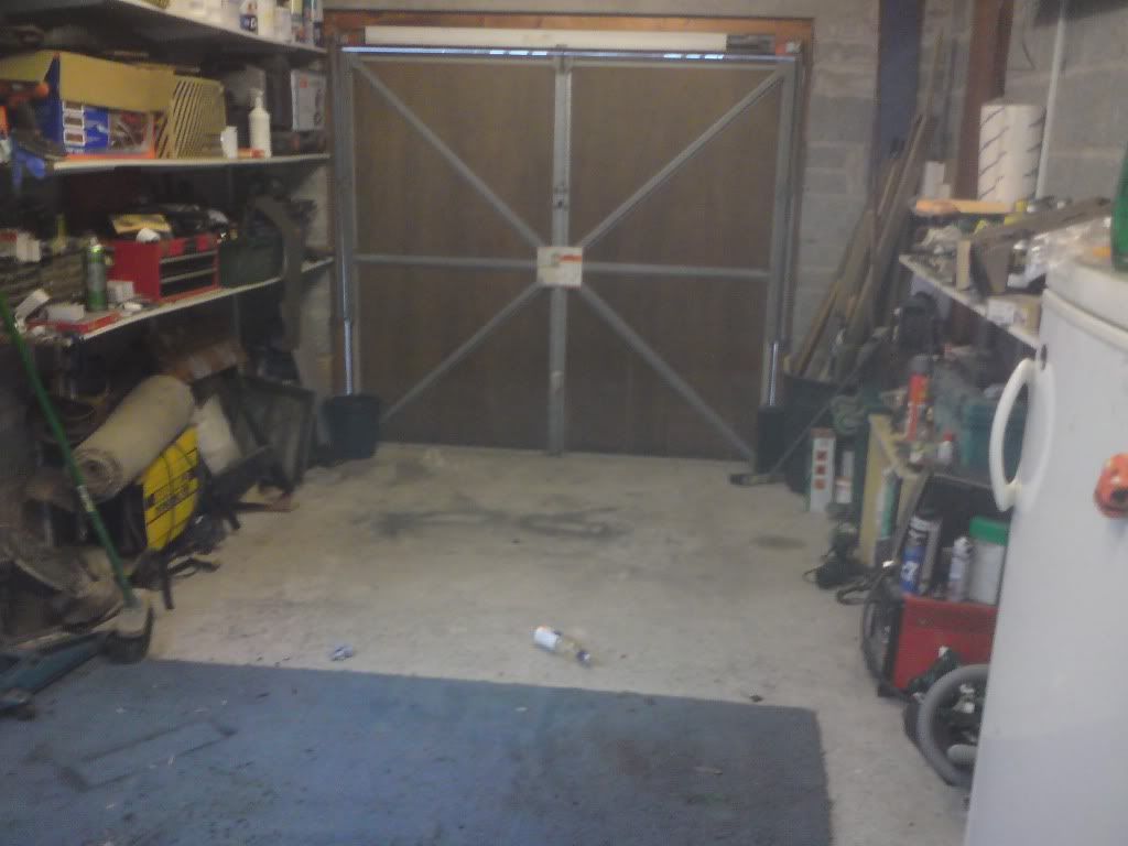

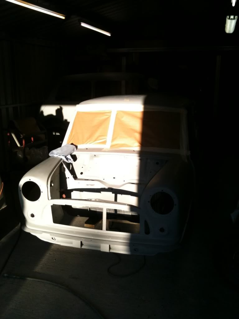

REGGIE HAS GONE FOR RESPRAY :D
was picked up this more to go for final work, prep and respray

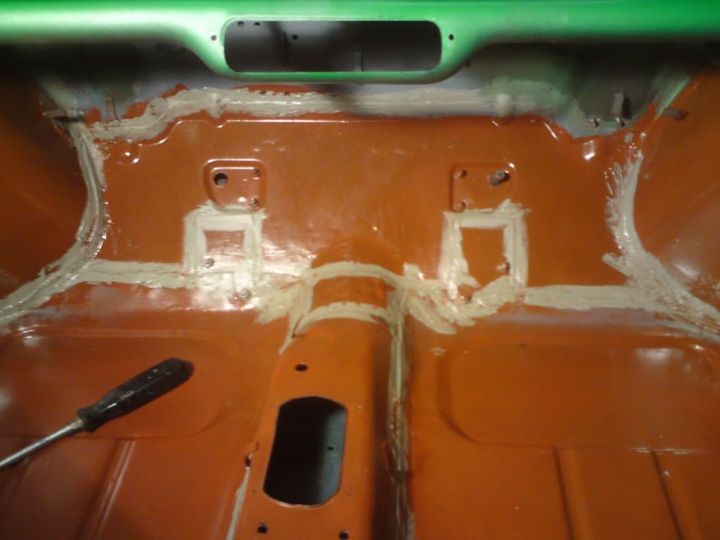

seam sealed everything on the inside 1st though
then started loading everything and getting a few things ready
the garage feels so big and empty now :-(

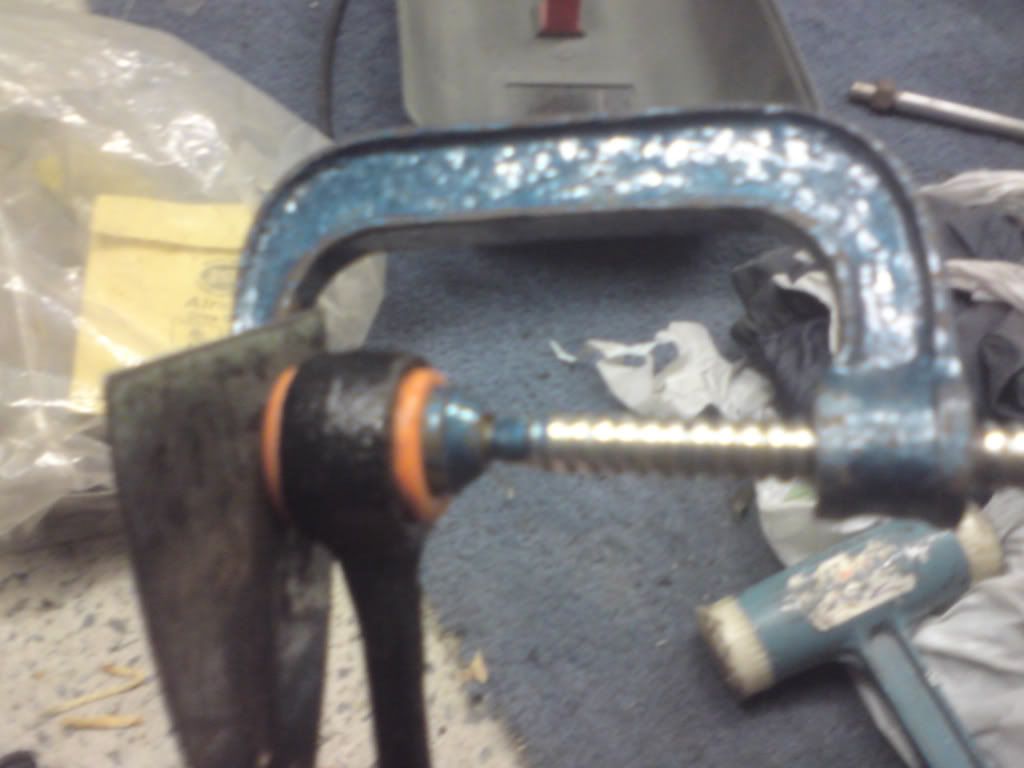

the strip down and clean was started and then i got distracted cus i decided to fit the bushes into the top engine steady, spent a while figuring it out and i came up with a solution since i dont have a press or a vice :-)
G-clamp with something flat on 1 side to stop it falling through, i used a paint scraper and then simply wind it in and press the sides in with a screwdriver and continue tightening until it reaches the other side and then place it on something flat and whack it with a mallet to force the rest through and same applys for the crush tube but put some wd40 on it 1st :-)

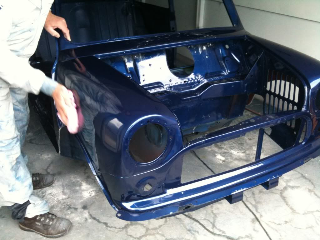

Posted 30 March 2012 - 11:50 PM
hows it going everyone? :-) mates 18th and im on a ship sailed off the earth right now with work at 8 in the morn >_< it shall be very fun indeed :lol:

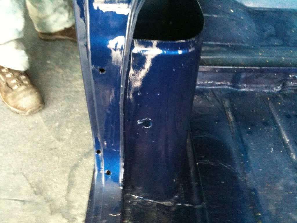

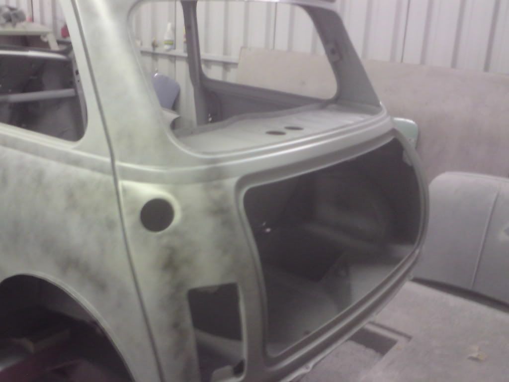

hopefully the right update thing but i went and saw reggie at the sprayers and he looks great so far :)
got the guy to weld up all the holes that provide fresh air to cut out some rust traps hopefully :-) mabye done in the next couple weeks but we will see how things go, he is picking up the new bonnet and seam strips tomorrow at some point but chances are il be down the pub again for another mates 18th :-)
if i dont post again ive died of alcholhol poisoning, good night and have a good day :D

Posted 03 May 2012 - 06:15 PM

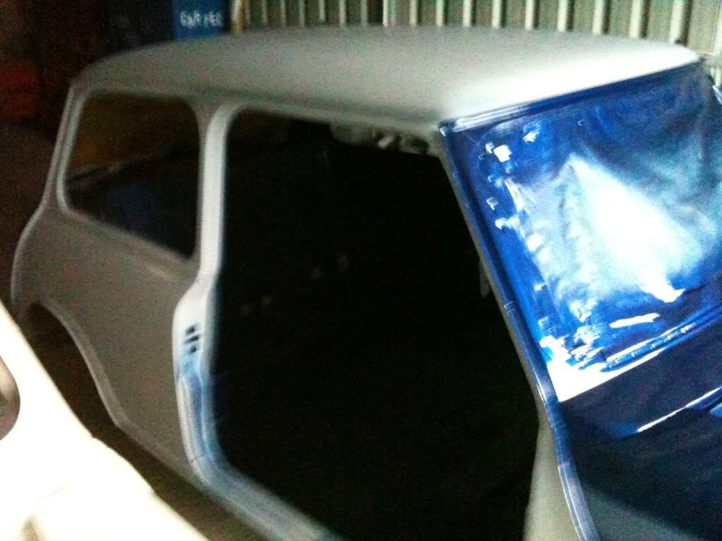

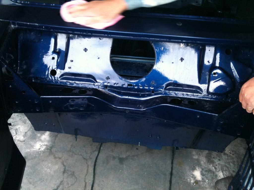

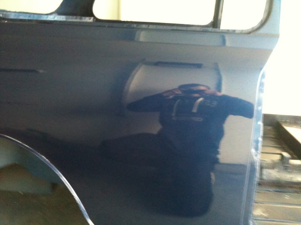

i didnt die, just forgot to update this >_<

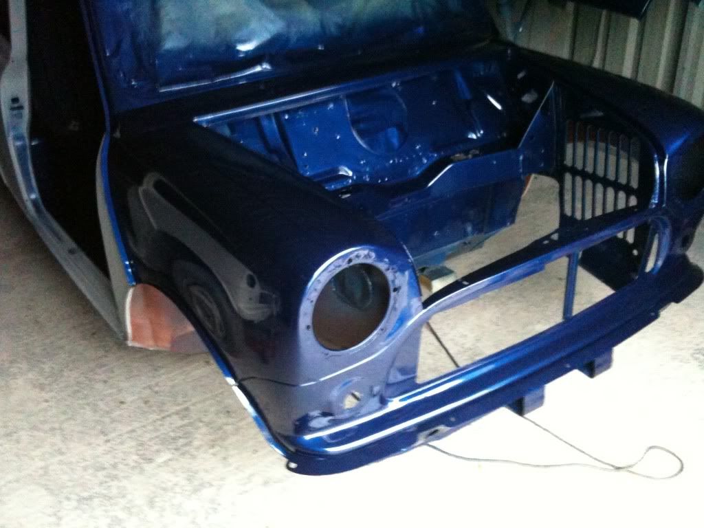

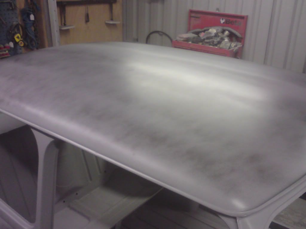

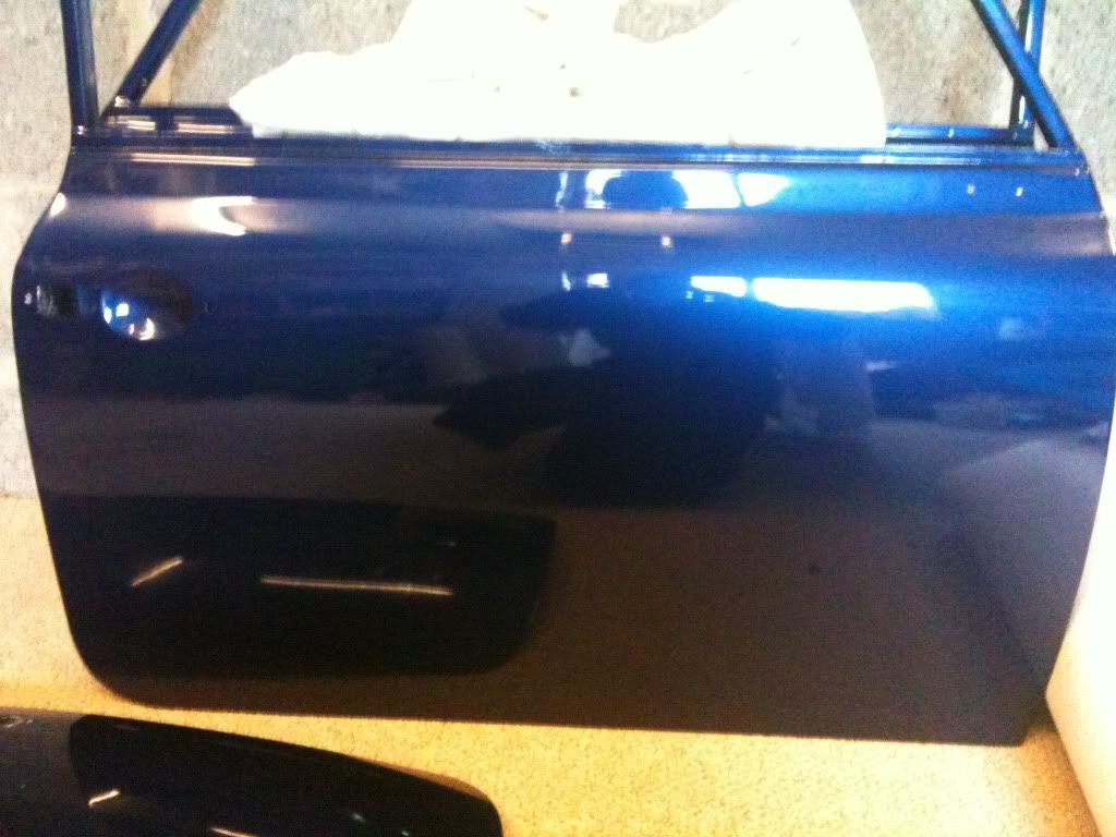

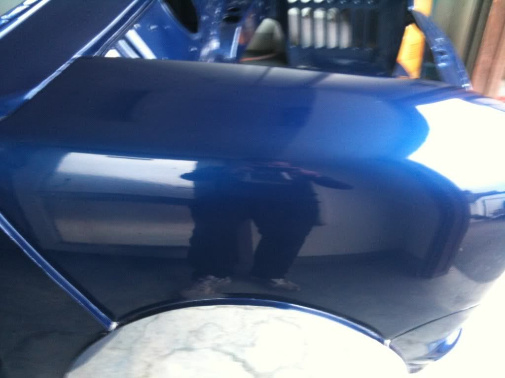

lots has been done now so il just let the pics describe everything :D

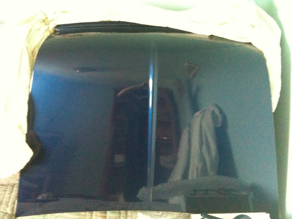

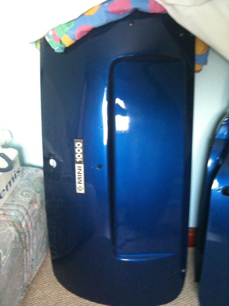

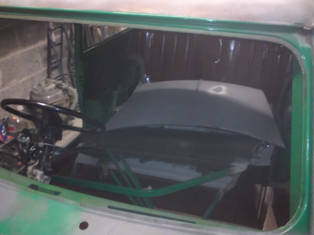

the shell is fully sprayed now and the rest of the shell should be coming home soon :-) the engine has started to be rebuilt, having some problems with clutch though but i dont know what :lol:
thats it for now :)

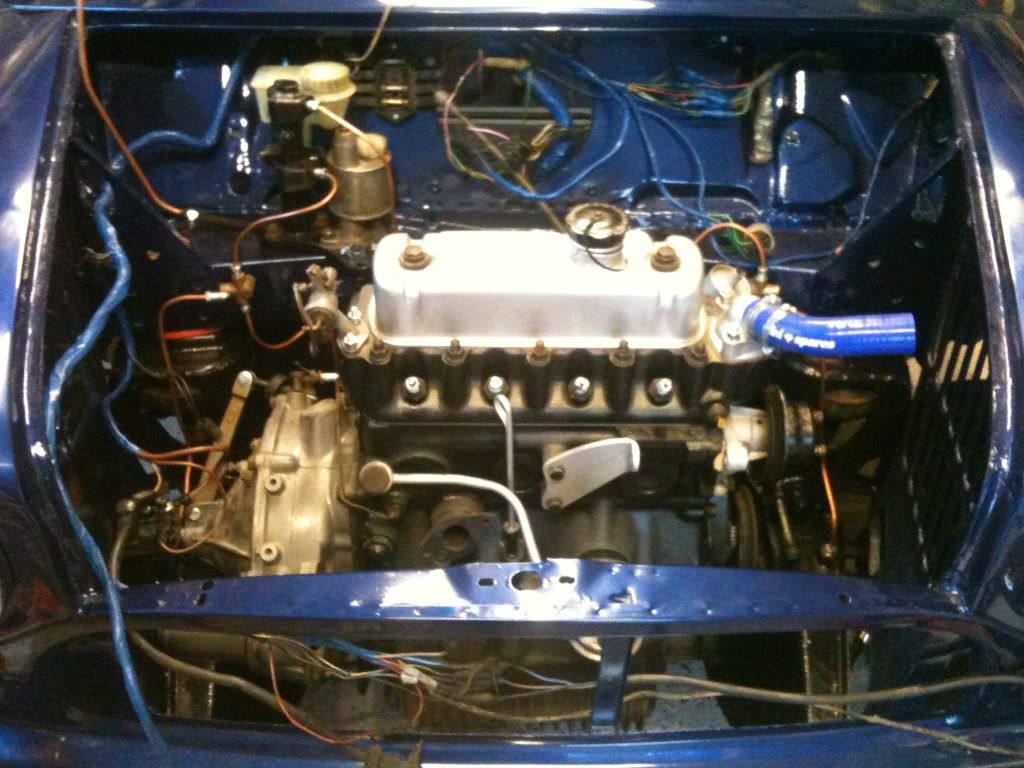

Posted 17 July 2012 - 09:02 PM

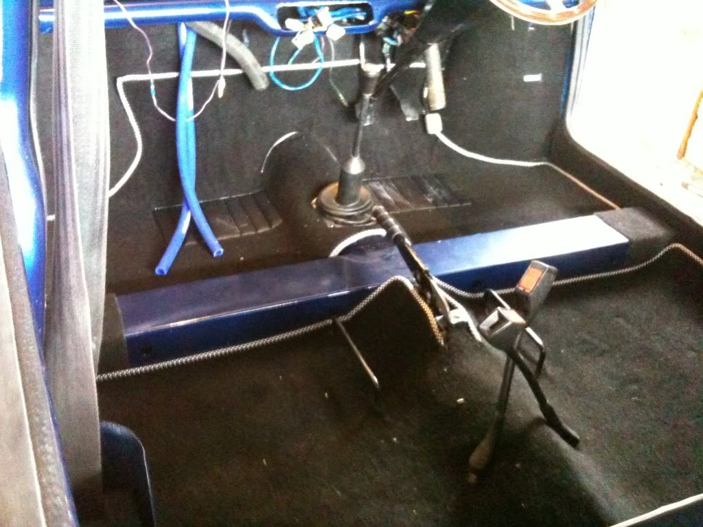

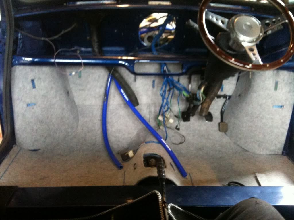

long time and no update, havent had time for ages :lol: had to finish tech before i could get stuck in rebuilding but heres what ive managed to get done so far:

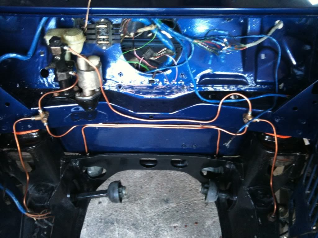

wiring loom, pedal box, and brake and clutch master cylinders fitted
made up all the brake pipes and the fuel pipe and fitted them

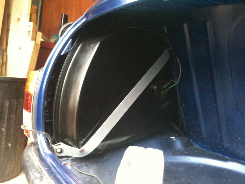

fuel tank fitted, made the stupid mistake of forgetting to fit the rear shock absorbers first so i had to take it back out lol

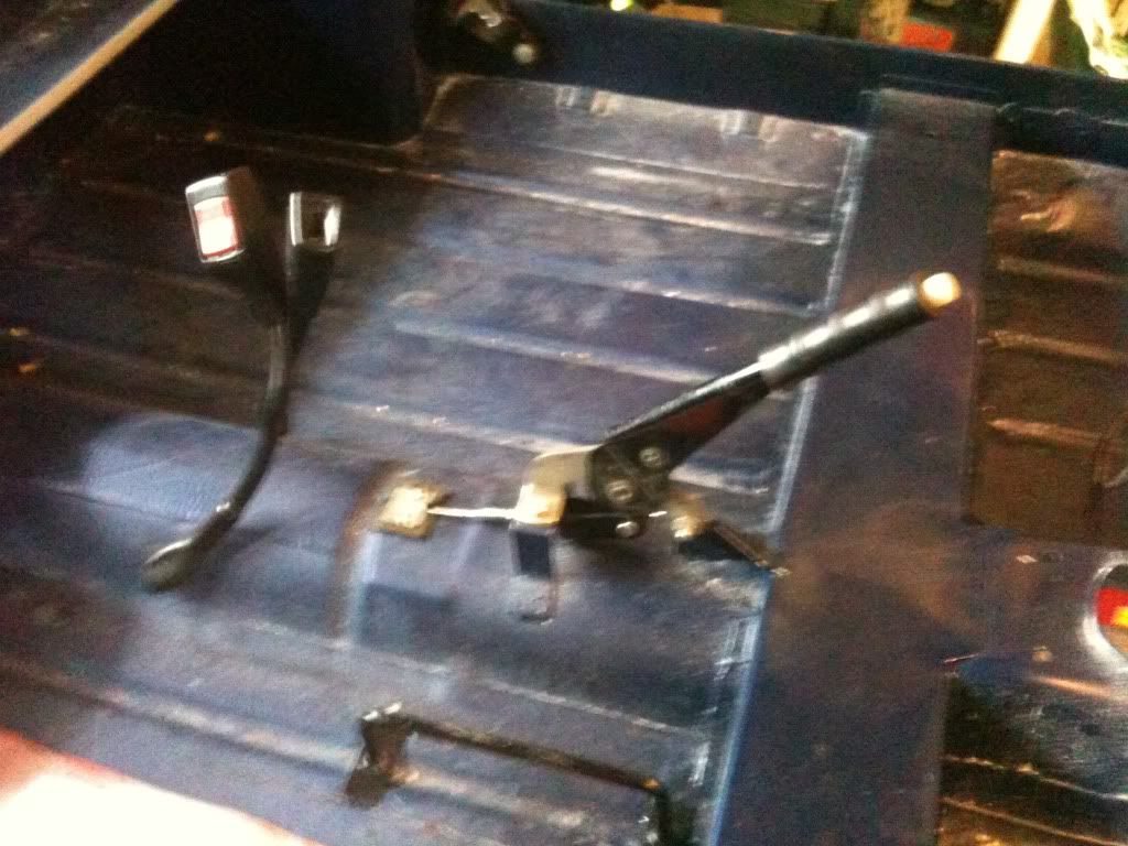

also fitted the handbrake and a complete new handbrake cable

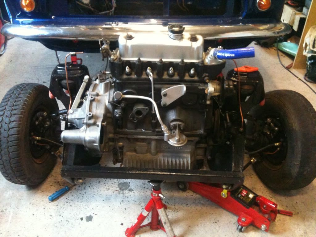

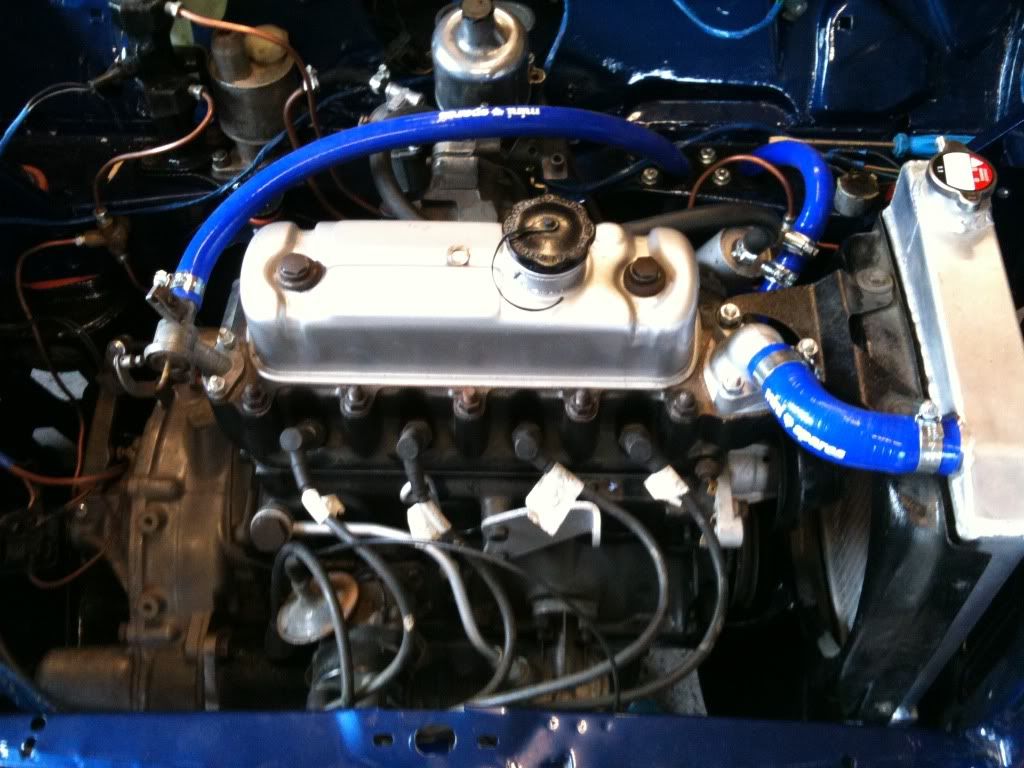

i fitted the new clutch to the engine and a couple of mates helped me to lift it onto the front subframe and lift the body over and onto the subframe. fitted some of the electrics and fitted the plumbing in and again been very stupid and forgot the fan so the radiator had to come out again and the fan fitted

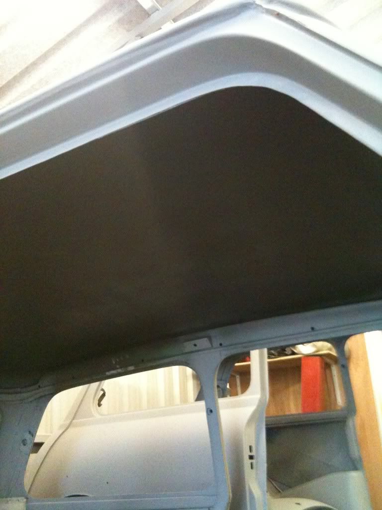

fitted a nice new chrome aerial and because ive put that on i can get the headlining fitted soon

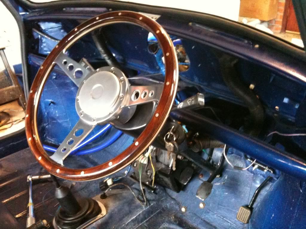

got some wiper stalks of a mate and put the on my steering column and fitted it with my nice new steering wheel :-)
i figured at this point would be best to fit the carpets before the heater box etc so i spent a good few hours cutting and trimming the carpets and underlay to fit and im very happy with how it turned out :D
i forgot to say i had also fitted the gear linkage and luckily i think i have all the gears
next plan is to adjust the tappets and fit whats left of the engines electrics and hope it starts :-) also need to get a clutch pipe and hope the clutch works, i followed the haynes exactly so il see how it goes lol
also got the brakes bled and working after fixing a couple of small leaks
