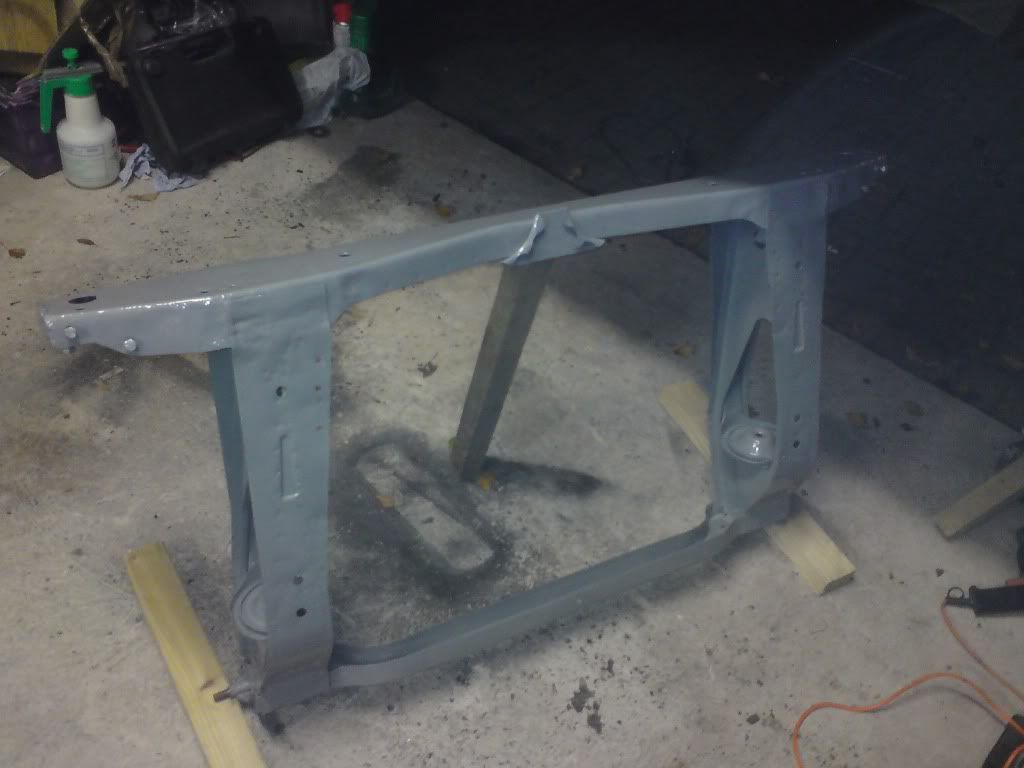

the rear subframe has now been painted with por15 which really is brilliant stuff :)

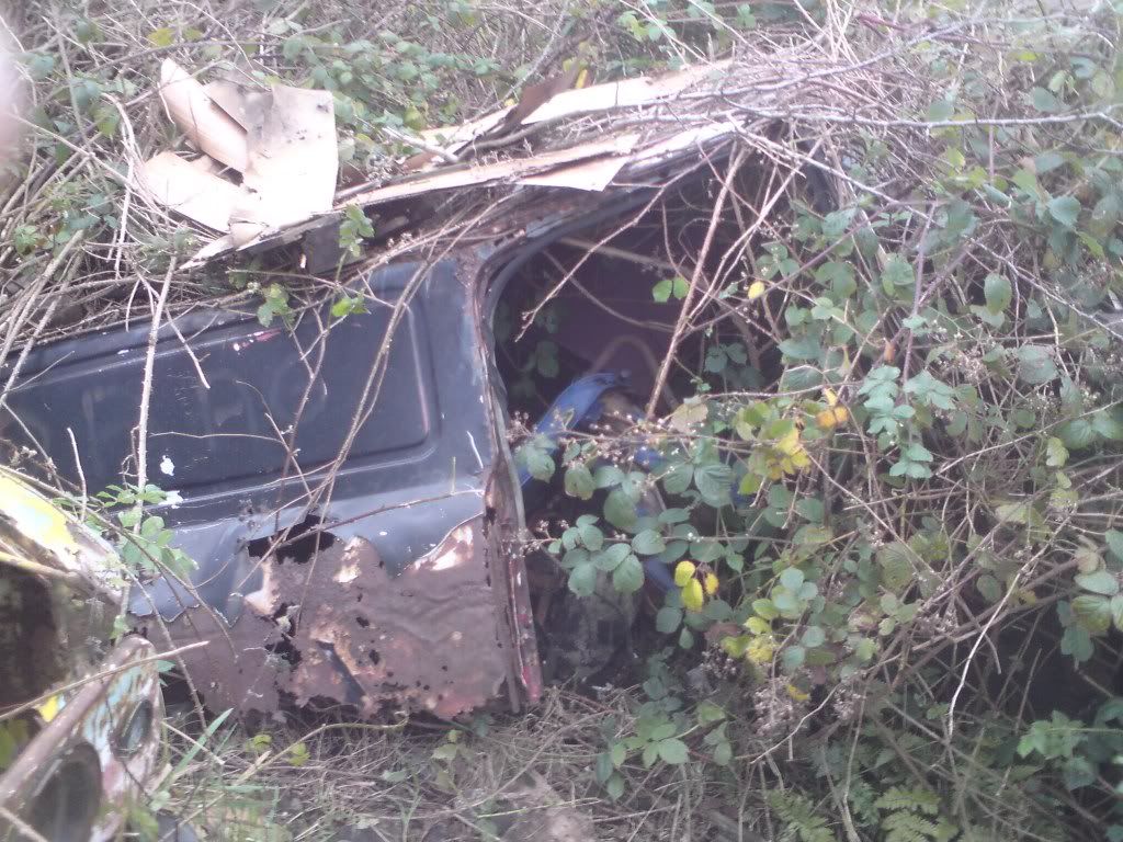

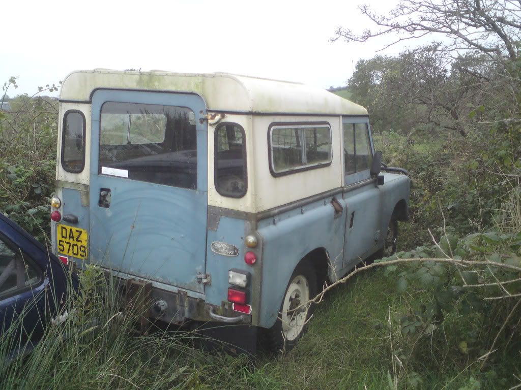

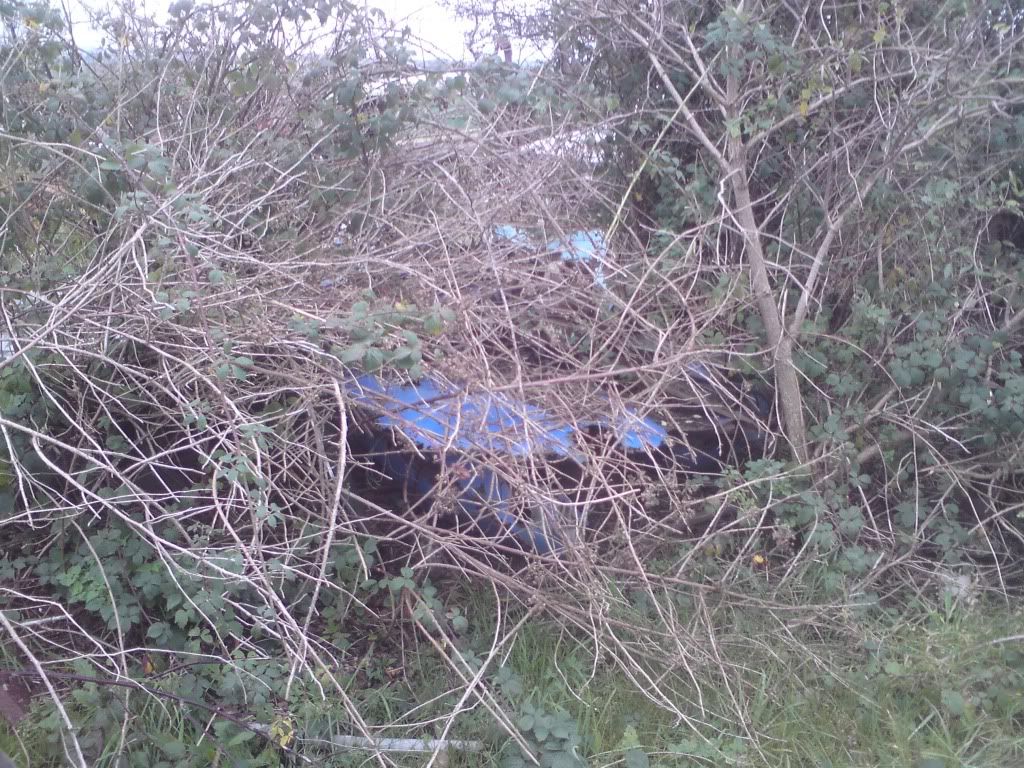

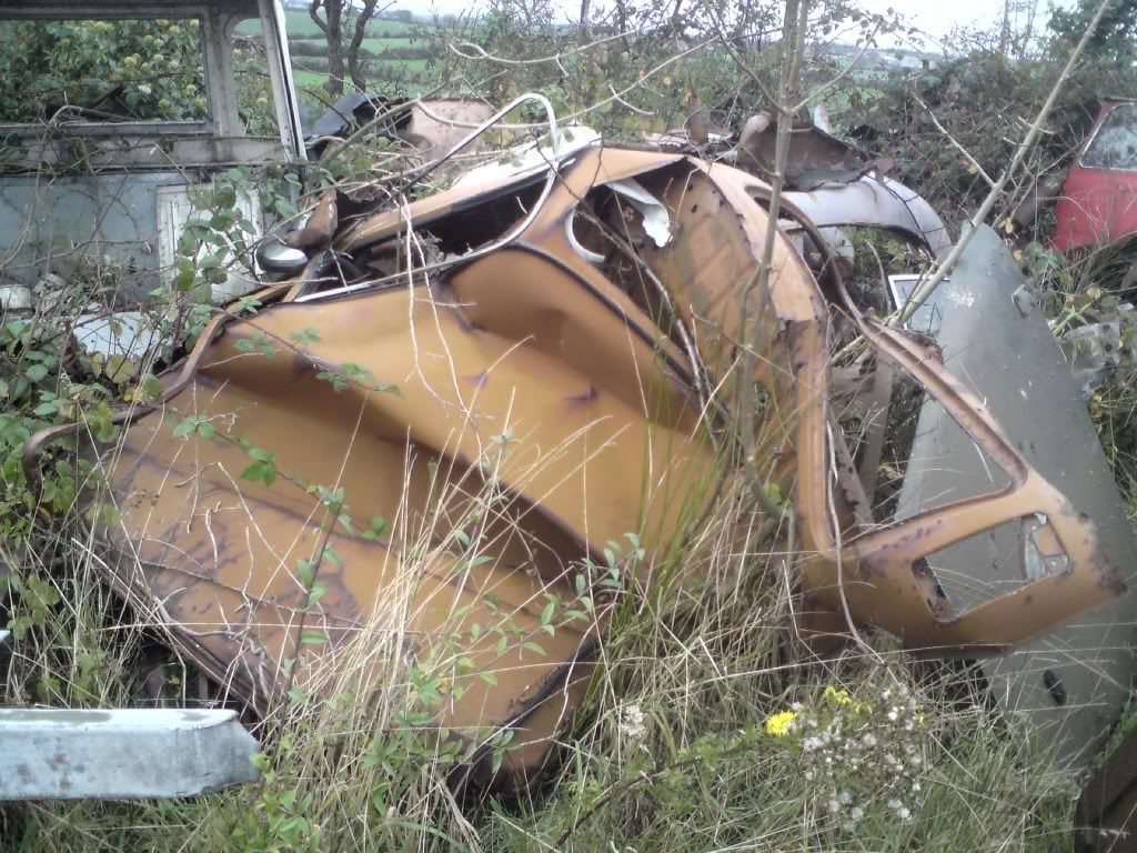

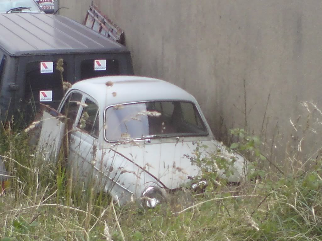

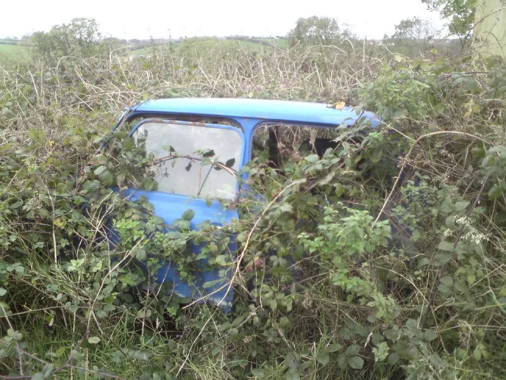

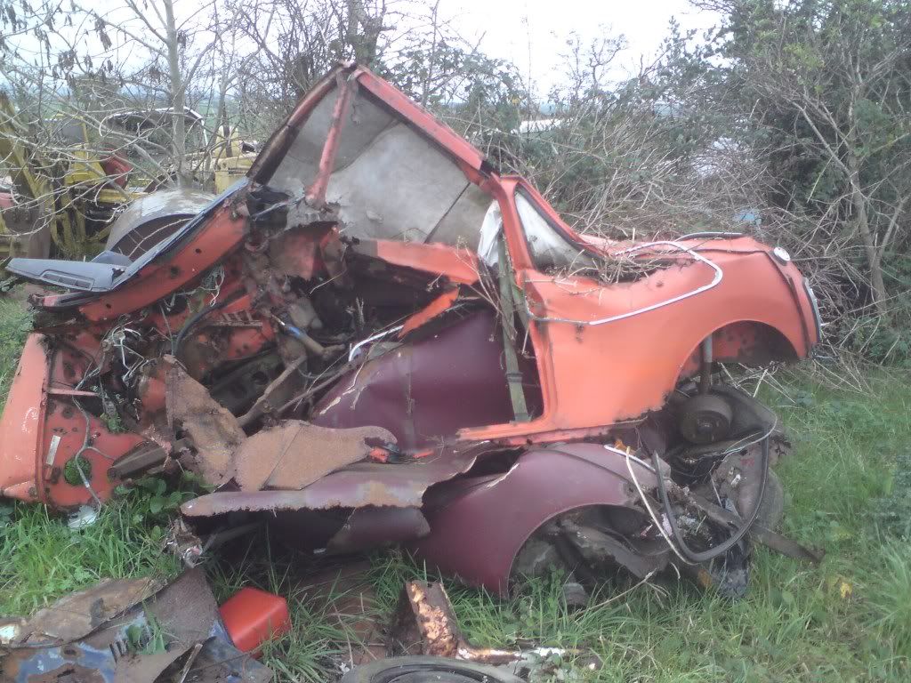

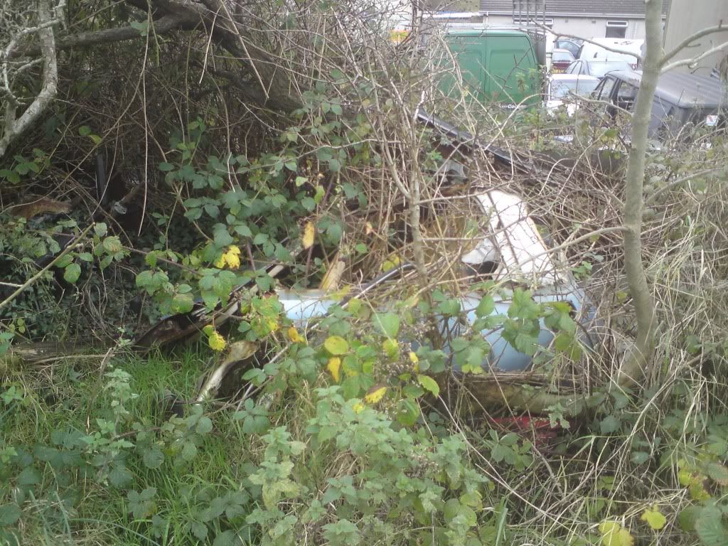

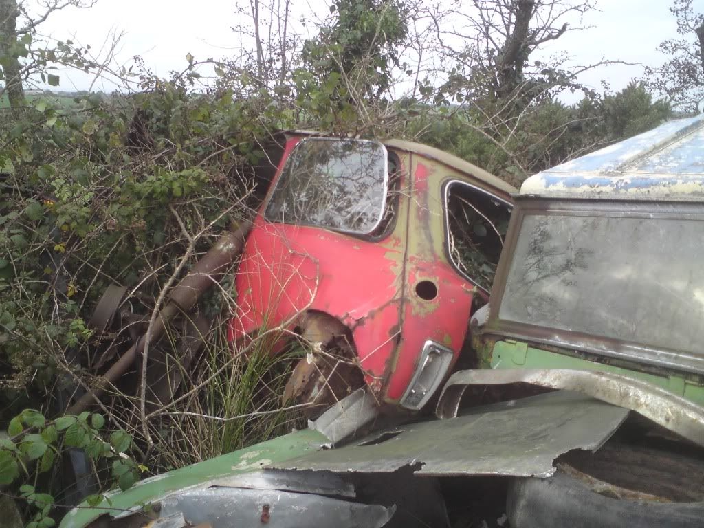

and now for the depressing bit, i went with my neighbour up to a farm which has loads of cars, my neighbour had said that he knew there was a few minis there and 1 may have been good enough for a project for my dad, i wasnt expecting what i saw :(
this is just a few of the minis there, he has just stripped most of them for parts and took a digger to them, there are many other cars there such as a very old mini bus and old tractors etc. the blue mini has a surprisingly good blue vinyl interior so i might go back and offer to buy it off him

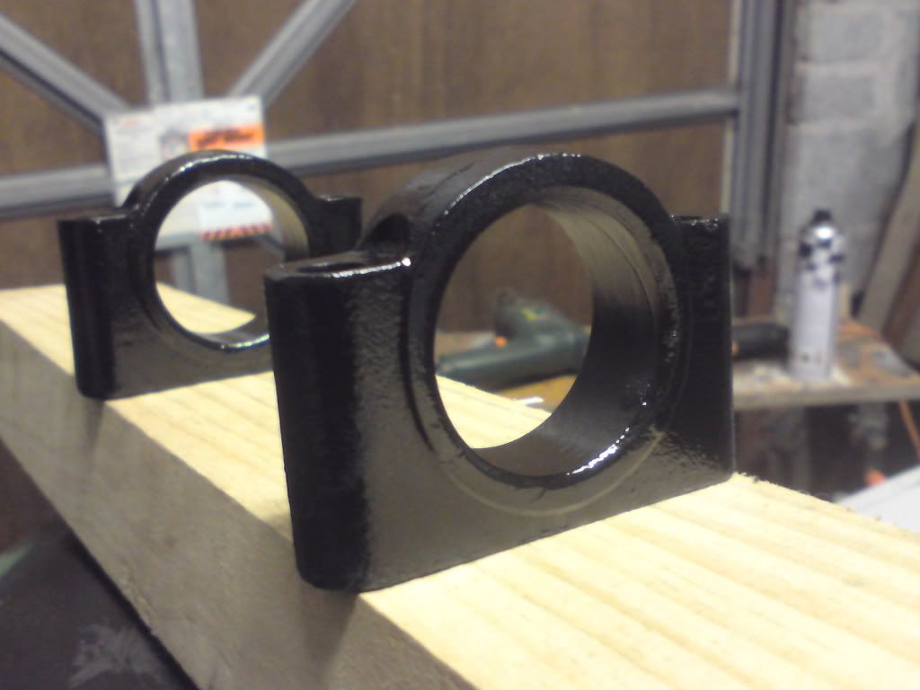

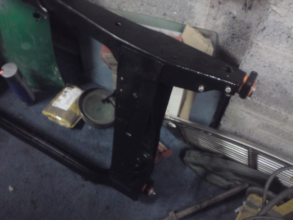

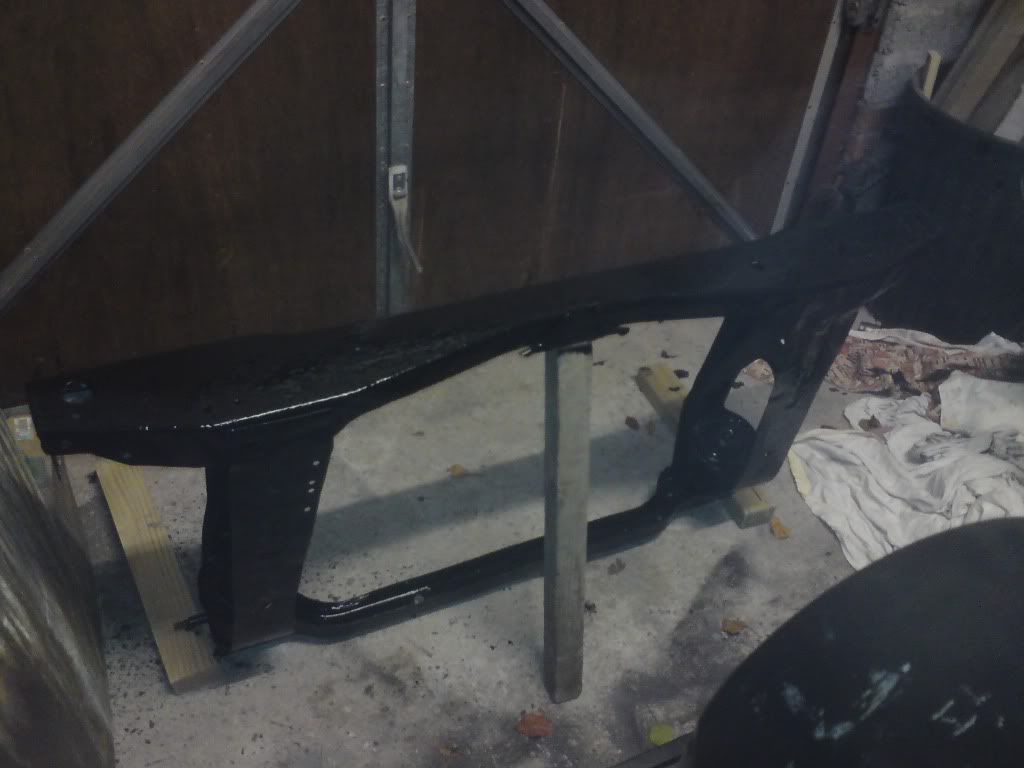

cleaned up the rear subframe mounts then etched, stone-chipped and then just poundland black spray over it and then a few things bolted to the subframe and all bolts copper greased so theres no problems in the future :) and now its out the way in the shed waiting for the soon to be re-furbished radius arms

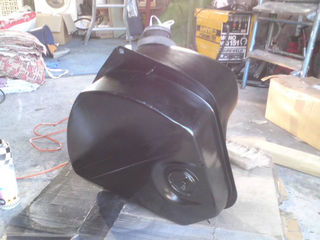

re-painted the petrol tank, its alot better finish than in the picture but its done and in the roofspace now out the way :)

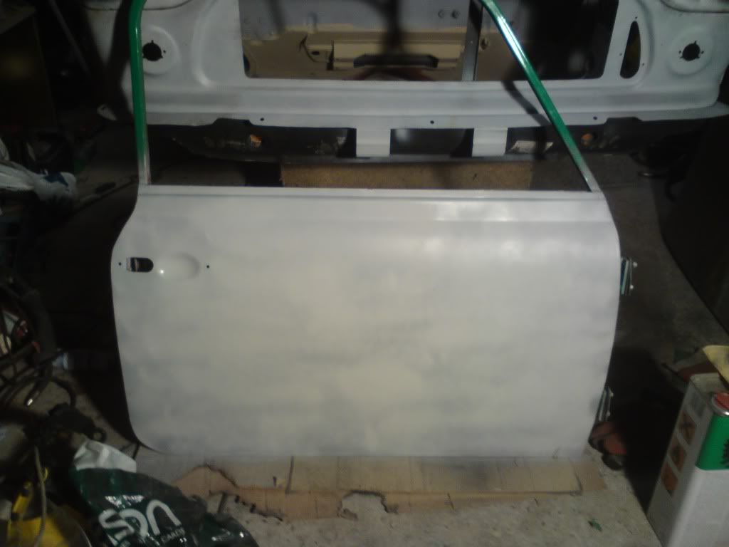

took the drivers door to bare metal and etch primed it so it will be ready for paint prep with everything else

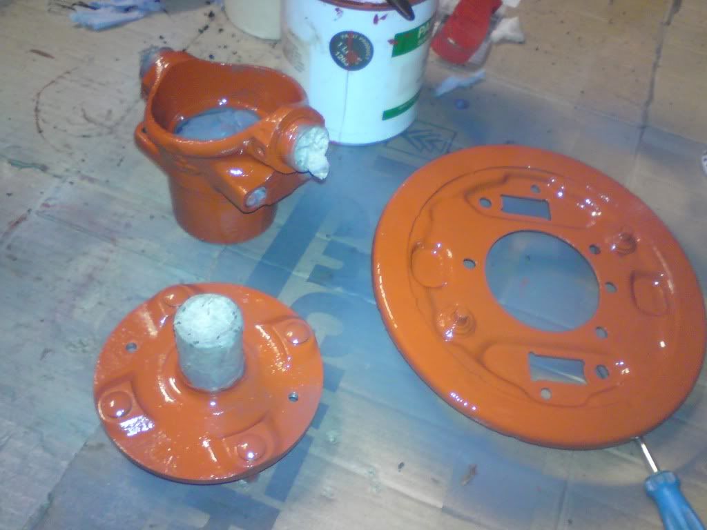

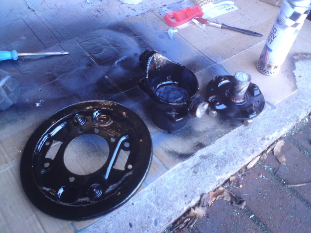

both front hubs have been stripped apart waiting for new bearings, ball joints, brake cylinders and brake shoes and gaitors so i know everything will pass MOT no problem, parts are just being bare metaled, etched, red oxide and then poundland black again cus its just quite good paint :)

you shop a lot in poundland????,.........carefull no petrol near it!!!! all paint will desolve and run of, I am sure you can buy decent metal spray paint somewhere in the Ards area,.......might cost a few pounds more but woth it in the end, but you subby lookws ace never the less, nice those trunnions!

finished painting those wee bits up so they have been set aside waiting for the other bits to be finished so it can be put back together

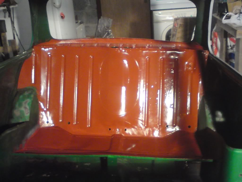

rear valance and closing panels are all finished now :)

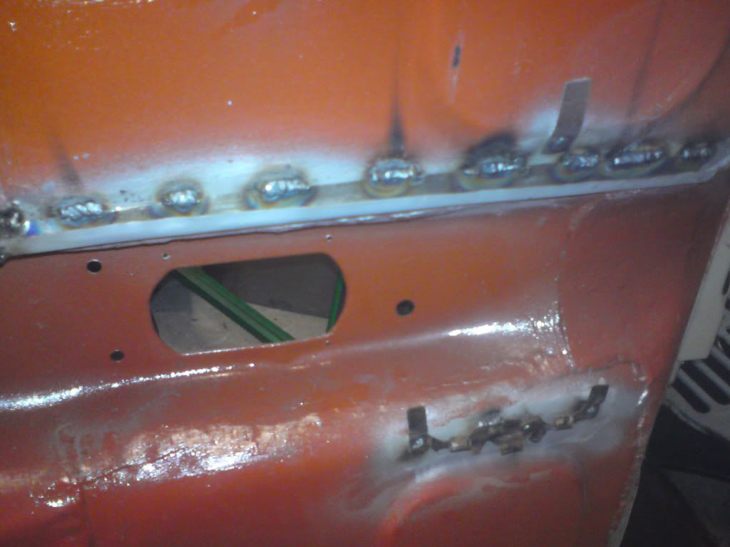

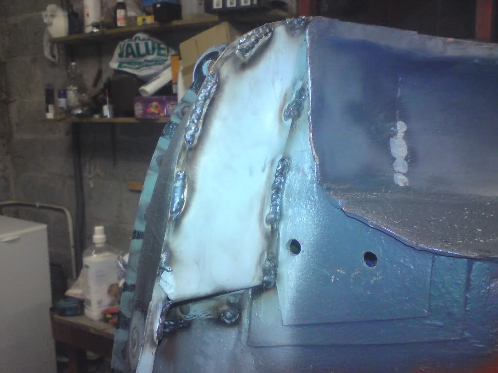

made up a couple of brackets to finish the welding underside

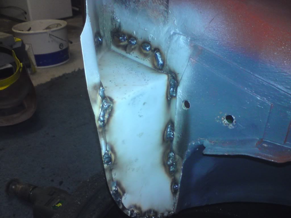

also spent a day grinding down many welds so i have only got a few pin holes to fill in and then thats the main shell finished welding, just a few drilled holes to fill in in the boot lid and a small patch to the bonnet and the support bar thing for the bonnet :)

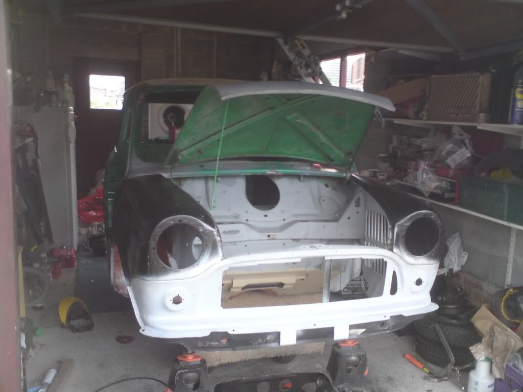

i found a new problem that im not to sure how to fix, i bought a riley elf dash and was planning to just have it re-laminated, problem being is that british leyland didnt make my shell very well, the gap from the bottom dash rail to the top is at least 15mm smaller at the left hand side than the right so it doesnt fit at all so i may just make my own custom dash, what do people reckon?
comments welcome, Adam

heres a little bit of an update :) ive basically just been stripping away old paint, etching and then a coat of red oxide

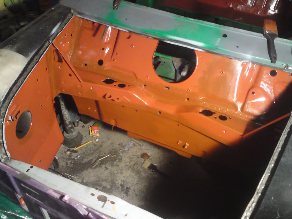

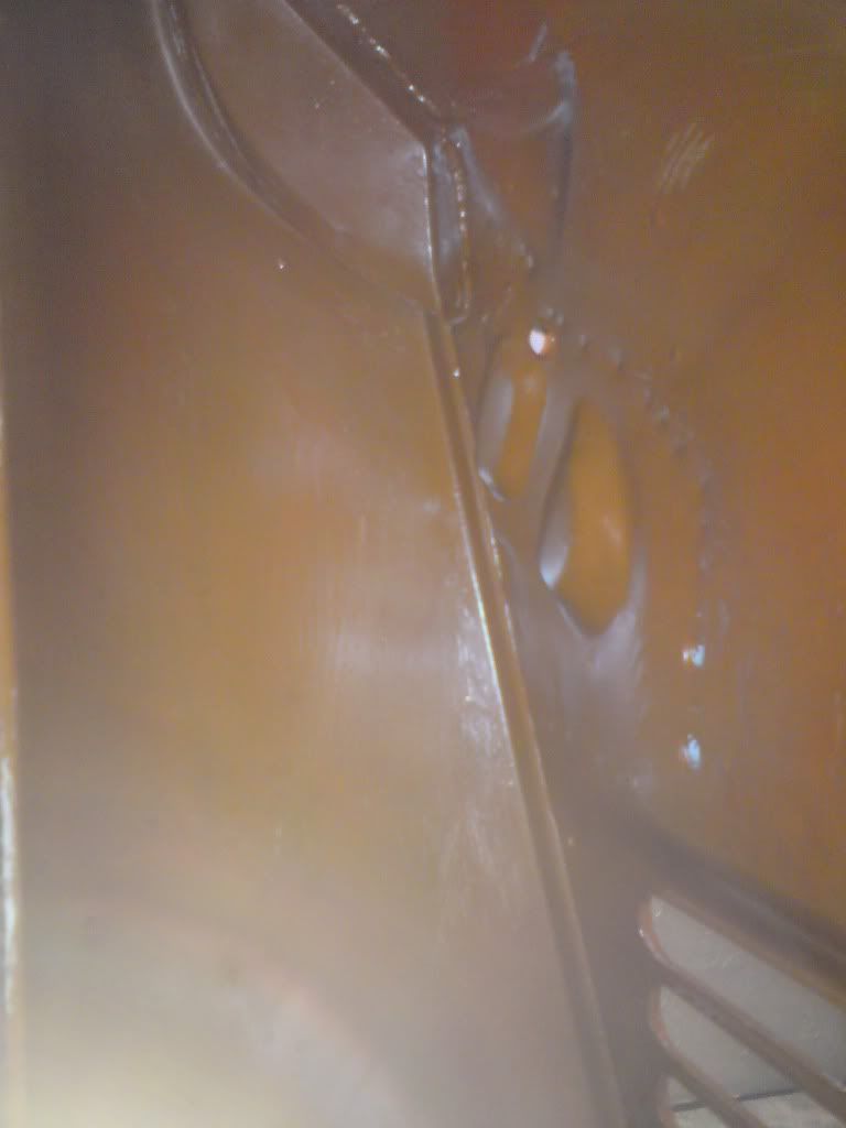

i had to strip back the bulkhead agin and re-do it all properly, everything is now seam sealed and primered ready to go :)
spent ages working in the wings getting high of paint fumes trying to paint everything properly and not mess it up by pressing my head against bits of it but its now all done in zinc phosphate and red oxide, just need to stone chip and underseal now and i can get a rolling shell :)

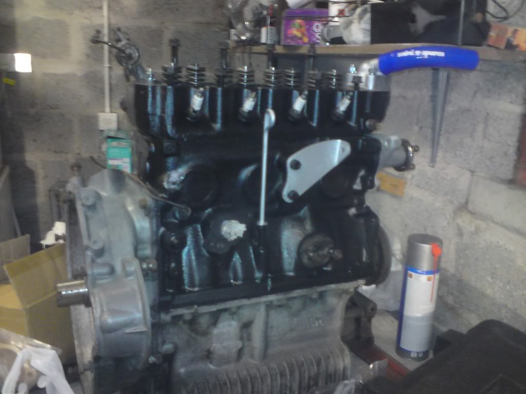

gave the 1st coat of satin black on the engine and put a few bit back on to see how it will look

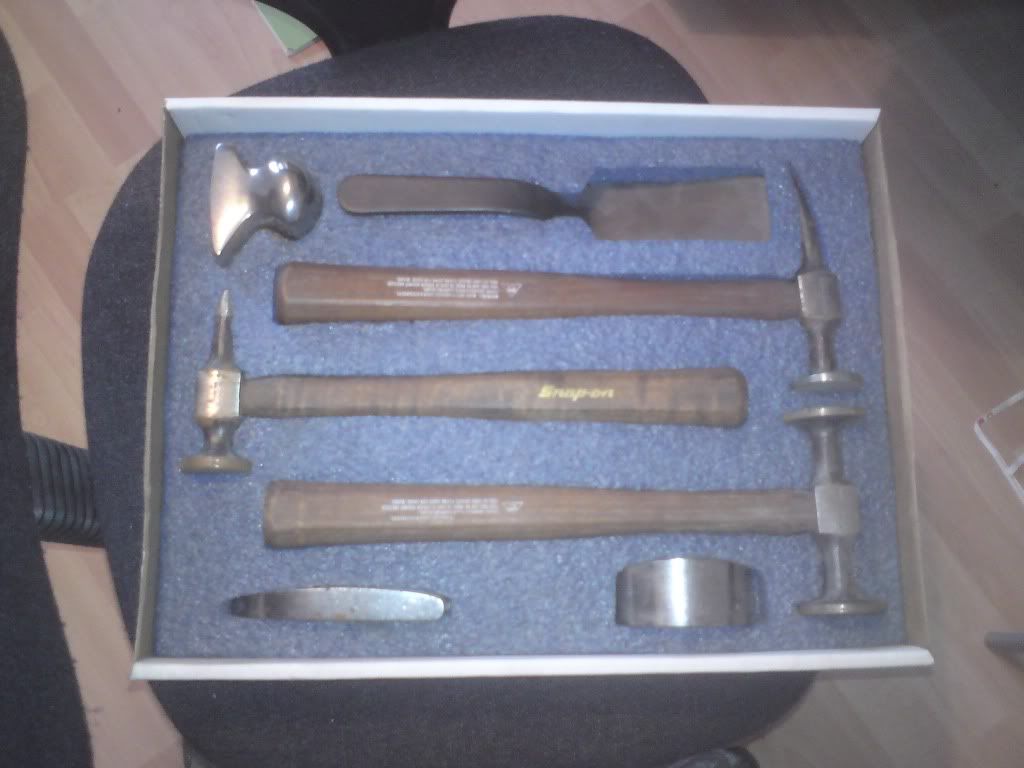

also got a couple of birthday presents that will come in handy :)

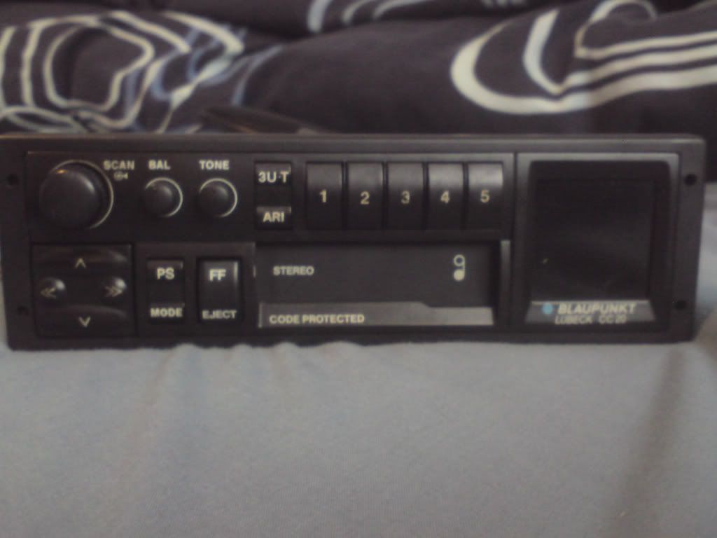

ive already posted a topic asking for advice on the radio and a sound system set up so hopefully it will be sorted soon enough :)

Those snap on hammers look tasty!, good work with the project, are you planning to have it done in time for the show season?
