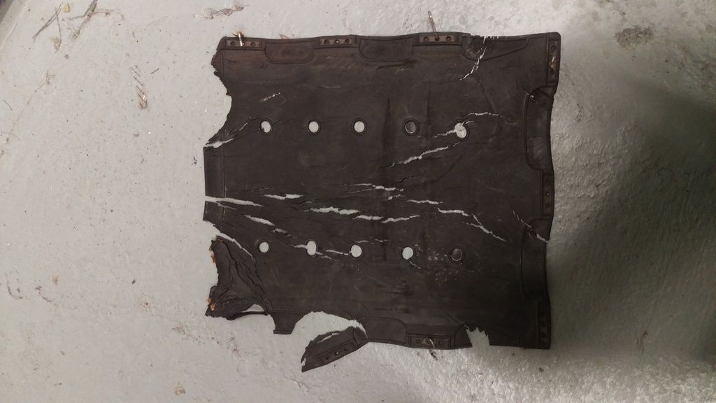

I Believe the seats to be a set that Microcell produced. They need a lot of work as all the foams are past their best, the rubber diaphragms are totally shot and the covers have seen better days.

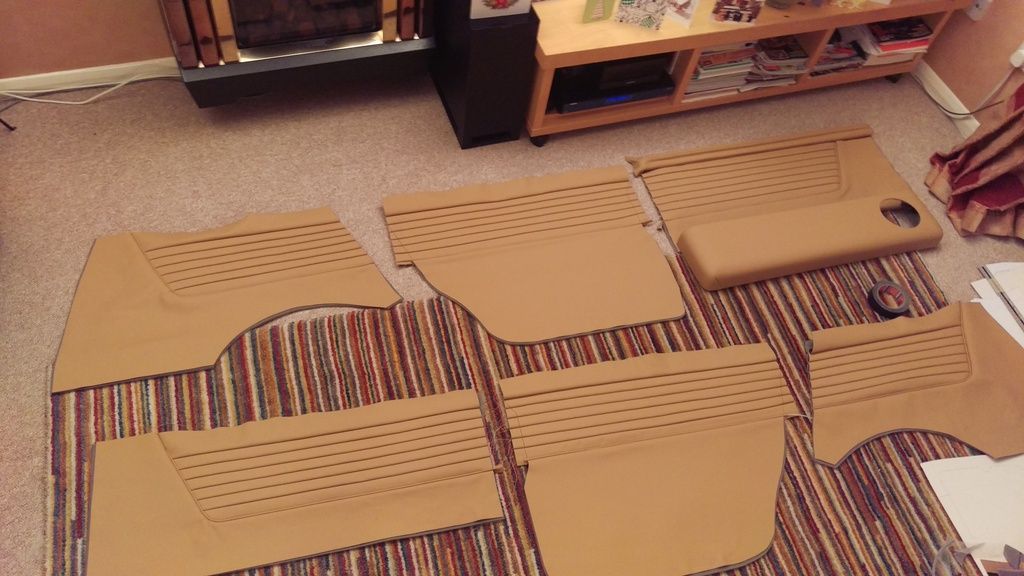

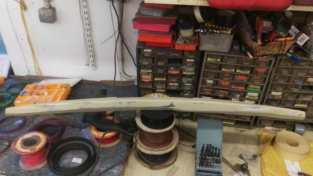

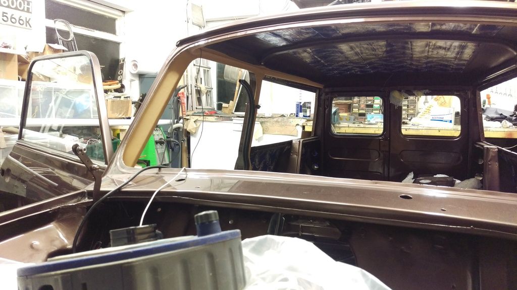

Over the Christmas period I have been mainly working on some of the interior trim and parts, whilst my dad continues with the wiring.
So a list of stuff that I have been working on:
-Modified the top dash rail,
-Made subframes for the front seats, with rails so they are now adjustable,

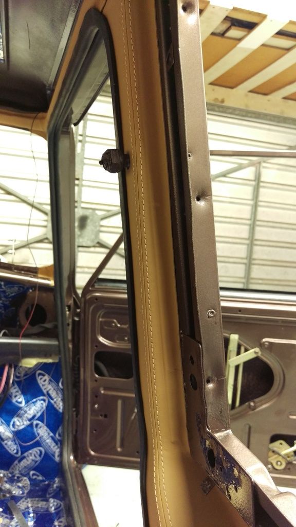

-Trimmed the A pillars, B pillars and the rail the headliner sits on.
-Made all the covers for the door/interior panels, and are now ready to be covered on the panels.

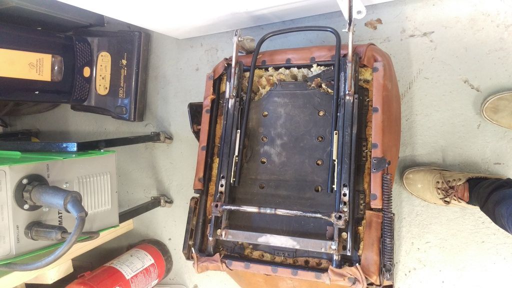

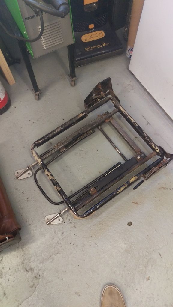

-I have started to strip down one the front seats

that trimming looks absolutely brilliant, great idea, and great execution

That looks stunning... such a nice idea and gives that luxury feel as well :)

The dash rail may not look that different, a few small changes. The main difference is that it is a lot slimmer and I have removed the ashtray.

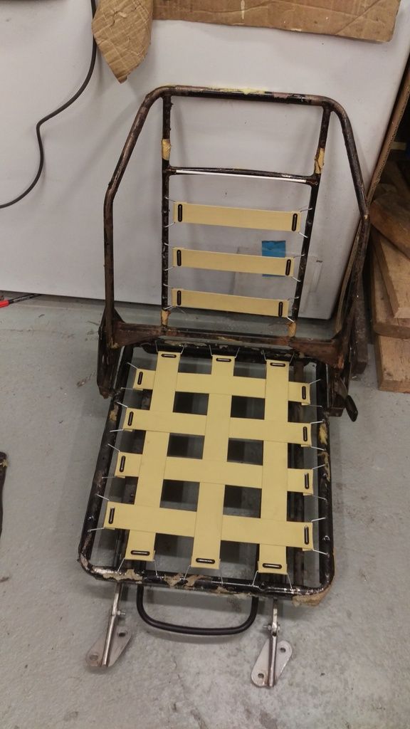

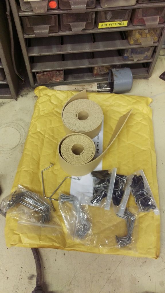

The old rubber diaphragms were totally shot, so I have made up new webbing.

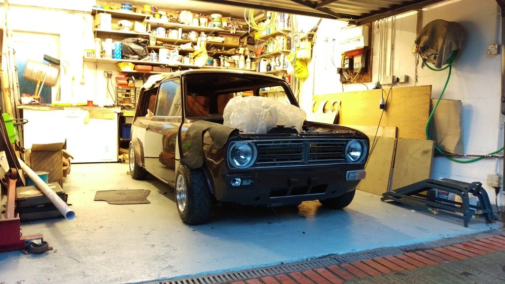

The wiring progresses, most of the front looms are now installed and terminated in 15way plug/sockets. The additional wires have resulted in a loom that's the same size as the standard loom. See the attached diagrams that detail the extra works, you'll see that we've effectively got a 3 Megjolt MAP solution (Map1, Limp, Map2).
We've also customised all loom by using glassfibre reinforced braided sleeving to get rid of the grey PVC loom tape normally used.
