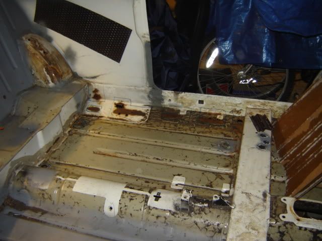

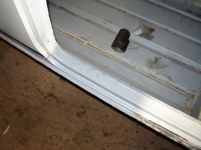

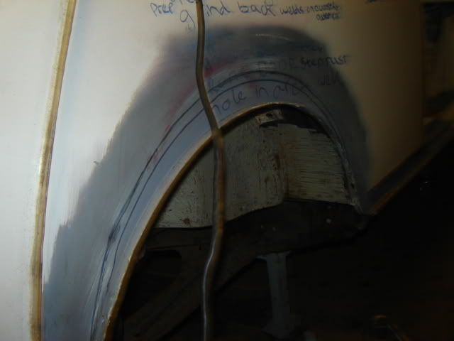

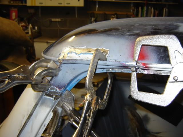

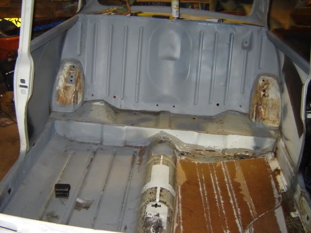

few pictures for ya. in no pecticular order, just showing the work that i have been up to.
p.s the line on the rear arches show where i will be cutting them out to.

hehe your clamps or what ever fancy name they have lol look like they are attacking the mini hehe
#292 andywaller
andywaller
  • 1,636 posts
Posted 17 October 2006 - 06:26 PM
yeah you just cant have enough of the little buggers!

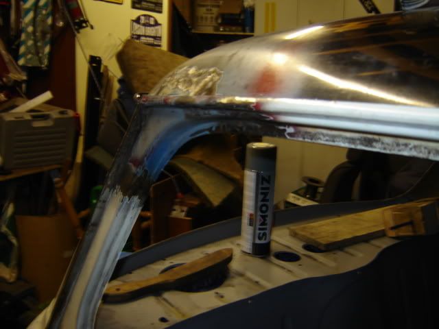

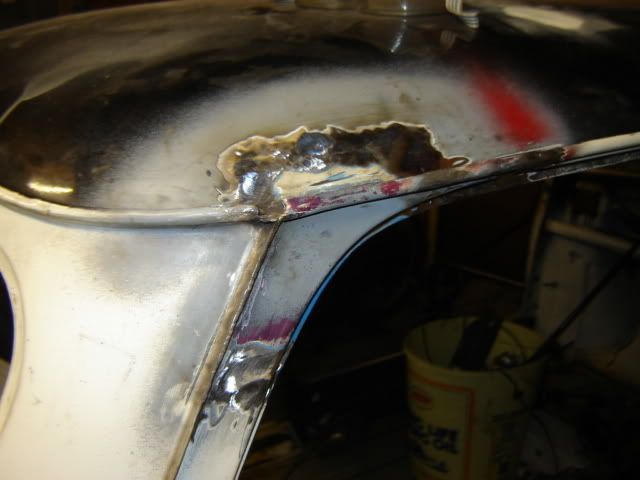

more pictures.
ive now finished welding and grinding back the c-pillar its gonna need a bit of filler action but it looks good.
ive also ground back the boot welds and just have to fill the big whole now, might go do that in a minute!
good having the car in the garage.

that patching job is pretty astounding MOWOG
#300 andywaller
andywaller
  • 1,636 posts
Posted 18 October 2006 - 07:23 PM
cheers i think im actually getting the hang of welding now.
i want to go back and re do some of the welding i did on the boot floor, it looks like a had a fammily of pigeons living in there!
oh well just have to cover it with carbon!

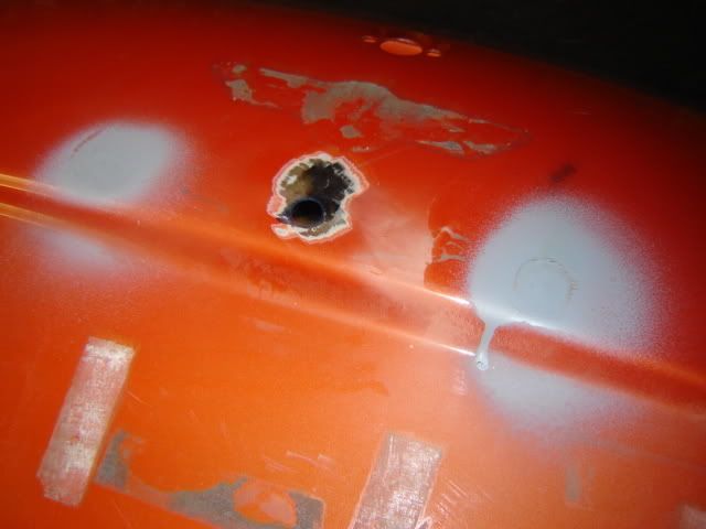

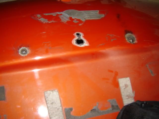

and i did go back out and weld up the last hole in the bootlid, just cant grind as its too late!
the boots not going to be smoothed i just wanted to get rid of the ugly numberplate light, now all i have to do is find some nice little lights to replace it. i want the little ones that stuart wright has on his blue turbo!
