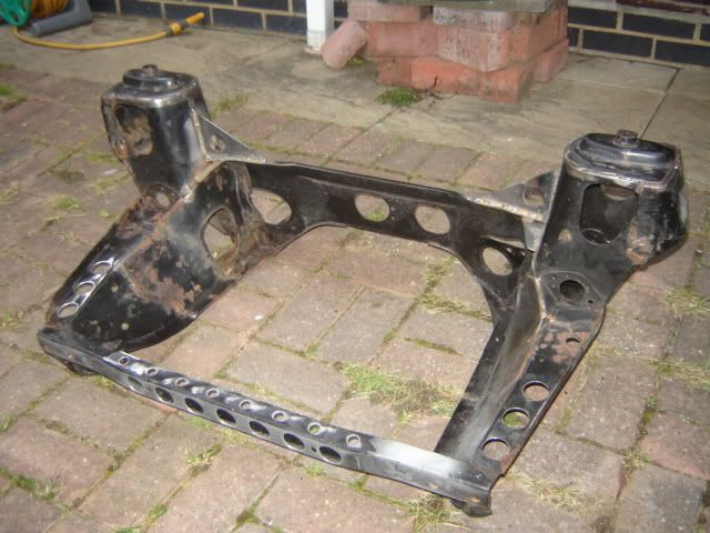

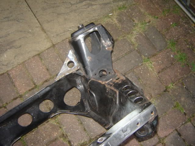

been feeling rubbish today so instead of doing more work on the shel i turned my attention to the front subframe, ive now triangulated the turrets and lightweight/ weakend the front of it too. im going to get it blasted then i will seam weld it.

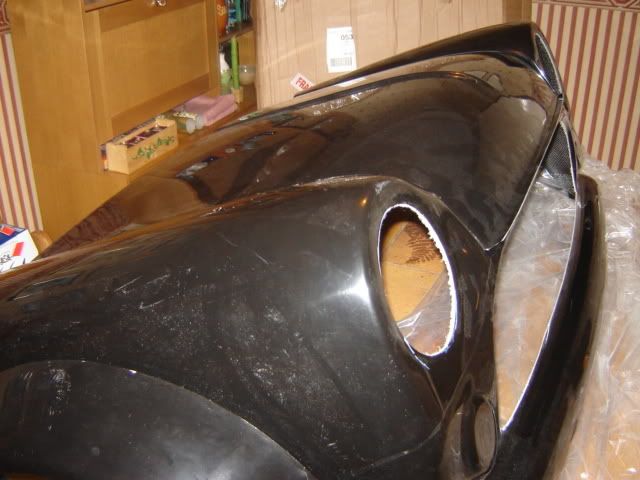

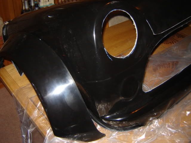

i also got my front end delivered from curley on friday, im really impressed with it, seams a lot stronger than i thought it would be but still has a bit of give in it. i lines it up with my bonnet and arhes and it looks lush, cant wait to get it fitted.
i got a bit dissapointed as i was mucked about by the courier and i dint get it until nearly a week after i should of arrived, but they sorted it out in the end and even knocked of the carriage.
the coolest thing about it is if you catch it from some angles you can see the weave throught the gel coat ;)

i put my front subframe in to be shot blasted today, should get it back early next week so as soon as i get it back im going to seam weld it then paint it, along with the rear frame.

yep you got it. the most important bits are the towers and tie rod monuts.
as it goes i need to add some more triangulation to these when i get the frame back as i forgot before.

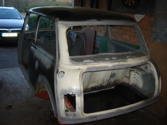

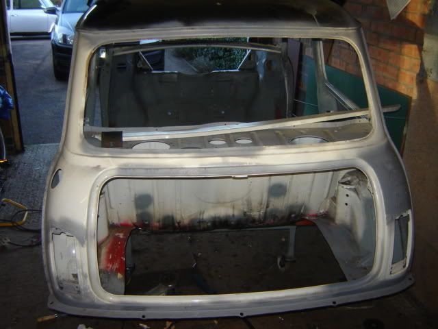

well i bought a book and read it and now things are going a bit extreame with the mini, instead of being a road car that i could take on the track, its now going to be a track car that i can take on the road... if ya see what i mean.
so modifications that i am now doing include tubbing the rear arches and letting in a full with baulkhead. creating frount and rear fire walls, and also creating a full weld in cage structue. im also going to get a carbon boot lid, and will be running with ap racing master cyliners with remote reserviors so i can run a curley carbon ram air system on my weber.
ive had a busy week end doing loads to the mini. i even found time to fit a induction kit to my mates focus rs!!
so being as pictures speak a thousand words...........

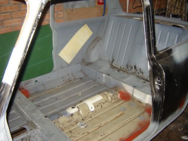

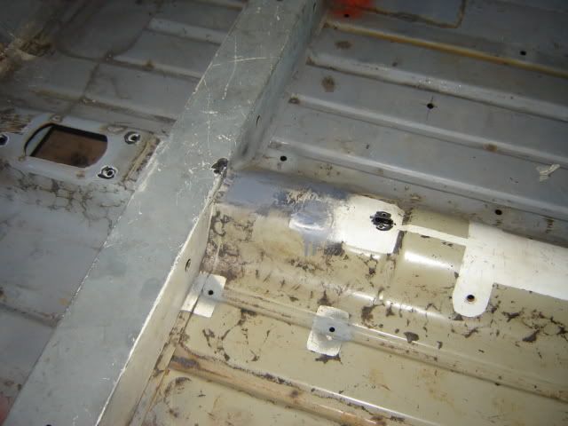

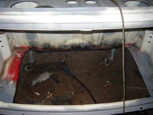

brackets for handbrake removed
filler neck hole welded up
i have fished the boot area by trimming the floor, seam welding the rear of the seat base, and trimming the floor to fit
