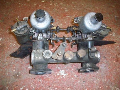

So while im waiting for my engine i have been trying to do what i can!
First thing is i won these on ebay

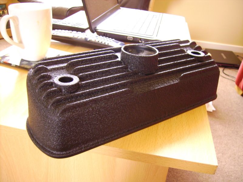

I also changed my mg rocker cover from this
To this
I might polish the ribs but im unsure as yet. Im not sure how well the wrickle finish will clean if it gets polish on it, does anyone know! Il be getting chrome T-Bars to hold it on and a chrome cap if i can!
The carbs will want an overhall as they are old, they were listed for twin 1 1/4 su carbs for MG midget healey mini cooper minor soi hope they are right! Just need to source some filters but i will be going to stanford hall next weekend and have a nose around!

Guessing by the rubber spacer btween sarbs and manifold they seem to be from a midget or something similar.
You need to check that the floats stay about 90° vertical with the manifold flanges are at 90°, i dont know if you get what i mean.
Also, if they're out of a midget, the carbs wil sit on the manifold at a 20° angle and they foul the bulkhead on a mini..
In that case you'll need a mini manifold which puts the carb at a 30° agle instead of 20° and then put 30° float chamber spacers to make the float sit correctly with the new carbs angle. The 30° type spacers are red/orage colour by the way, so give a check at what you got there.
Hope this helps, good luck with the build, 1098 are nice torquey engines and they dont need to be revved that much to achieve top power, which means way longer rebuild intervals.
