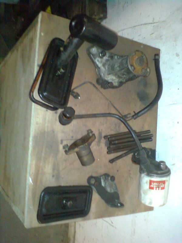

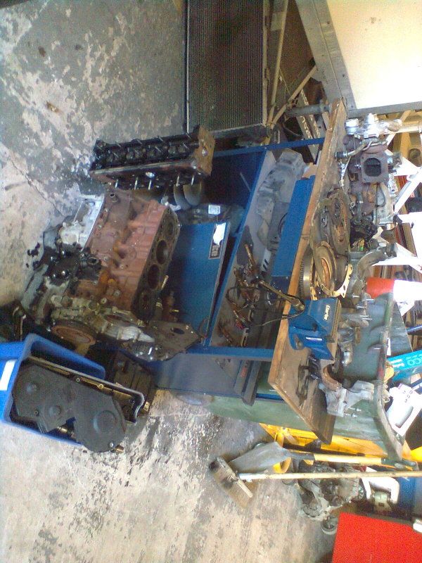

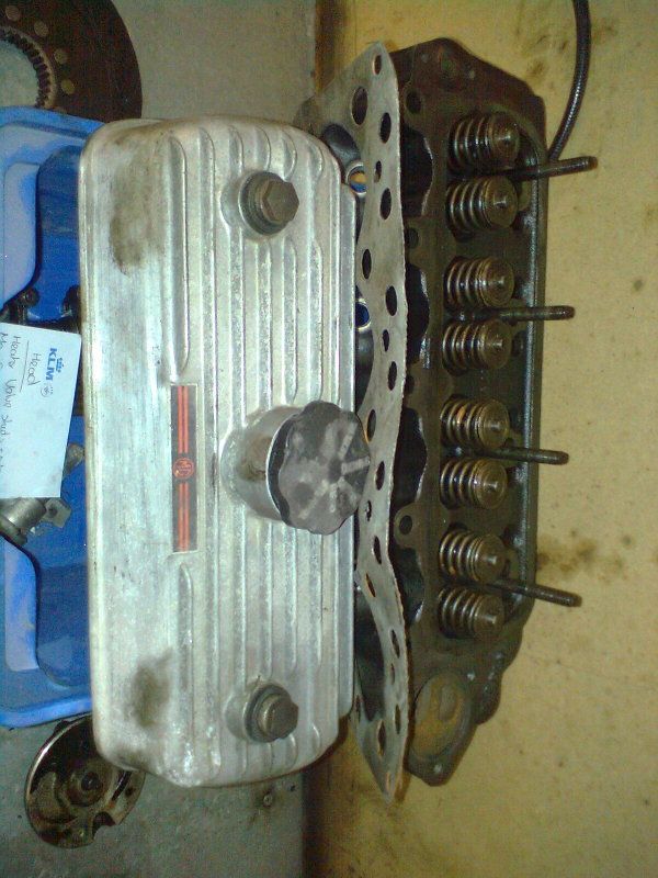

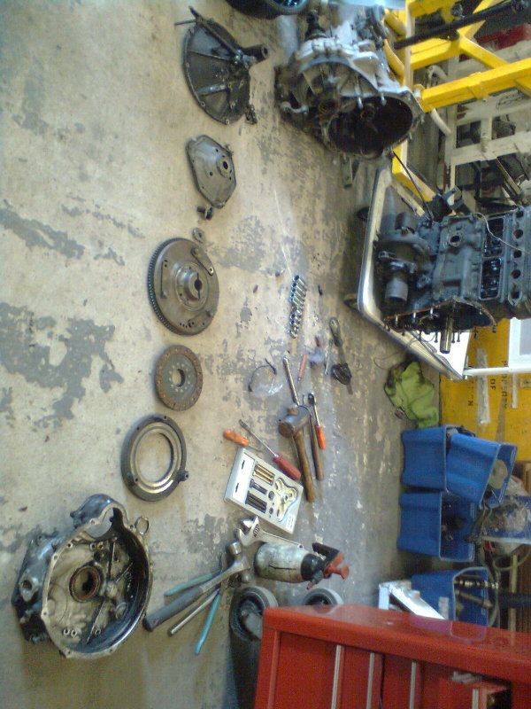

Right finally got some pic of the engine before i sent it off to be worked on!
The donated flywheel housing and flywheel from the 998
The 12g202 head that came with the 1098 and the MG Accessory Rocker cover that came in the box of bits
The parts off the engine that will go back on once its built
The main of the engine! Will the crank pulley do???
The poorly Transit Connect engine that i have to sort for my big boss

#85 oltonlad
oltonlad
  • 2,401 posts
  • Location: west midlands
Posted 18 July 2012 - 07:18 PM
it should be good when its all done, the crank pulley will be fine, are you sticking with the 202 head? the reason that i'm asking is while the engine is in bits you may as well have the block pocketed just incase you decide to use a big valve head in the future.

Posted 18 July 2012 - 09:02 PM
Well yes i am keeping the head. Main reason being is the engine builder is going to work his magic and see what he can produce. I want to make the most of the engine as it was rather than change it if that makes sence.
The second i mentioned cc'ing it he knew straight away what figure he wanted it to be and knew exactly how to make it right so im letting him have a free run. Might see if he can get me some pics but i think he would be too busy to do it. He is very good at what he does working on ferrari engines and odd ball exotic cars.
He mentioned re-bore, if he was to what do you think he could get it to?? Can you use other pistons! I seem to remember my mates 1400 minispeed engine having ford pistons as he blew one and they sent a replacement!
Next question is what clutch is that on the pic and what one do i want? I dont understand the verto and pre verto. I cant wait, should get my connect engine back towards the end of the week so i will take him the head so it can be complete.
#87 minimender
minimender
  • 1,589 posts
  • Location: Warrington Cheshire
  • Local Club: M.M.M.
Posted 18 July 2012 - 09:43 PM
Thats a pre verto clutch (early type)
Old type dynamo block as well
#88 oltonlad
oltonlad
  • 2,401 posts
Posted 18 July 2012 - 09:51 PM
if you can get away without reboring the engine then leave it as std bore as the 1098 engines are long stroke and although it will respond well to an overbore (you can actually bore a 1098 engine out to 1220 if you are brave enough by using hillman imp pistons) the engine will enevitably use a lot of oil (thats why i left my 1098 engine on standard bore).
if it does need reboring then treat +20 as an absolute maximum otherwise you will be pulling the engine back out sooner that you would have hoped......
oh.......and you will need the larger alternator bracket for that block (i used a 1275 one on mine)
use the pre verto clutch (the one thats in the pic) do not lighten the flywheel and a standard clutch and pressure plate will be fine for your engine (competition pressure plates can put a lot of unnecessary stress on the crank)
Edited by oltonlad, 18 July 2012 - 09:56 PM.
#89 Danthefestaman
Danthefestaman
  • 68 posts
  • Location: Daventry, Northants
  • Local Club: N/a
Posted 19 July 2012 - 06:09 AM
Haha, well it would be nice to say its a 1220cc as not many have it but if you say it becomes a burner then perhaps not
Did you notice the groove in the clutch pressure plate. Looks like it ran to the rivets at somepoint! The ring gear on that flywheel is ok but the other is ruined so could do with new one! Im guessing its a pre-engaged type? Will use the standard clutch then
I have the larger bracket for an altenator so i will use that.

#90 oltonlad
oltonlad
  • 2,401 posts
Posted 19 July 2012 - 07:14 PM
i would change that backplate, i was going to mention that it looks a bit marked but i wasnt sure if it was just the way that the photo had turned out, make sure that the clutch face on the flywheel is ok, are you assembling the clutch etc yourself as it has to go together a certain way, if your not sure how it goes then contact me when you are ready to put it all together.
