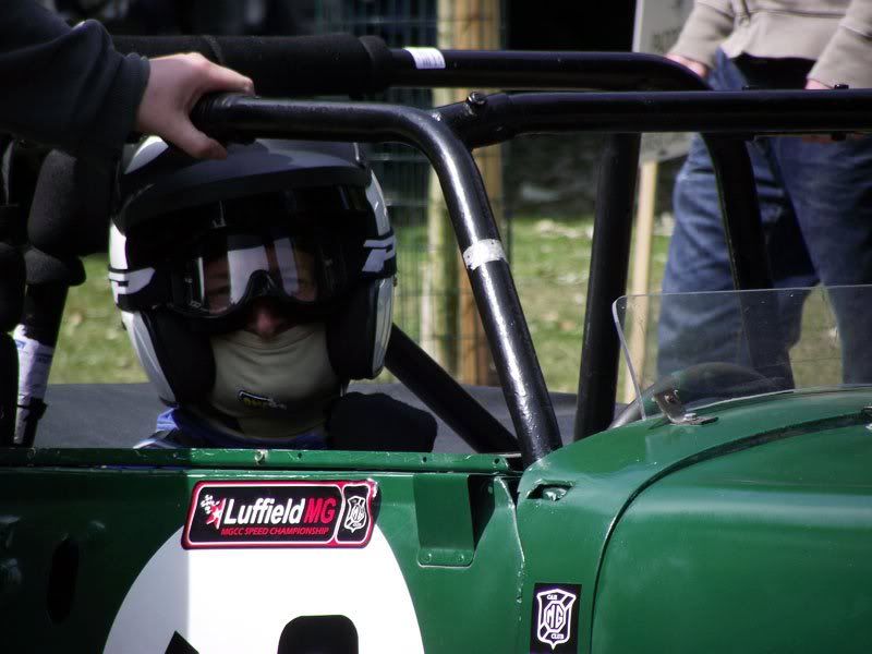

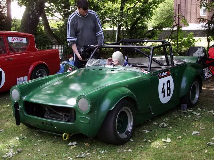

Yeah there were a couple of elderly chaps taking care of it, still pretty spritely to jump in and out of a race car though! Was a lovely beast, all fibreglass bodywork and 9 inch wide wheels wrapped in Avon slicks, a proper old school racer.
#25 giacomo
giacomo
  • 684 posts
  • Location: Southend/west cliff
Posted 27 March 2012 - 10:10 AM
i saw that midget at motorsport in the park last year, i instantly fell in love! its driven by an old bloke i believe ?
it went well tooo :P by far my favourite of the day! here's a few more pics of it :)
