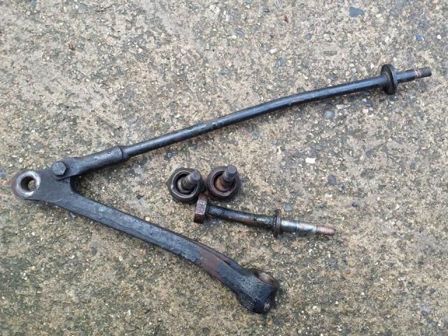

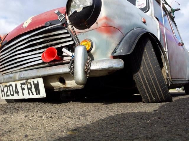

   Passenger side tie bar nut came off when approaching a roundabout at approx 60mph. Not knowing it had come loose, as soon as I tapped the brakes to begin slowing down the tiebar slipped out of place, allowing the hub, driveshaft and arms to snap backwards. The wheel slammed into the flitch panel and locked up. Felt like i hit a pothole that i never came out of again.. Slid further down the road heading rapidly towards the curb, I tried to brace myself and counter steer away but by that point it was too late.
Slammed into the curb with a fair amount of force, Popped the tire on impact, bent the lower arm out of place and put a kink in the tiebar. Nelly finally stopped moving after using the sump and exhaust system to grind along the curb leaving a massive gouge along the curb. She certainly left her mark in the road!
Jack saved the day after seeing it all happen in his rear view mirror, parked up in a safe location and ran back down the road to get me out the car. After a few tears of utter panic he calmed me down enough to go look at the damage....
10154454_10152441600715948_3938433972039
10346764_10152445679490948_1391708615_n.
10352774_10152441599985948_1881581628173
10342696_10152445679240948_1394571029_n.
If you look closely the skid marks actually start about 1 white line into the change of road surface..
1901179_10152445358945948_50949860483317
Damage.. not only is the lower arm bent but also twisted
10268463_10152445599385948_4782473508317
This part of the ball joint has not been damaged in any way to get it off the hub - what you see there is it became mishapen when the rod part of it was ripped clean out on impact..
So please please please!!! be careful out on the road and make sure you use nylocs on anything that may vibrate free / is part of the structure of the car!
