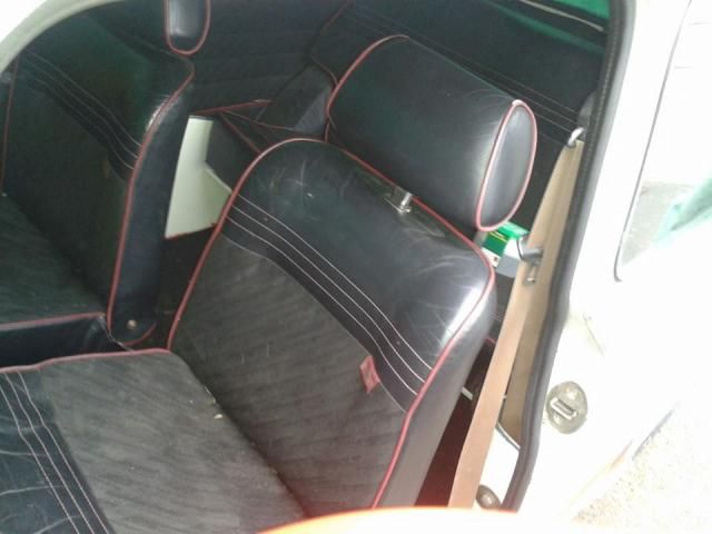

Mini 30 seats?

Indeed! I love them to bits :D  So comfy!

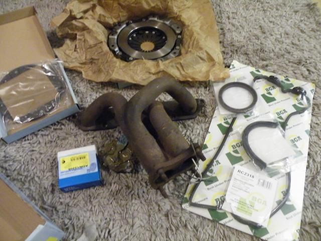

More goodies turned up today, still waiting on more!
And as i typed that, the parts came through the door :)
I take that back, it was rat food!

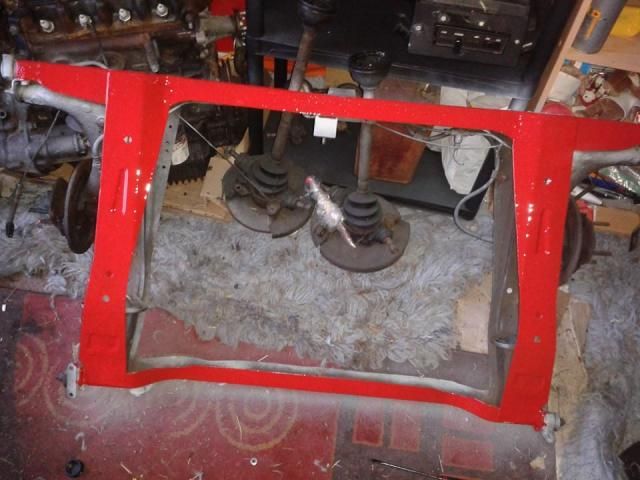

Well i only had red, and i only had enough time / space to do one side at a time..
So, one side of the rear frame has been flapped back (thanks sam), then etch primered.. then a lovely coating of hammerite red!
The radius arms will be getting a rebuild too as i have new bushes etc for it all.
I will be doing it bit by bit but will eventually be all red. the underside will be waxoiled once on the car :)
I heard from the workshop that my engine has been stripped back.. Im going to pick up the exhaust manifold soon to get a new flange laser cut :)

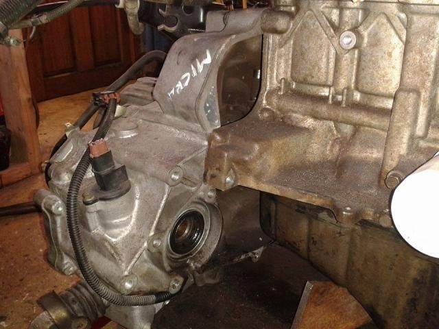

Bluhhh.. depressing weekend with not a lot done! now at the subframe building stage. no idea what we are doing so going to take some measurements and wing it!
Plus, put the gearbox on the engine and found this :
1475967_10151809939477233_282562192_n.jp
Missing parts!! barrrghh!!! :(

Mini 30 seats?
yep :) original ones bet theyre in a better state than mine.

He did mention it to me, im just worried about crap getting in there :/
Also want to know if there is something that is meant to go where the right hand pot joint goes in.. seems alot of threaded holes in that area..
#193 Artstu
Artstu
  • 837 posts
  • Location: Derbyshire
Posted 16 December 2013 - 10:35 AM
Yes I think the rear mount fits some holes, there's also a little support bar from the gearbox to engine, most of which Frank doesn't use.

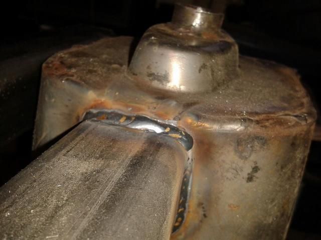

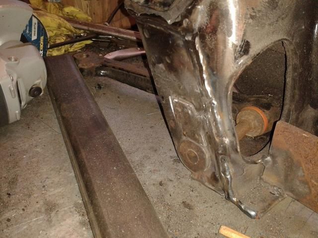

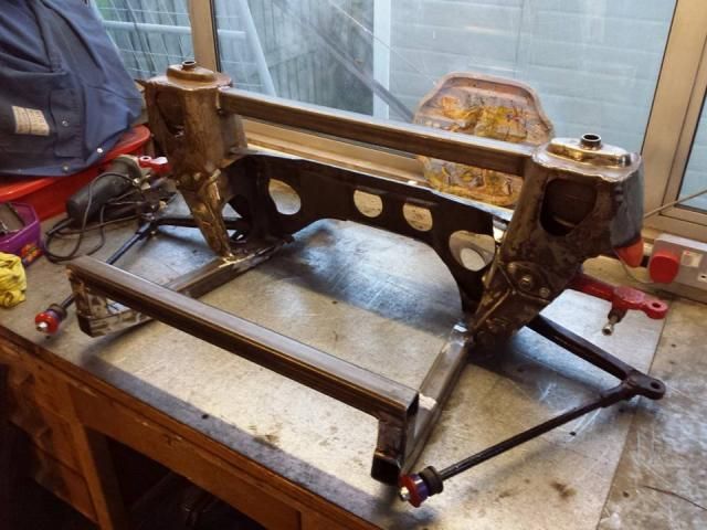

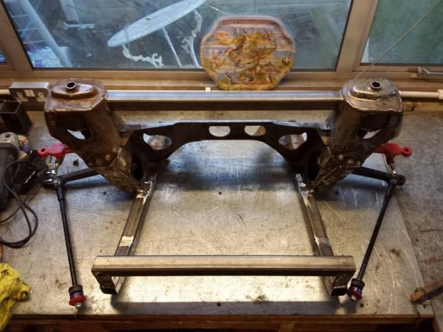

Subframe modifications.. Seam welded the top, Chopped the front off and put a brace bar between the struts.. Thanks lads :)
734194_10151818584312233_1202531586_n.jp
1472810_10151818584487233_758252405_n.jp
Anyone who knows mini subframes will see that part of the frame strut has been cut and folded, then seam welded for strength.. These buggers are tough to cut, at some parts they have about 3 faces to cut through >_<
We took measurements then started cutting, Will put the numbers up when i find the paper we put it on.
With this frame we are going to measure everything, hopefully allowing people to cut and make their own frames once we have this one together! maybe put some plans together?
