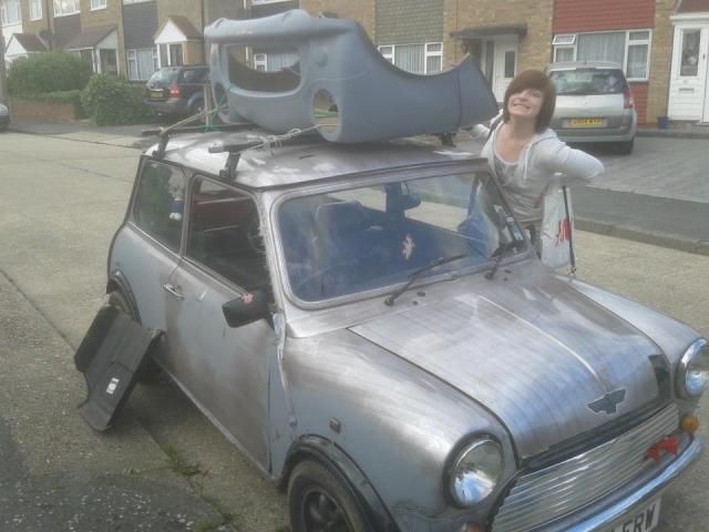

Fixed all of Nellys running issues although I was told it was a cracked head. The real problem? The bonnet latch has been welded in a strange position so when closing it catches and pushes on the dizzy. Replaced the worn spark lead it was rubbing on and in a fit of rage bent the entire bonnet and latch. Not a problem since! No cracked head, yipeee!
This picture shows a bit more how she is aging.. plus my wonderful girlfriend Terri :) (not aging haha!)
40 quid bargain that front end!
