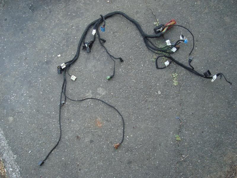

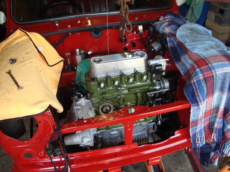

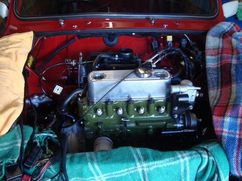

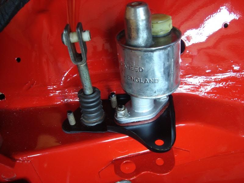

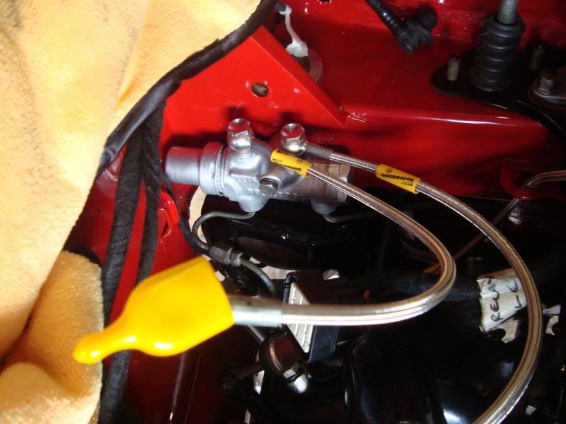

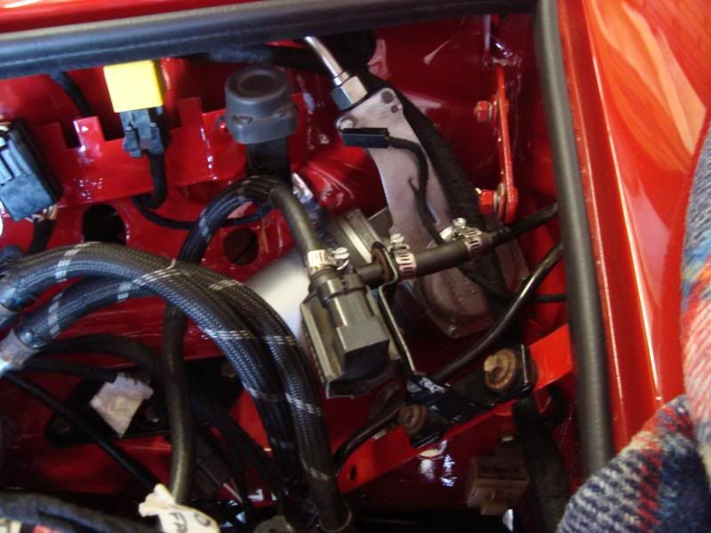

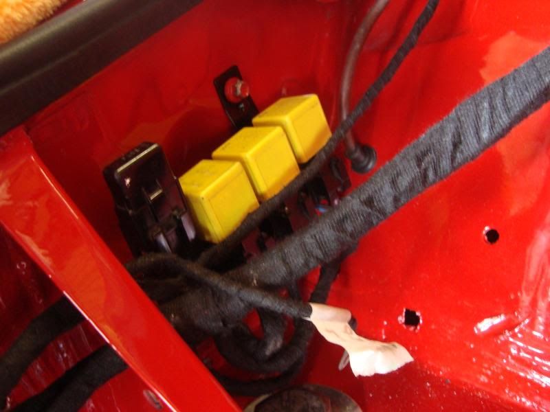

A rubbish quality photo of me stripping and retaping the engine bay loom:
One of the engine loom done:

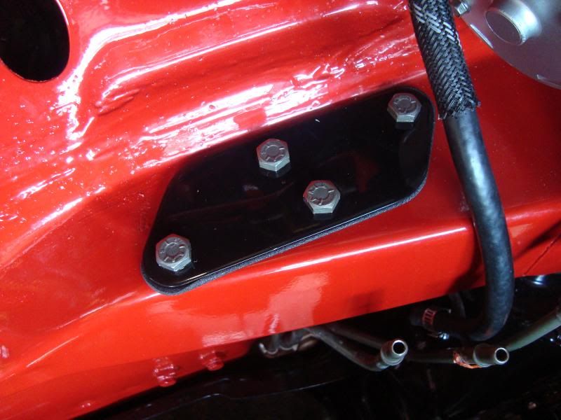

Just a quick picture of this lush stick of metal I didn't know I had, sorry it's rubbish quality:

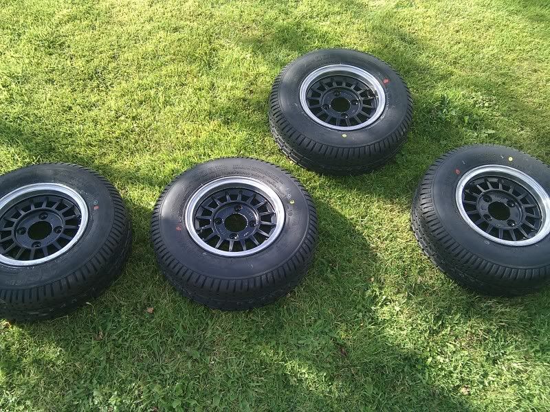

Oh and these are how my wheels currently look, they're not finished yet, the spokes are gonna be polished :D

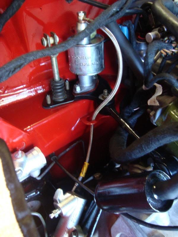

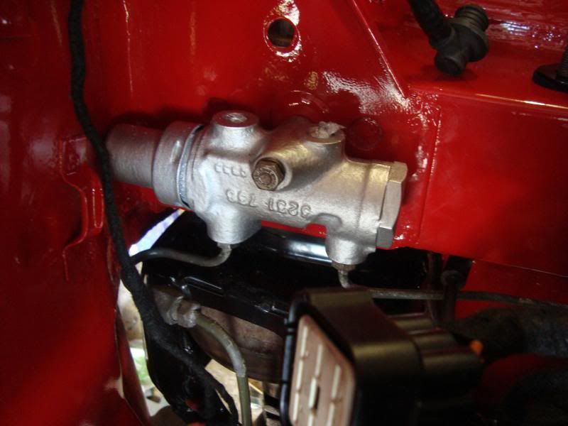

Things became a rush, and I really wanted to get the car done. I was up at about 8 every morning and didn't come back inside till dark at night. I managed to get the engine started fine (after a little tinkering with the wires going to the starter motor) but then had quite a few problems with what appeared to be earths (thanks for all the help Oli!). It took me four days to sort that out. Then the windscreen had to come back out so I could fit the top dash rail. Then I started filling up the brake fluid to find that one of the outlets of the brake master cylinder was blocked, so that had to come off and be cleared, and put back on. Then when I got brake fluid moving through the pipes, I found a major leak at the union just above the driver's side brake hose, so I had to swap over the braided hoses (thanks to Shifty's advice), which included removing a few parts from the engine bay in order for me to be able to do so. Then when I went to bleed one of the rear wheel cylinders, the bleed nipple rounded itself in the cylinder, so it didn't go up tight, so I had to go and buy a new cylinder from the motorfactors. However, when I got home, I found that I couldn't screw the brake line back into it. So I went off to minispares to get new brake lines (I also have braided hoses at the rear too) and two new cylinders which I got onto the car. But then Craig noticed some major rust on my rear subframe that looked like this:

Good stuff guys, be interesting to see it on those wheels, they look just swell  :highfive:
