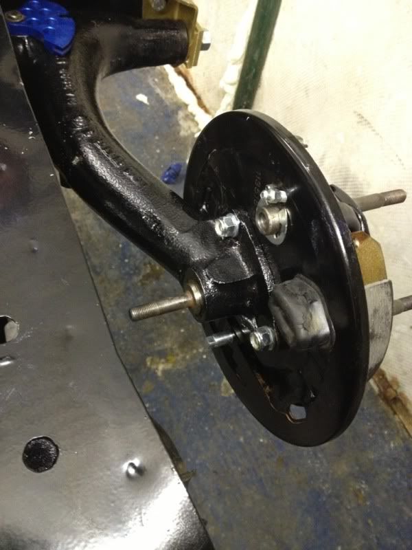

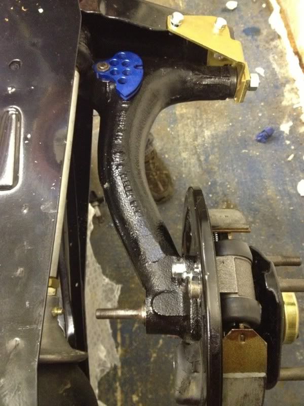

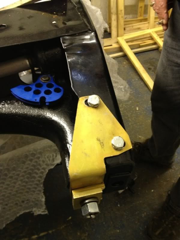

Today I started to build the rear subframe which didn't go great at the start, the subframe was powdercoated but the powdercoater didn't cover the threads so they all ended full of powdercoat :(
After cleaning all the threads I started to put the radius arms etc on when it came to putting the camber brackets on the righthand side holes didn't line up at all managed to get it so 3 lined up but the fourth was about 5mm out, and also whilst doing one of the others up the captive nut that's tacked to the subframe snapped off so not happy so threw the tools across the garage.
Desided to do the otherside and have a think on how to fix the problems tomorrow any ideas please let me no was thinking of using a nut and bolt but will cause issues when trying to adjust the camber brackets. Also the other whole that doesn't line up was thinking of elongating the holes in the camber bracket.
Edited by clivemk1mini, 18 November 2012 - 07:05 PM.
#70 Gr4h4m
Gr4h4m
  • 1,802 posts
  • Location: Chester
  • Local Club: Club less.....
Posted 03 November 2012 - 10:49 PM
From what i have read and trying to fit a set like yours they never line up. Mine were also made of cheese. They went in the bin.
You can elongate the hole
Send your originals off to be modded, force racing did mine( you then know they will fit)
Some people have had better luck with the minispares or kad ones.
#71 clivemk1mini
clivemk1mini
  • 1,064 posts
Posted 03 November 2012 - 10:52 PM
Thanks graham unfortunately I don't have the originals as they didn't come with the car when I brought it. I will have another go at it tomorrow and maybe change them once the car is home. Need to build them so the car can be brought back rolling.

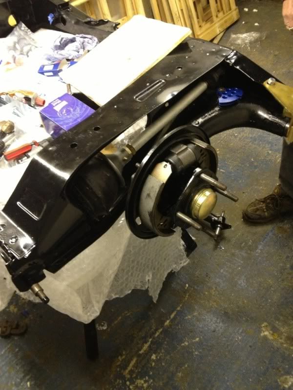

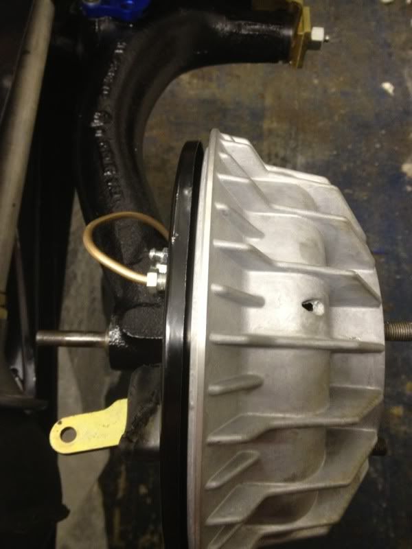

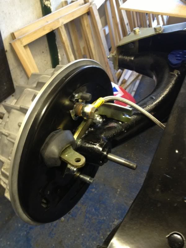

Posted 04 November 2012 - 07:41 PM
Bit more done today
Edited by clivemk1mini, 18 November 2012 - 07:06 PM.

Clive looks good mate but you haven't got the brackets bolted on to attach the handbrake, well not seeing them in any of the pictures.
#74 clivemk1mini
clivemk1mini
  • 1,064 posts
Posted 04 November 2012 - 08:13 PM
Which bits do you mean mate
#75 charie t
charie t
  • 3,153 posts
Posted 04 November 2012 - 08:21 PM
Hand brake retaining brackets.
http://www.minispare...brake.aspx|Back to search
They bolt to the radius arm
