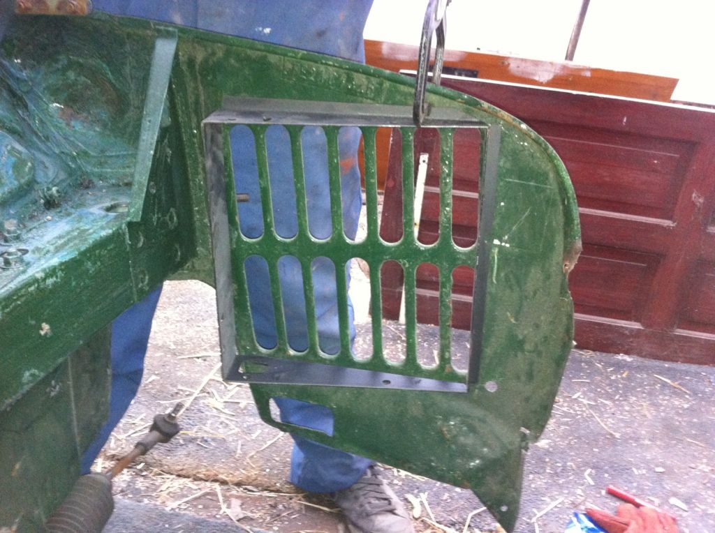

Right need help from someone with a mk1 shell. I need to fit this rad cowl panel a need to know some measurements so I get it in the correct place
Need the distance from the bulkhead to the back part and from the top of the inner wing down to the cowl . Cheers !

I'll take some pics & measurements tomorrow if that's any help.

Hope these are of some help -
Let me know if you want any more :-)
That's perfect mate ! I will get it welded on now! :)

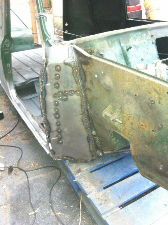

#266 ryan22_lgm
ryan22_lgm
  • 1,478 posts
Posted 19 March 2013 - 06:44 PM
Bit of an update for you!

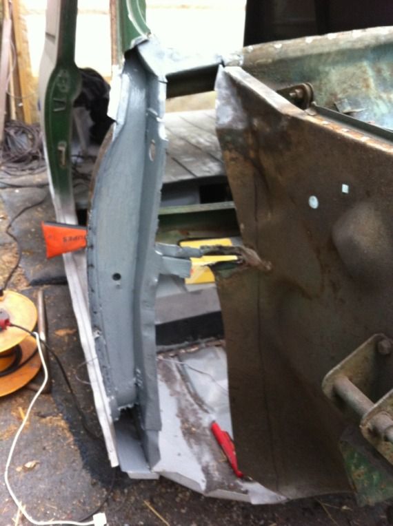

Pic of the d/s inner wing repair panel welded in

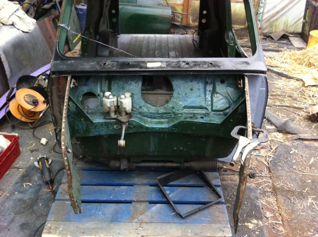

Trying the scuttle on
Then we thought we would make it look like a van again lol

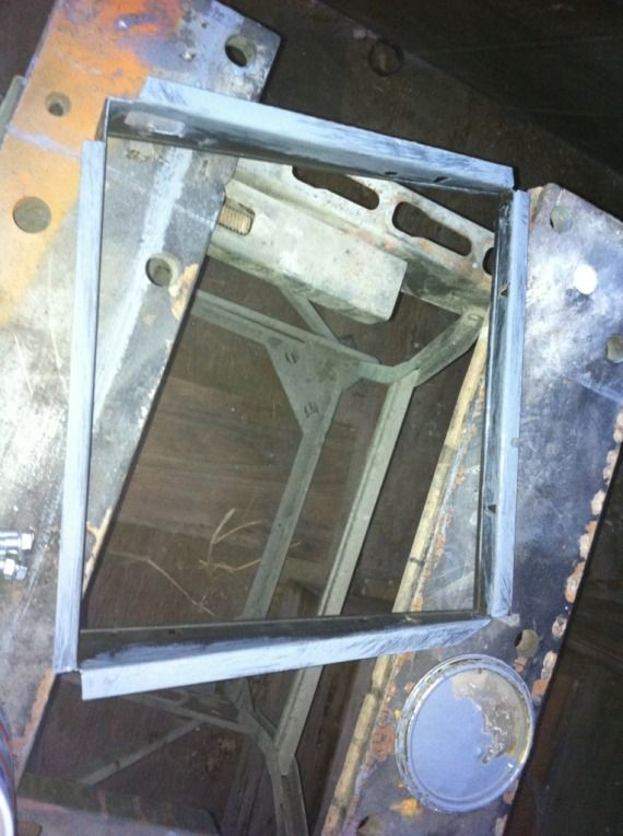

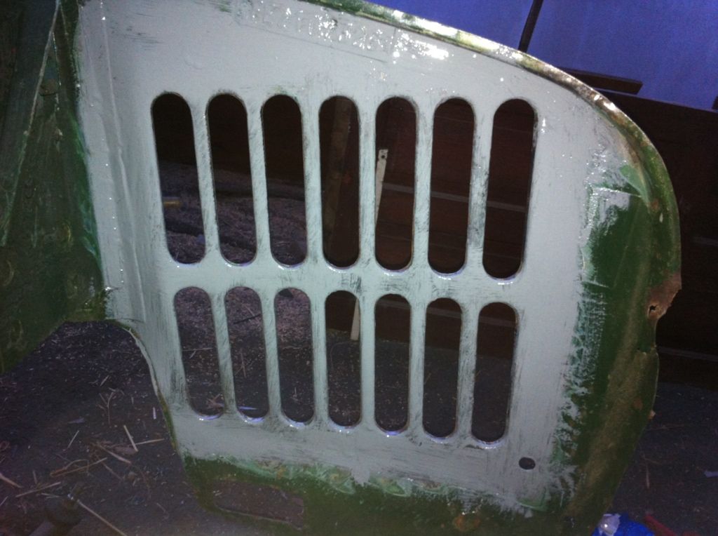

Cleaned the inner wing to bare metal ready for the radiator shroud to be welded in painted in zinc 182
Cleaned the edges of the shroud to bare metal and painted that with zinc 182
I'm waiting for this paint to go off then I will mark were it needs to go using the measurements mini josh gave me and drill some holes and weld it in!

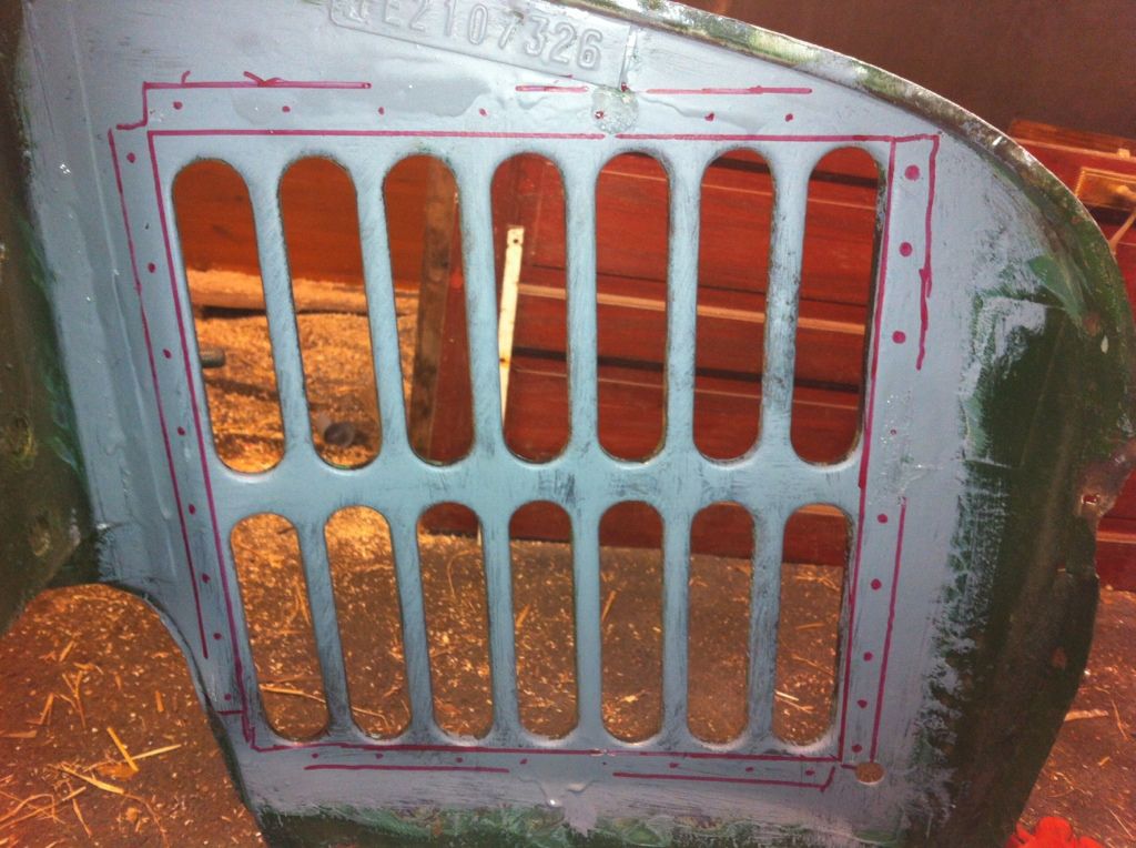

Marked it out but paint still wasn't dry so couldn't weld it on
