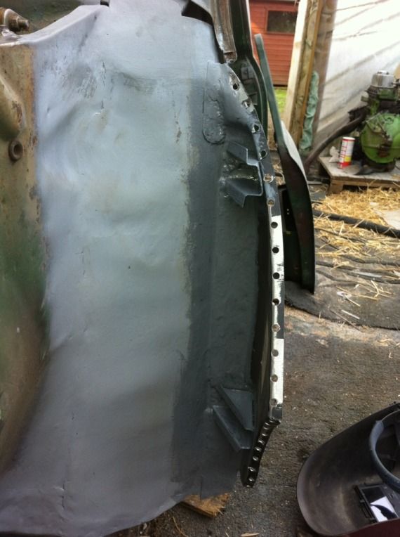

Got the inner a welded on p/s today only slight amount if adjustment with the hammer. Holes will need filling slightly aswell
Door isn't actually bolted up in this picture as I can't find the bolts and washers :/
Inside view !
Welder did not want to work properly so I will finish welding it on tomorrow now. And I will get the outer a panel welded on!

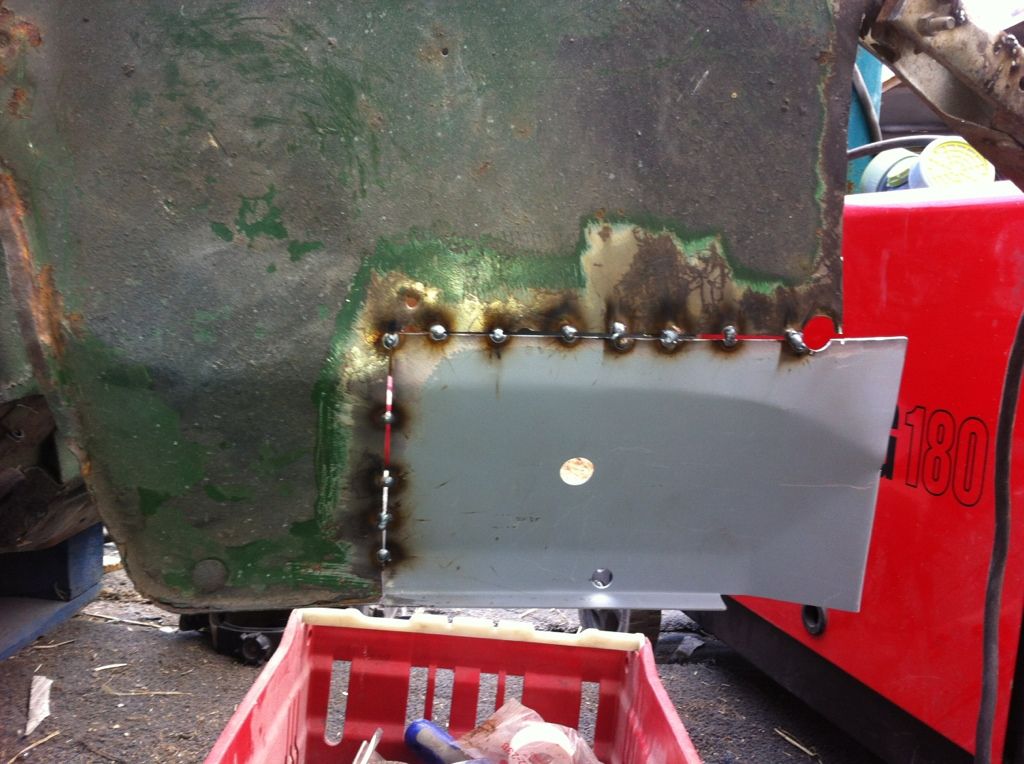

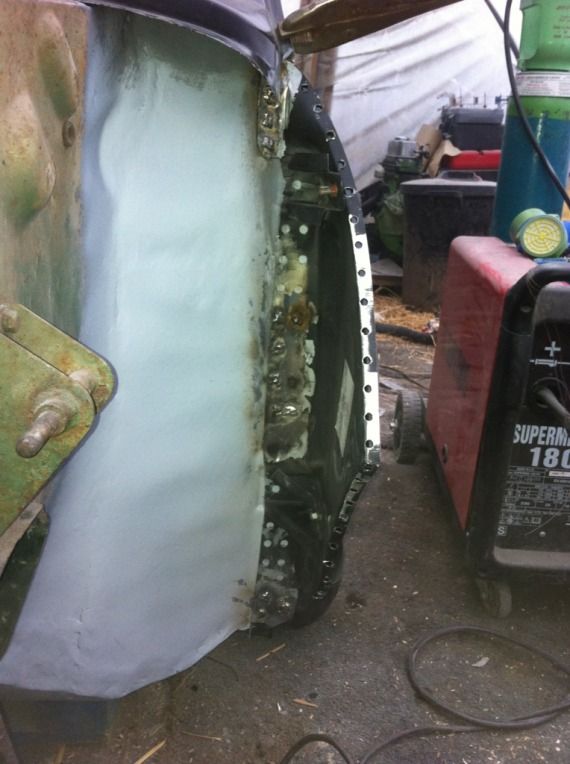

Done some more work today ! Welded a repair panel into the corner of the d/s inner wing
Clamped in place
Tacked in clamps removed
Welded and another piece made to fit the front edge and welded in
Ground down with the flap disc both sides
Good coat of zinc 182

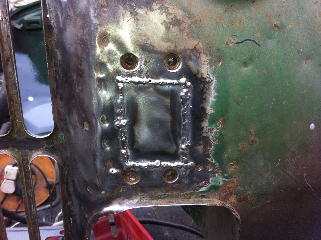

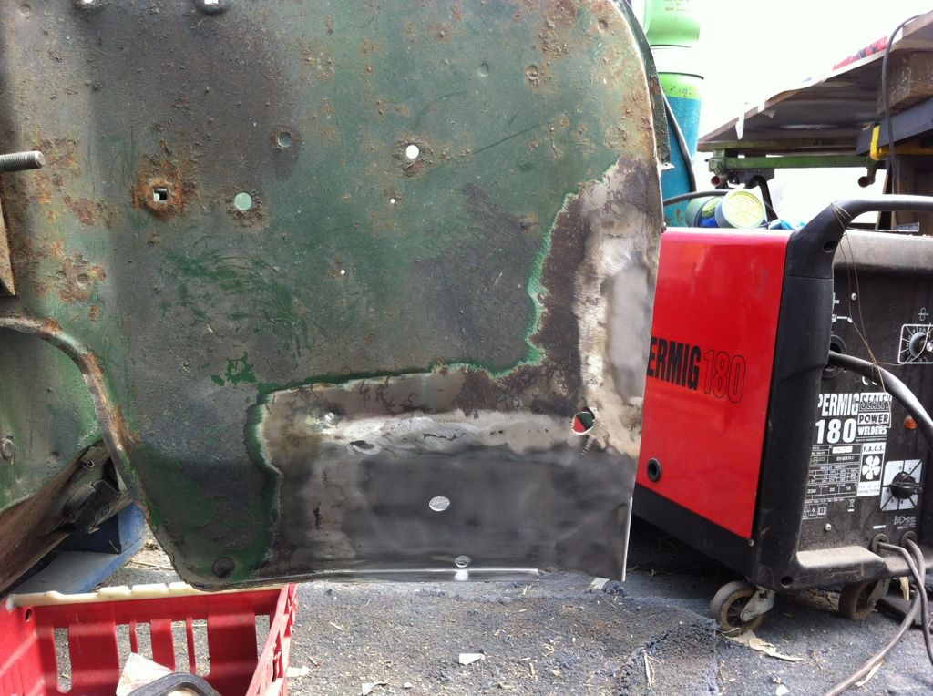

Did some more work to the p/s inner wing tonight first I took the shock mount off cleaned it all up and cut out the pitted top layer and made a section to fit the gap
Then I welded it in! My welding s a lot better because my dad fixed my auto darkening welding mask! So now I can see what I'm doing rather than looking away!
Ground off and painted this section!
