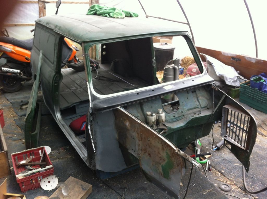

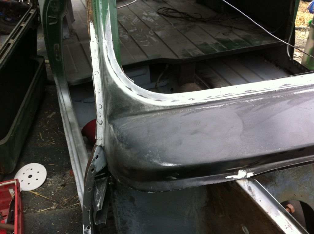

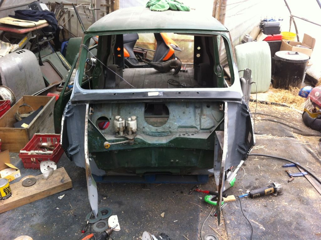

Right been cracking on today! Finished welding the scuttle on and ground it all down. Was going to weld the closer panels on but thought if I need to adjust it for the wings I wouldn't be able to.
AF955C77-C290-4870-A278-7B3D30C0D53D-153
F912C6CA-F237-4CA4-8BF4-95D3D82B8077-153
Ground down all the welds on the d/s inner wing and painted that up as well as the scuttle welds. It's ready for the flip front now .............. JOKE !

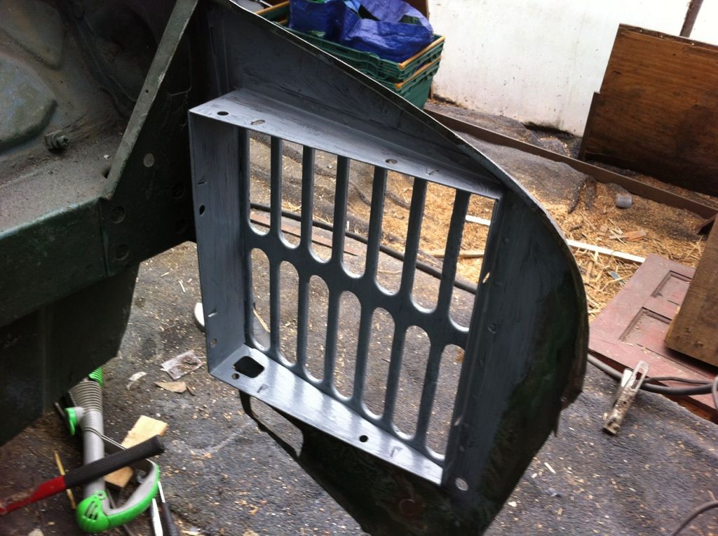

Sorted the rad cowl up and painted it !
5520DB08-D546-48AD-B5FF-90BC82BAA94D-153

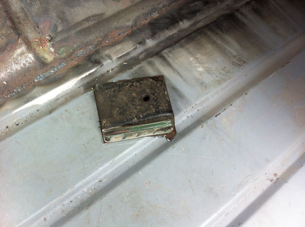

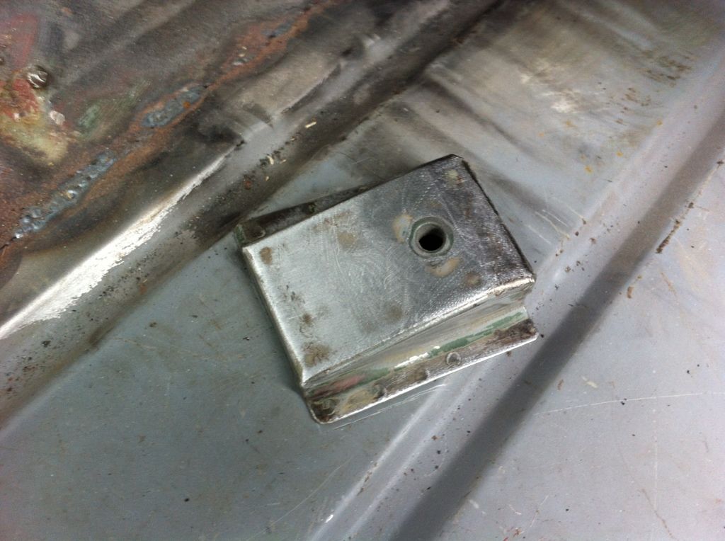

So this morning a decided to sort out the spare wheel bracket. First I placed the old piece of floor pan over the new and marked out were it needed to go ! Then cut it out if the old pan and ground it all off.
73218DB1-3BE5-48F0-8C88-D191BE6E6A7A-747

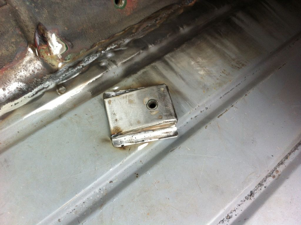

Cleaned up
A8C9E52B-5BDF-4AA6-96C9-CE3A6B247050-747
Welded on and all ground off !

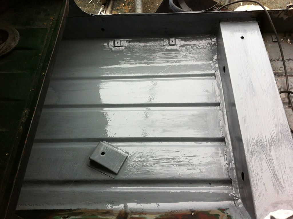

29EE4C2F-36D0-46F0-9E72-76E55C626FFF-747
Then I ground down and 80 gritted the rest of this section of the floor and gave it s coat of 182
C6EAA68C-12DE-441C-8726-01F01C188945-747
Will be sorting the front part of this side next! Doing this because I'm saving for a pair of wings

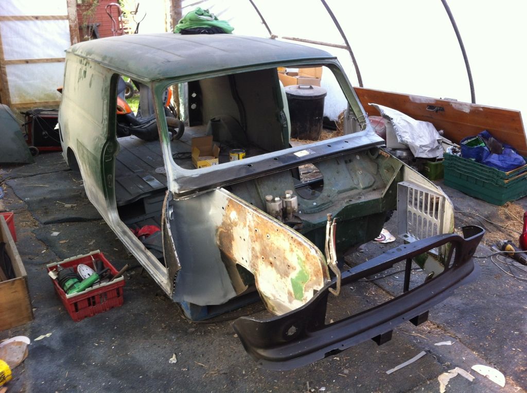

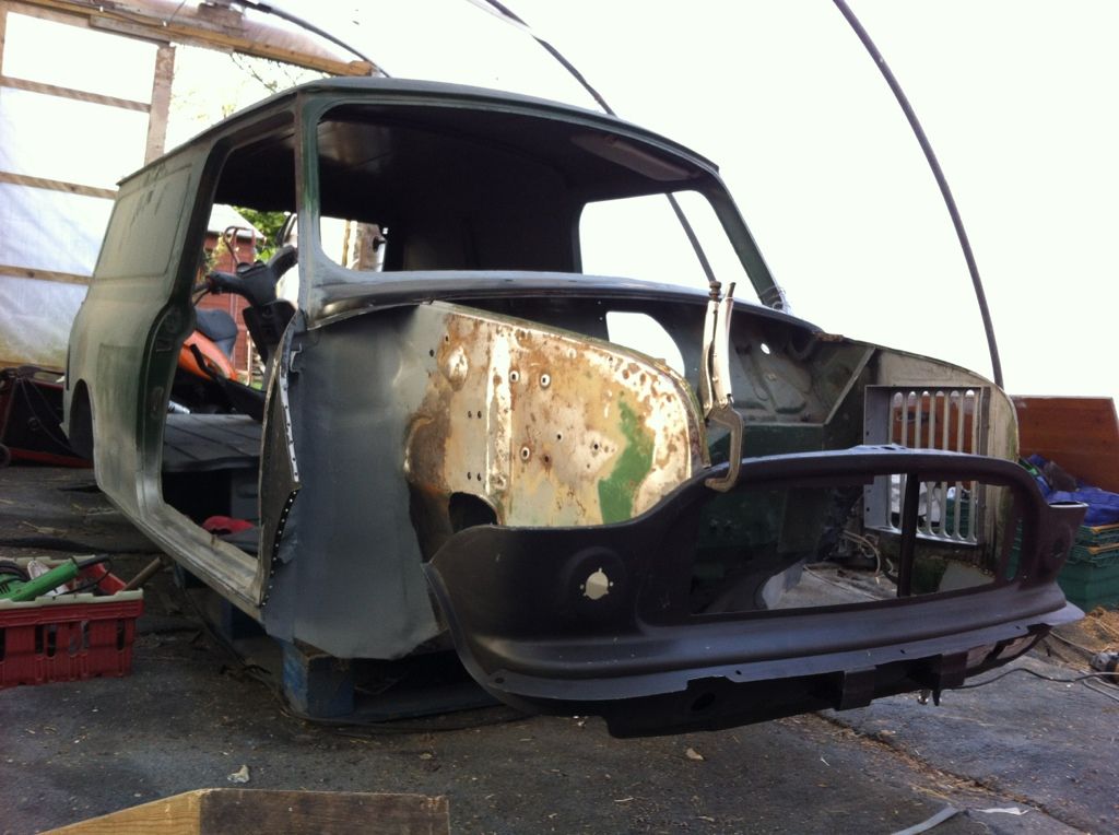

So today a parcel arrived ! I sorted this out first
9F376CBC-3F95-4D16-872C-FE8F599297A8-149
Only tacked it on so I could get this clamped on for some inspiration! :D bought it non gen from somorford mini
47E33D90-BBAA-4DDD-B861-207D78EB2FF9-149
AC9181AE-9068-41FB-82D4-5AA66BD99322-149
Now to strip The inside of it and etch / prime/ stone chip it before fitting it on !
