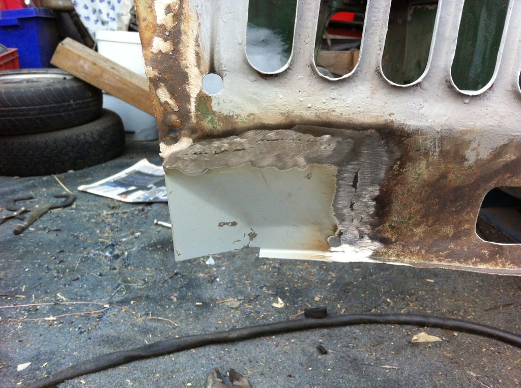

Posted 17 May 2013 - 04:02 PM
Finished the p/s bottom corner this morning ! Couldn't do anything else had to go work!
45DEB71D-3B20-44FA-937F-65EF409D78B0-298

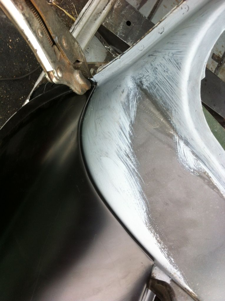

Posted 22 May 2013 - 09:00 PM
Got my wings today! I'm sooo happy! They fit really well!
Clamped one on
ABC09276-3794-4581-A31F-2283853A6517-239
Tomorrow I will be clamping the whole front on welding both scuttle closers on and welding the front panel on!

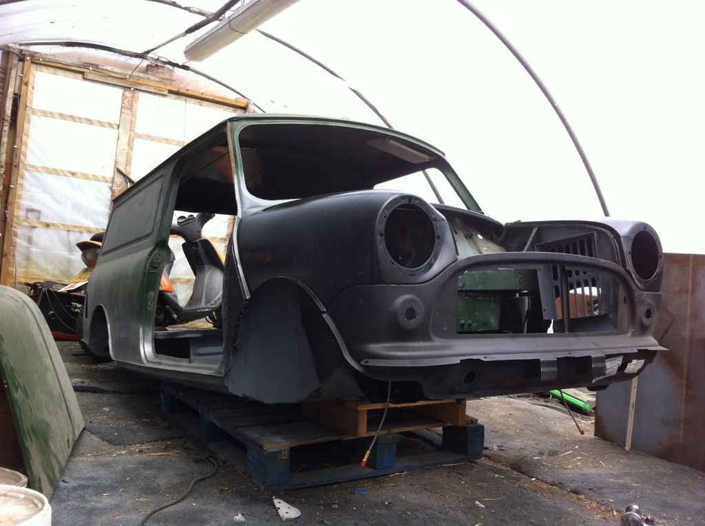

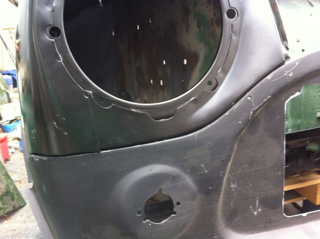

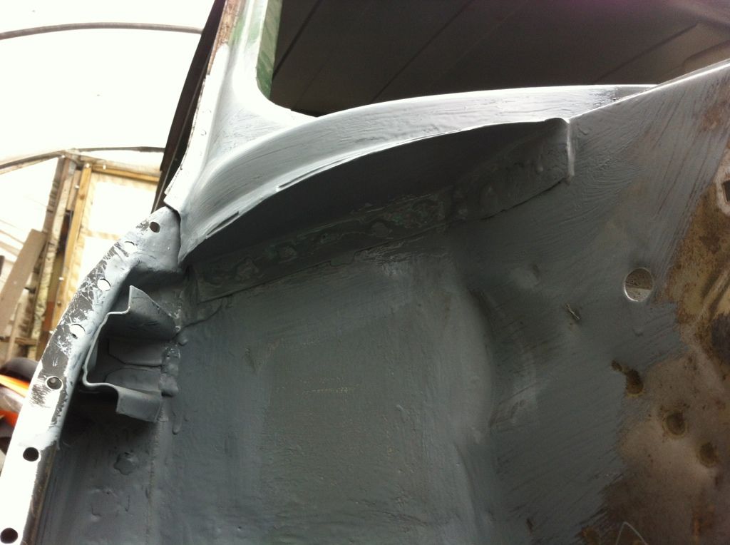

Posted 23 May 2013 - 04:17 PM
Today I have got quite alot done but haven't welded any of the front on as I want to make sure it's right! Measure twice cut once !
So to begin with I sorted the scuttle closers both sides! Believe it or not the non gen one fitted better
E320C5F3-772D-4E24-8F2C-DBFAD5A78FA3-315
BE54E191-2C95-496F-A445-8AD55D504098-315
Then I bolted the front panel on and tryed on the wings and bonnet ! I need a new bonnet!
ADF3B2E9-BF6C-4598-8AD9-FD8B253D3798-315
01474603-D3C6-4BC2-95DB-0EE5153EFF5F-315
Wing gap drivers side is perfect after some adjustment :D
7B88DF86-5E46-4ADA-9A87-311E09D7DCBE-315
Front is ok ish need to give the front panel edge a good going over with the hammer and dolly!
C2FFA140-8E18-47E2-B5C8-A225541119E1-315
I started the p/s will update tomorrow when I get the front panel welded on!
#356 grahama
grahama
  • 2,442 posts
  • Location: Warrington
Posted 23 May 2013 - 07:34 PM
Ryan,
keep missing your progress following the re jig of the forum.  Front end looks to have gone well,  nice gaps on the wing you have shown and front seam.   Before you get a new bonnet,  what are your side gaps and rear gap like??  The front gap to slam panel can be sorted using welded filler strips and a little filler to get it as you want.  A new / fleabay bonnet may fit no better,  just a thought !!
Good progress tho !

#357 ryan22_lgm
ryan22_lgm
  • 1,478 posts
Posted 23 May 2013 - 10:07 PM
Ryan,
Good progress tho !
Graham
Cheers mate! :)
I won't be gettin a new bonnet just yet it's just rusted along the front inner edge and fillered from the front! I will get a second hand genuine bonnet not one of the non gen odd fitting ones! I will be using the welding rod method to sort my door gaps out later on! I have done it before at work a few times :D
The side gaps are a bit tight and the back edge looks fine so I will make sure I get them correct before welding it up.
