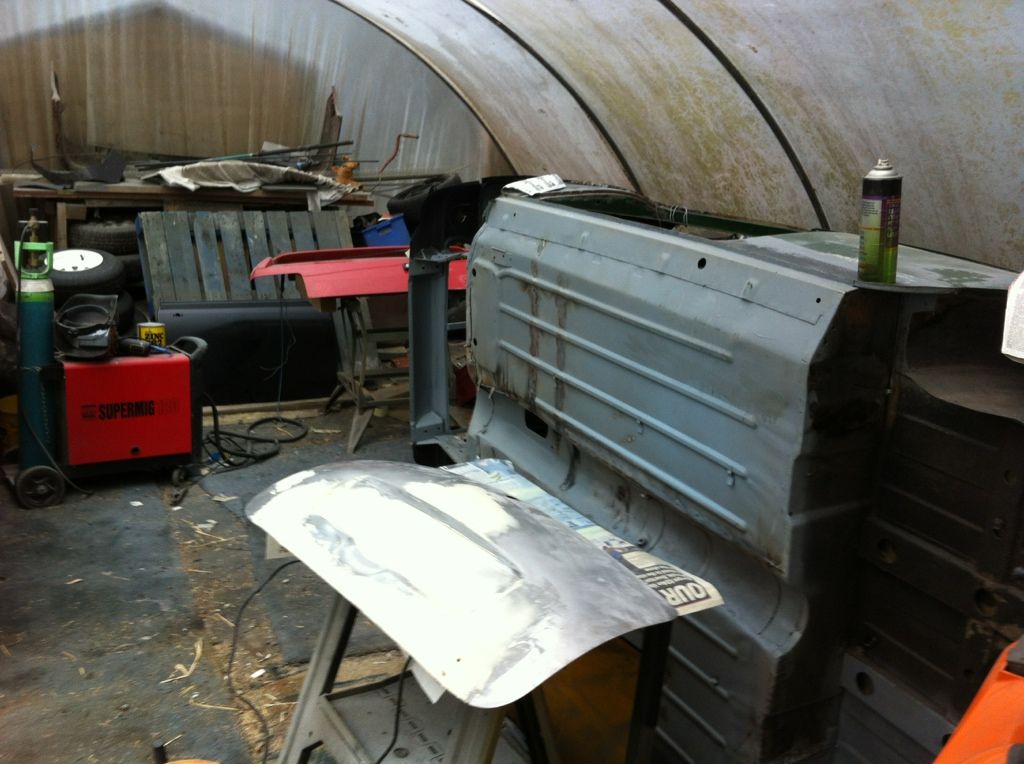

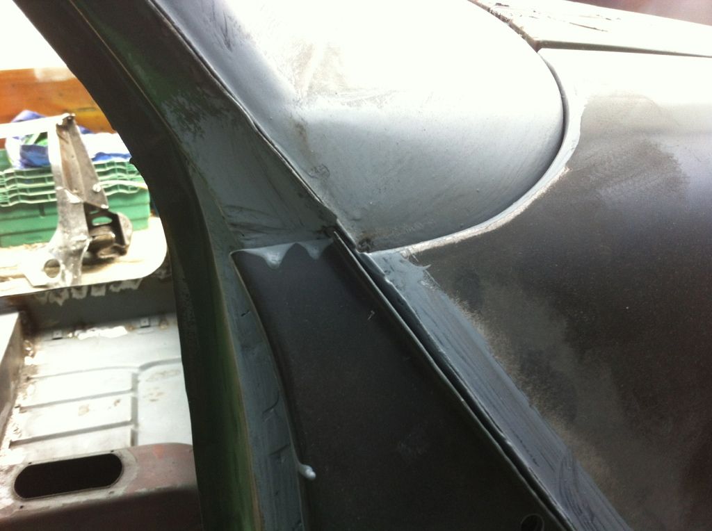

Grinded off the inner a today and got the mrs to give it a coat of 182 !
53C96ED4-AB90-451A-A32D-88743B19E044-109
And the inside of the a panel
A91FE01E-7181-4D9C-B6A8-FF6770EB1479-109
I still haven't sorted the p/s wing out but I will sort it later in the week!

God that first picture goes to show how crap my door frame / inner A really is!

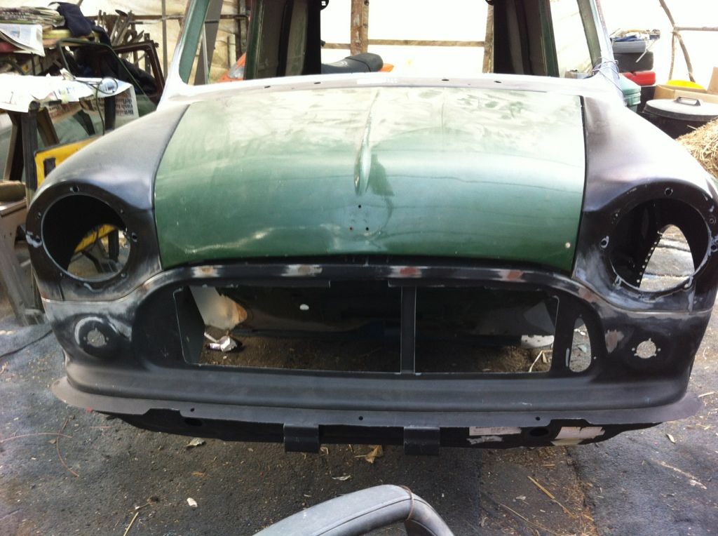

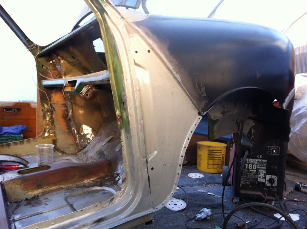

Mines not as good as it looks its made of weld :( but it will be fine!
Tight enough gaps for you lot :D
65231CB6-BC91-47DE-825E-F7BDB5A8B710-123
Note to self use genuine front panel next time ! I needed 4 pairs of hands to wrestle it into place each time I welded!
#379 minbin 69
minbin 69
  • 465 posts
  • Location: Reading
Posted 06 June 2013 - 10:28 AM
looking spot on as always mate :thumbsup:
but that gap is crap needs to be much tighter :lol:

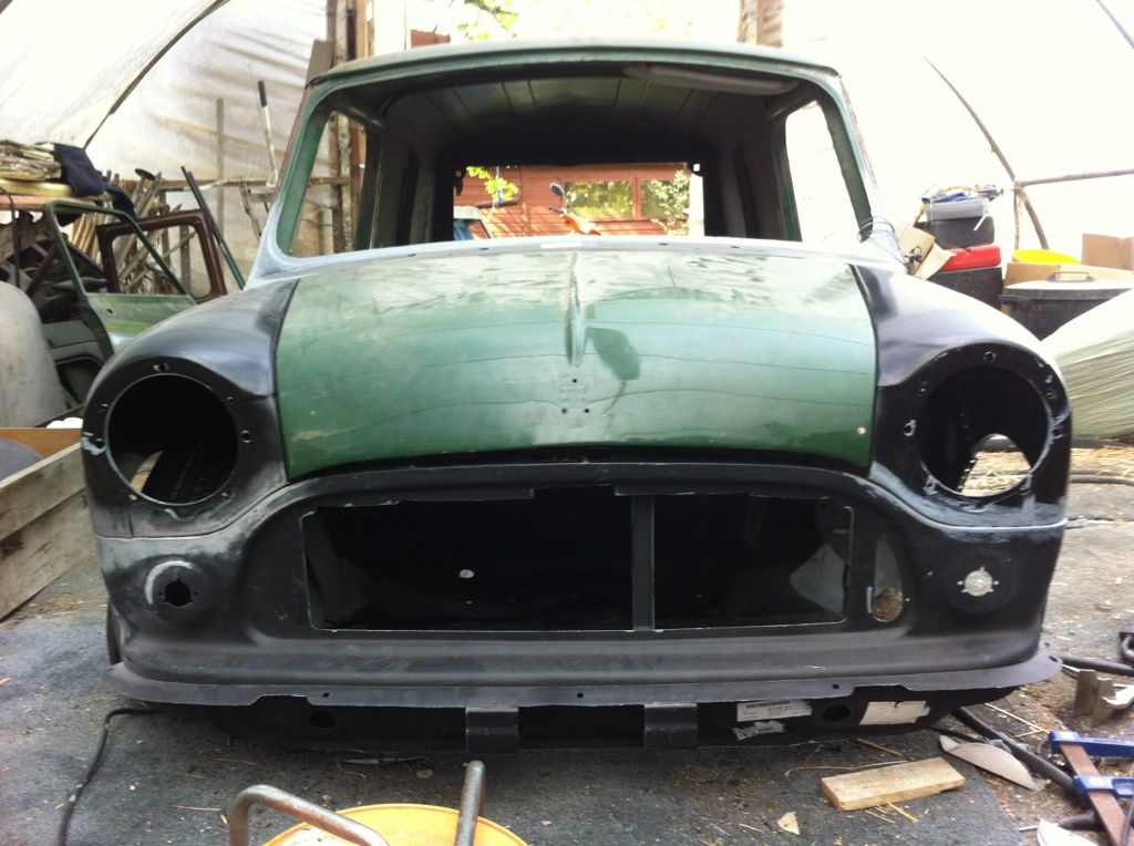

Looking good, I have to say that the genuine panels aren't much better. My wing was 1/4 inch higher than the bonnet is, and we know that the car is not accident damaged as it had the original front panel and inner wing.

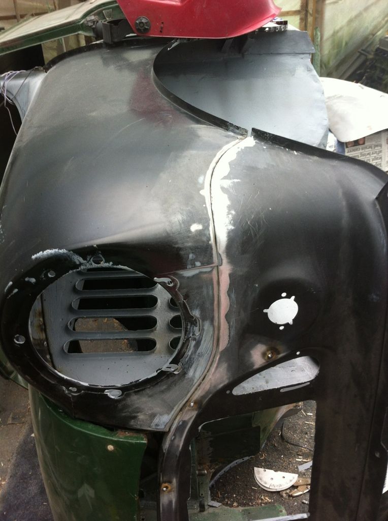

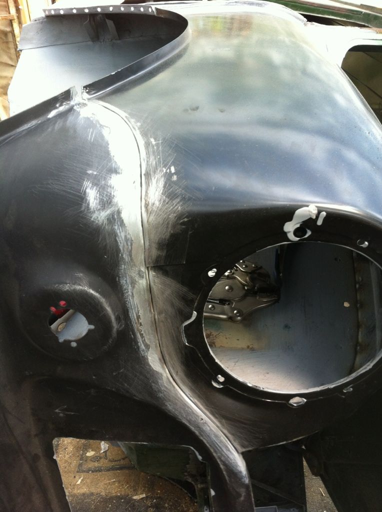

Welded the p/s wing on today still need to sort out the front panel join
F804FBEC-B5FD-4A9B-B7ED-5C9CEAD0F629-129
I'm pleased with the bonnet gaps!
A12EDC8E-0BEB-4CAB-85CA-38D558B36D45-129

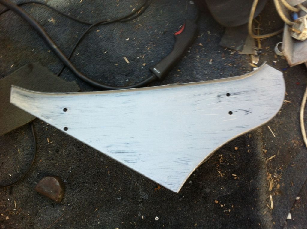

Converted another bootlid to mk1 for my gfs mini
05664E56-69DA-4DCE-8879-33E6090AD1C4-129
15232647-E426-4145-A66A-F01D0BF7E118-129
Yeh I have found they still require a lot of fettling to get them spot on. Maybe NOS austin/rover gen panels are better? See some on eBay from time to time

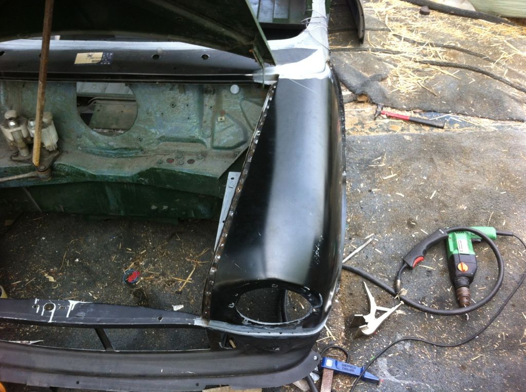

Haven't updated for a bit cause not much has changed! Tryed to sort the p/s wing to front panel seam but just could not get it as I want it :( will try tomorrow!
DD56D8CD-2C7C-4C98-B22A-E69A4910E470-161
This is how the place is looking! Other jobs getting in the way !

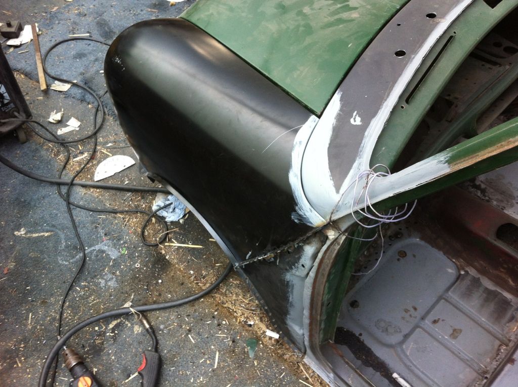

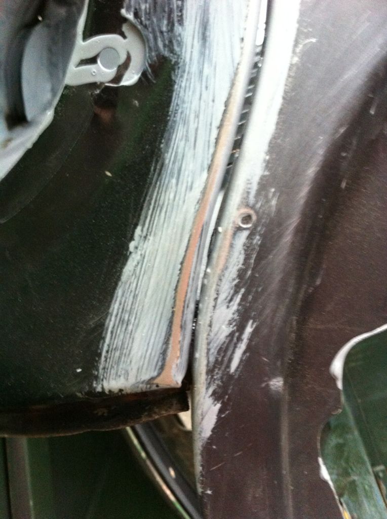

Sorted the p/s join out today!
DFFDF5A5-954F-4E73-BBB8-4BEA935A3EA7-176
That's better! :)
3230DA5B-CED5-4332-8EC0-59CE09C7D510-176
Right was about to start putting the d/s a panel on the I realised I don't know how they go at the top? Are they welded straight across or left and seam sealed?

You just run a seam of weld all the way along the top of the a-panel ryan, might be a good idea to trim the a-panel (height wise) down abit so your a-panel lines up with the wing seam
Looking progressive :D
