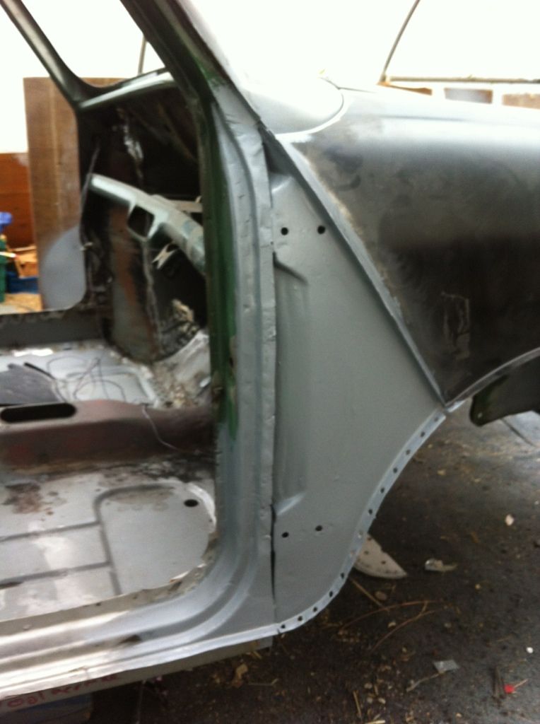

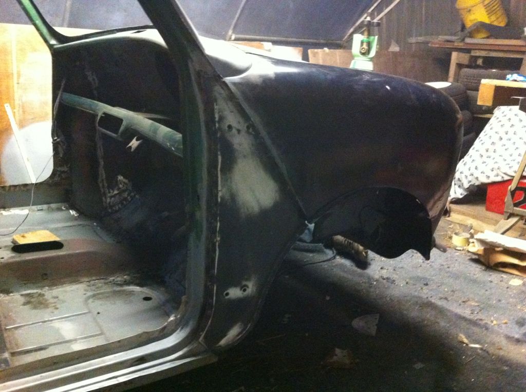

Update !!!!
Right got alot done !
Cleaned up and painted both inner a panels
F53C3446-6847-4369-AAA4-D193620B1F44-880
58EB47DA-00BA-4D52-8E42-D67116381035-880
D/s welded on!
F1C54192-F881-416E-82B1-EA0135048688-880

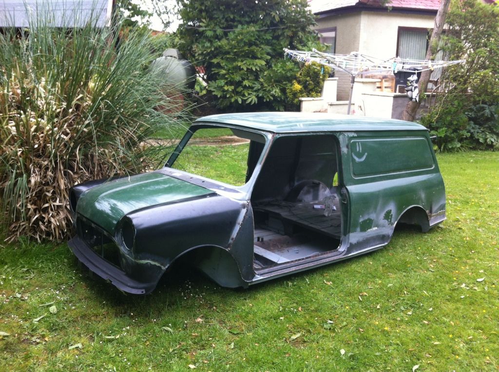

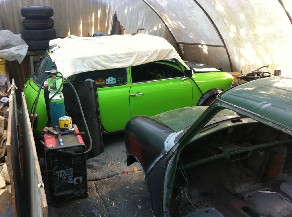

Then we decided we needed to put my other mini into the tunnel so the van had to come out!
8D752DCE-6C9C-42BB-93A5-182F154E899C-880
Gave it a blow off with the air line. Basically all the welding is completed now just got little bits of finnishing left. Like the drip rail p/s
Here it is removed
E8991E3B-1854-43D6-A5EB-64B14F9A86C6-880

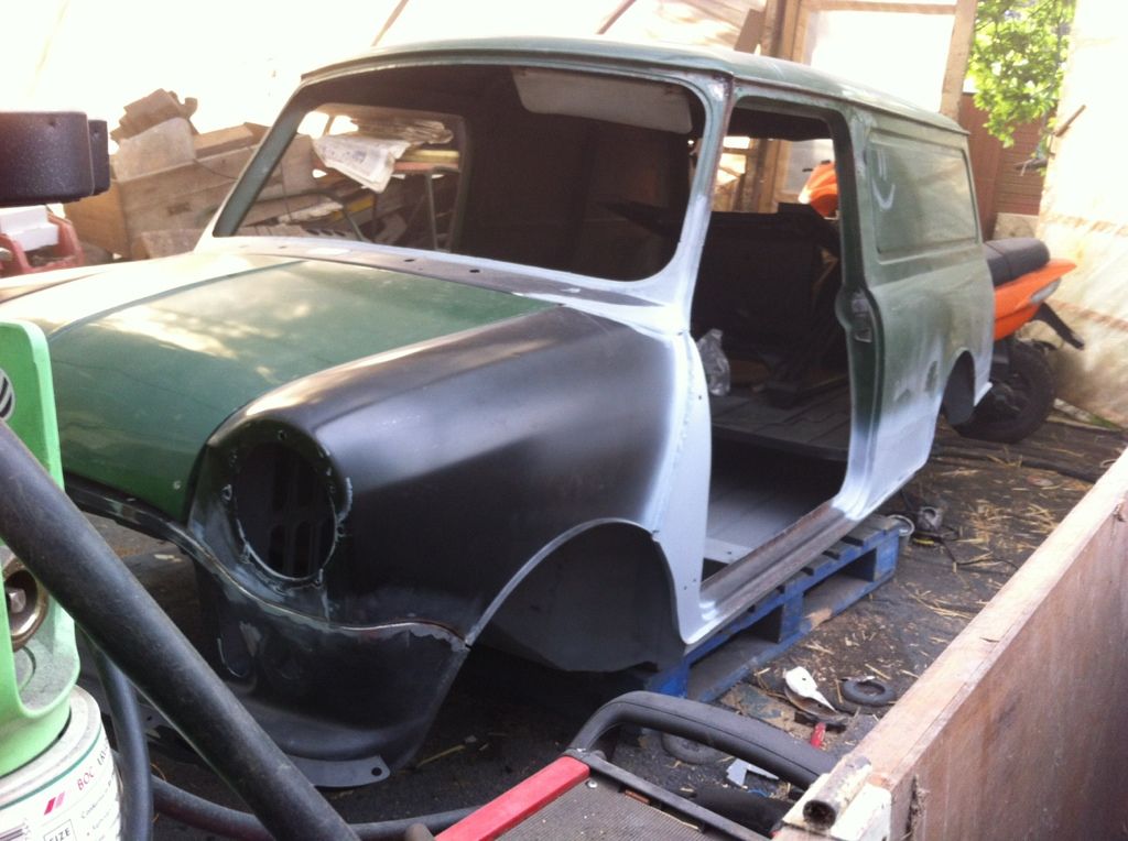

Friends forever

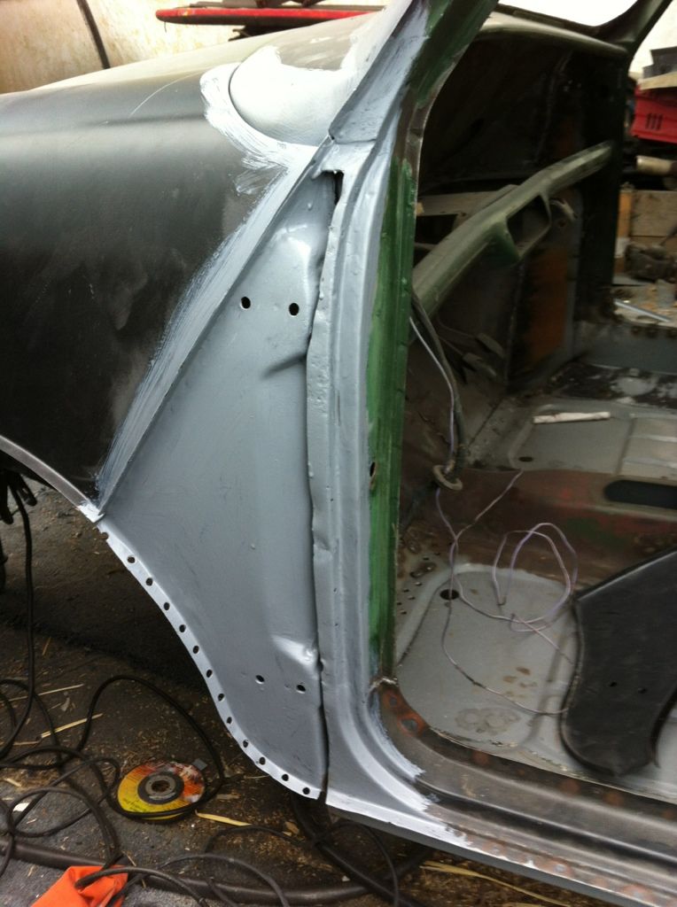

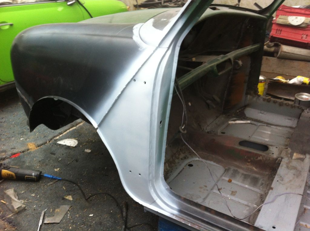

759E6466-8CC3-491E-B217-C5B48E800EDD-135
Cleaned all the welds up this side and etch primed it for now
33C50D0F-5373-410B-B25A-255AC8F8C055-135
Done the same with rear quarter and rear corner
62AD0565-3796-4B92-9C3B-4BD435E9F577-135
That's all folks!

nice work mate :) what's up with the bright green mini??? :/
