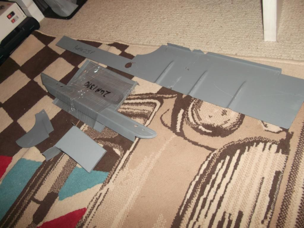

Right heres some more panels ! you would not believe that lot is £80 worth! the battery bracket was the worst !
Also can anyone get me a picture of how the battery bracket is attached to the floor as mine was never there so dont know how it goes! cheers!

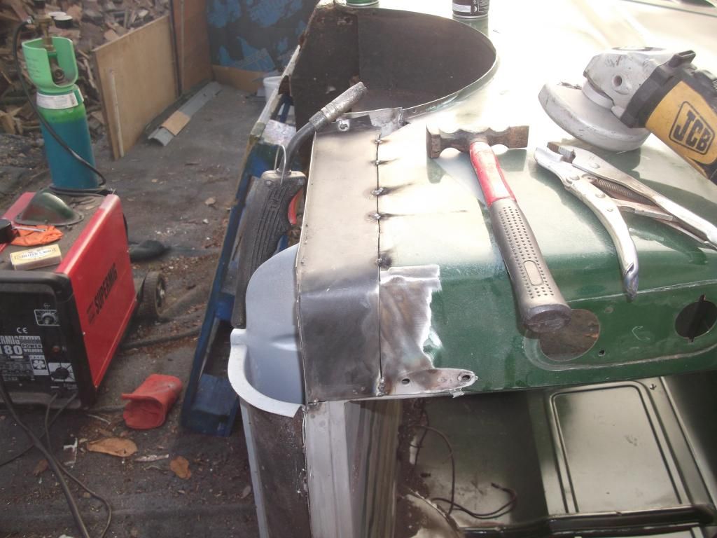

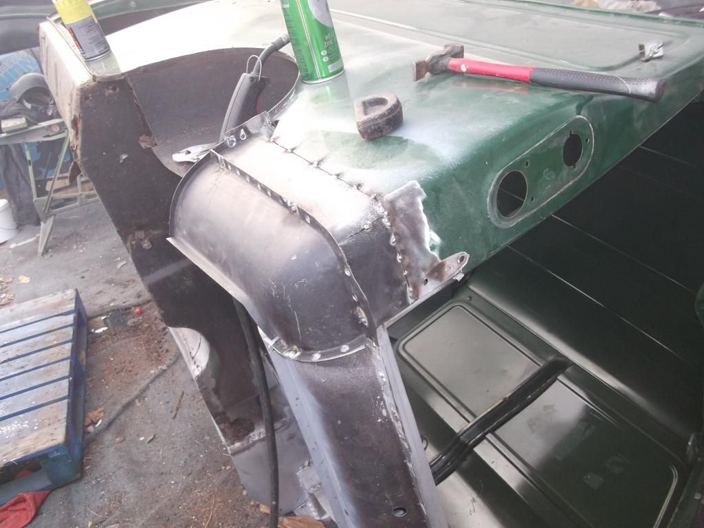

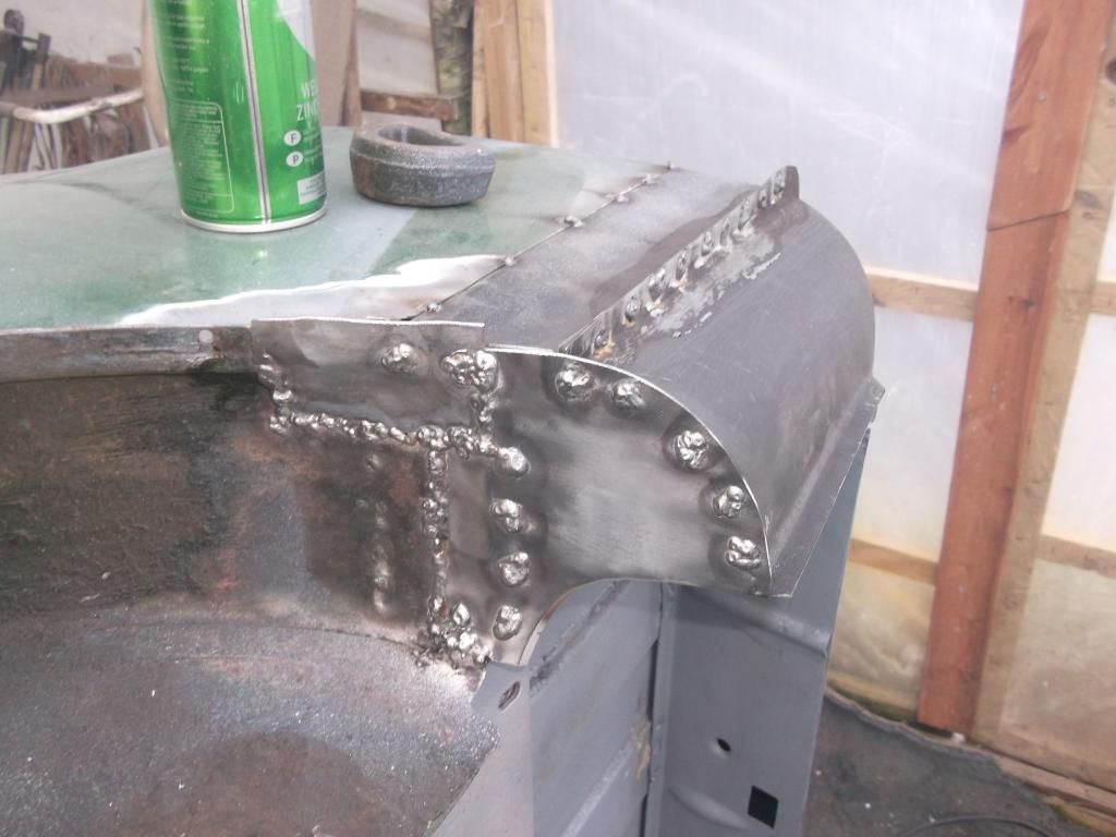

started tacking the passenger side corner repair on after fixing a patch of rust in the arch
had to cut a section out as these panels are not very well shaped

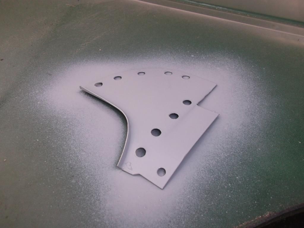

Drilled and 182ed the inside of the valence corner and got that welded on next as i am nearly empty on the gas :(

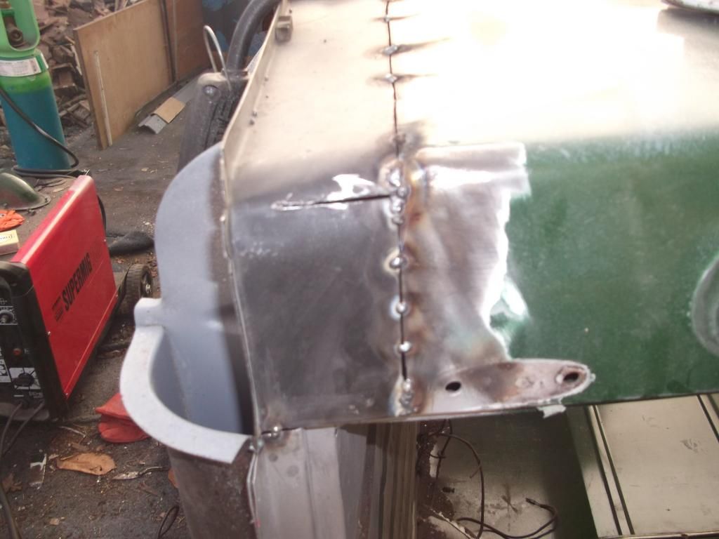

closing panel
arch looks a bit messy but will all grind down perfect! lol

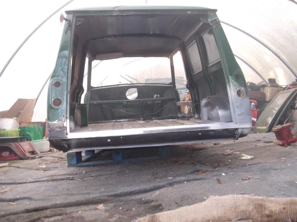

Rear end almost there! just gotta get some more gas and fill in between the tacks on the passenger side corner and then grind it all down! :D

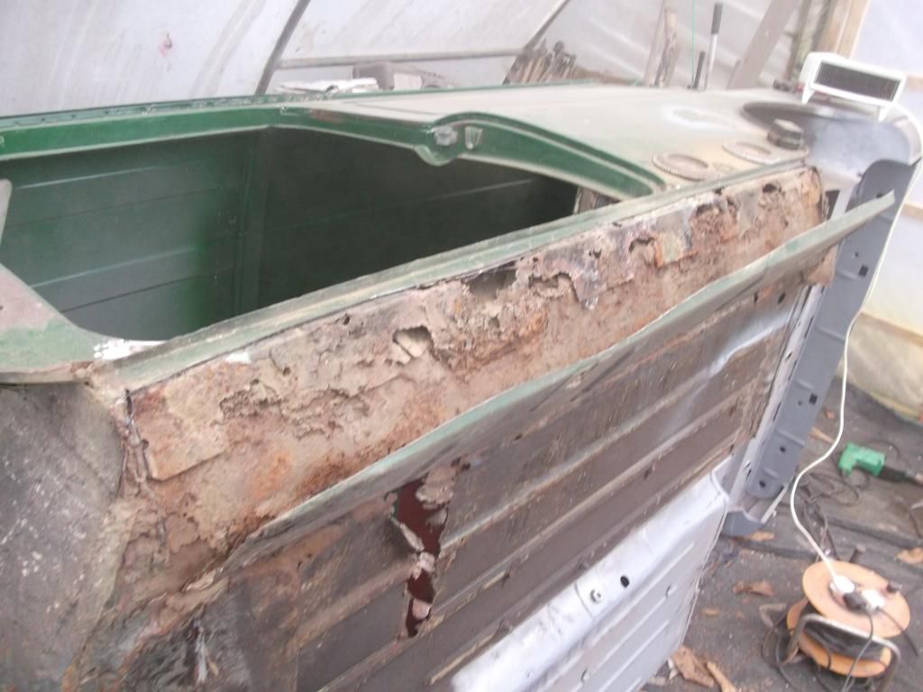

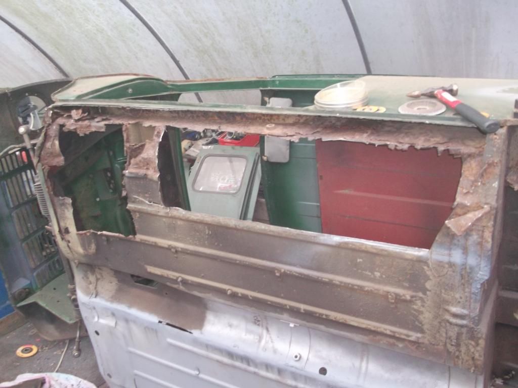

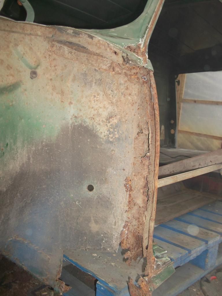

Well i looked at the van today and thought i wonder whats hiding under this very solid looking, expensive looking oversill (not!) And i got a nice surprise! the old sill was still under and this could of caused some noise as the shell flexes when being driven as it has been rubbing on the vented areas :(
The old sill basically crumbled off everywere...

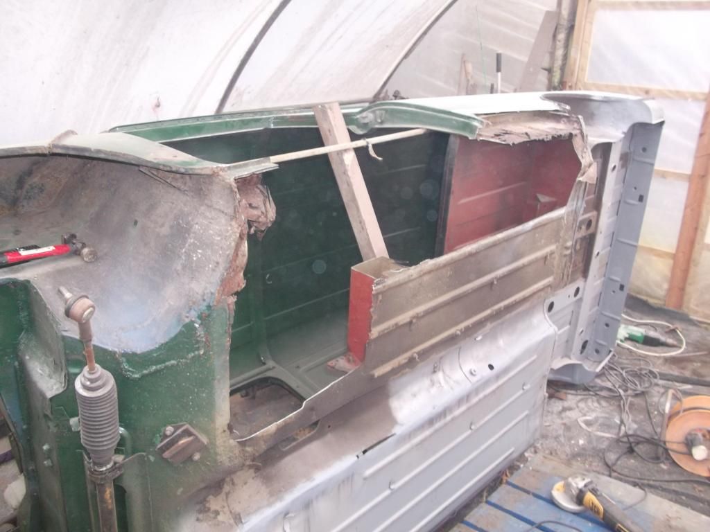

most of floor removed as you can see i will only be replacing half of the rear part as there is no rust there :)

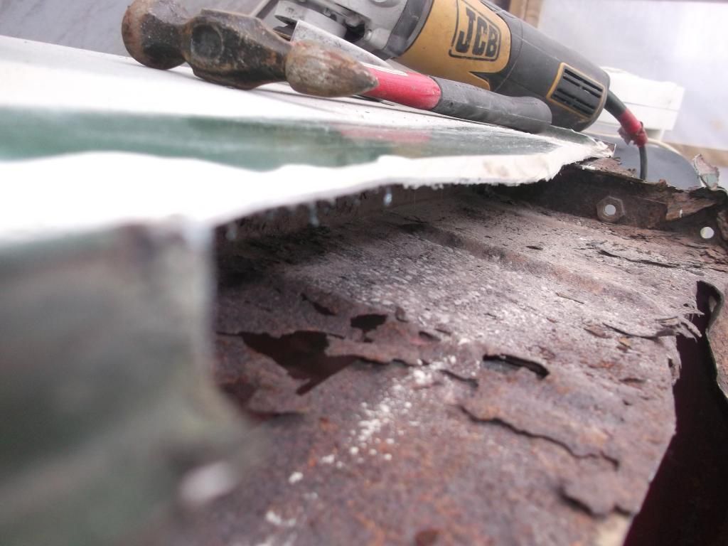

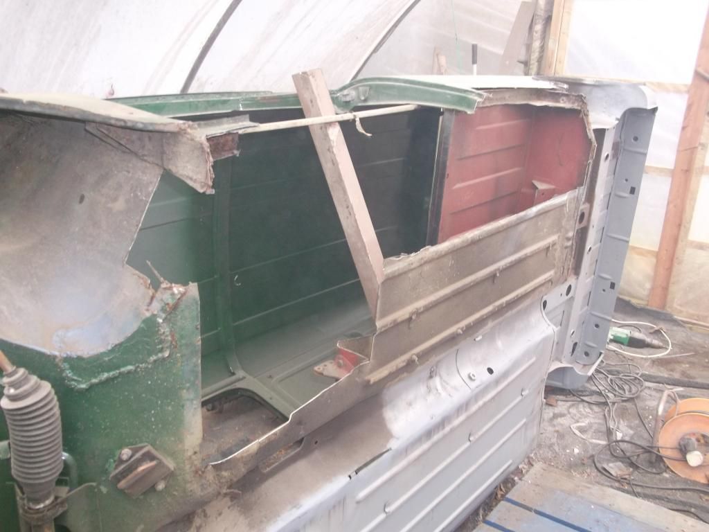

Bottom of rear quarter filler removed to find nice bodges
1cm thick ! i have now cut out this hole section !
So i have decided to replace the doorstep aswell as it has a few holes in it and would prefer them not to return! before i can do this i need to remove the rest of the front end but i have run out of cutting discs again so i will go to screwfix tomorrow. looks like both of the hinge panels need to be done so thats more panels required! :@ Will update tomorrow after i get some more cutting discs !

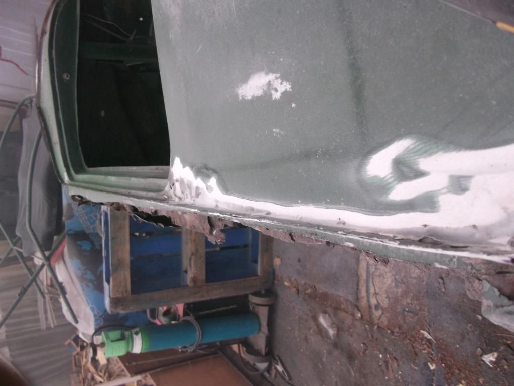

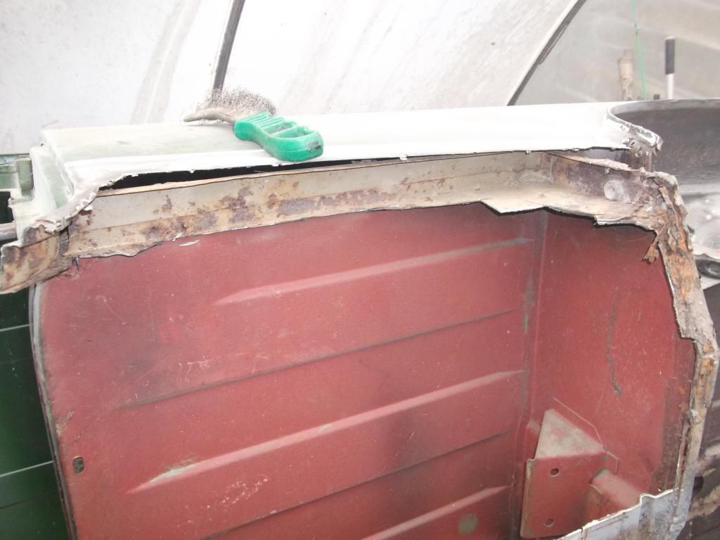

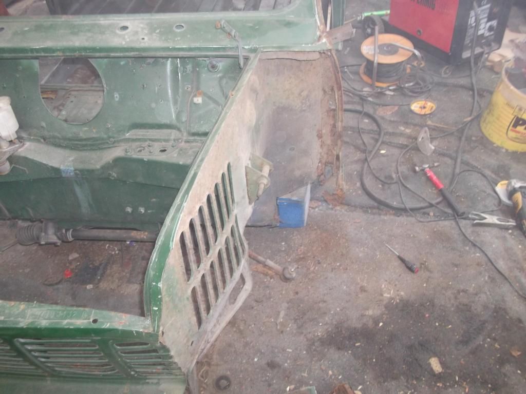

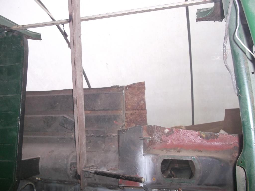

Done a bit more chopping today ! here are some pics :) The inner and outer a panel were held on with weak tack welds and the old inner panel was just hammered in so the new one would fit :/ bodgers!
obviously i braced it up before i cut the door step out ! :D
slightly better than the other side but the subframe mount area will still be changed as i dont want problems with this in the future!
Wing and A panel removed
