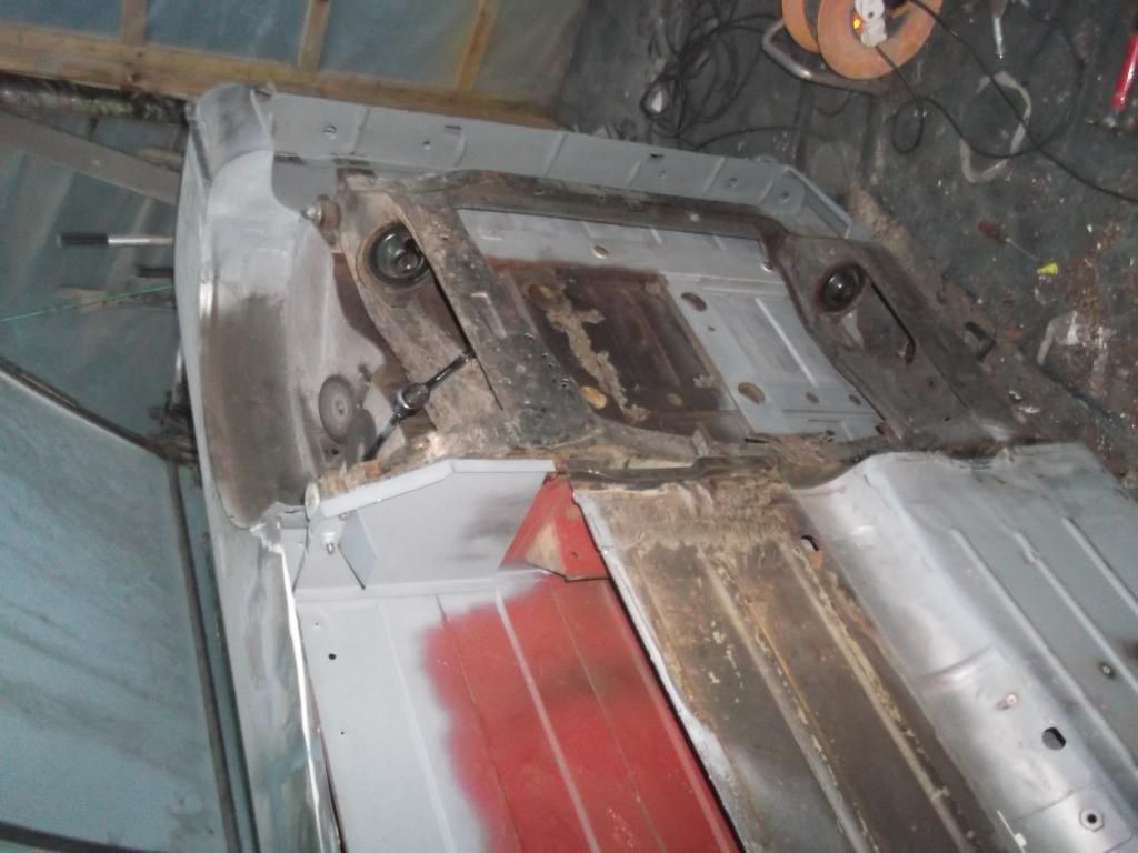

right then this afternoon i got of work early so i got a little bit done to the van. Removed the corner of the heelboard and the rest of the loadbay to inner sill stiffener. then cleaned it all up
bit of zinc !
zinc primed the new bit
then i struggled to get the subframe on and bolted the new piece on to mark were i would need to cut it :)
Also bit worried about the alignment of the subframe as it was very very hard to get the 3 corners to bolt up holes were at lease 5 mm out depending on what corner you done up first :s i know there isnt much flex in these old rubber bushes so will replace them and see if that helps
Edited by ryan22_lgm, 12 December 2012 - 07:44 PM.

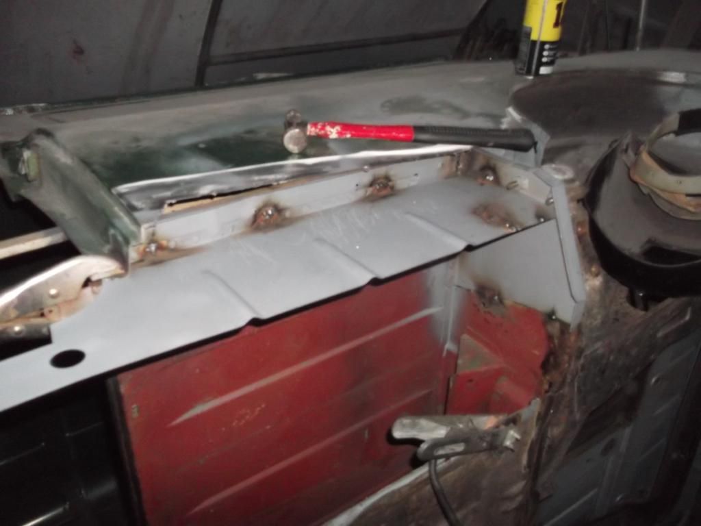

Slight update for you !
drilled and painted the stiffener panel ready to be welded on after i tacked the heel board repair panel on.
Clamped it in place
Started to weld in on but the welder is playing up and needs a new tip on the gun so i will get one tomorrow and Finnish off welding the heel board end and the stiffener.
