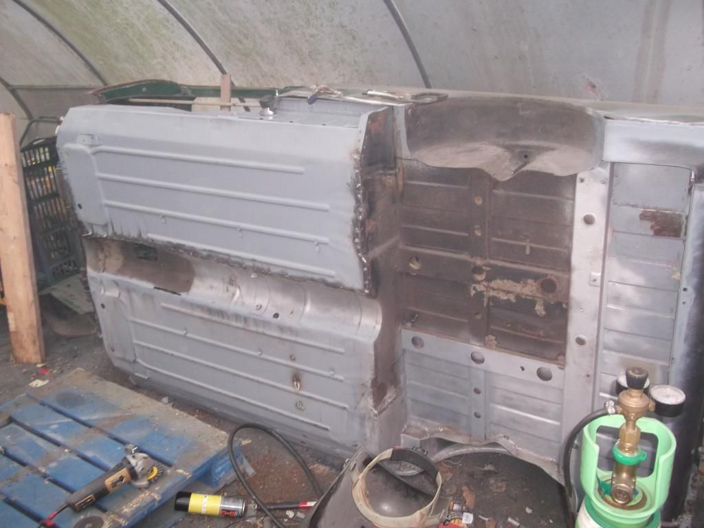

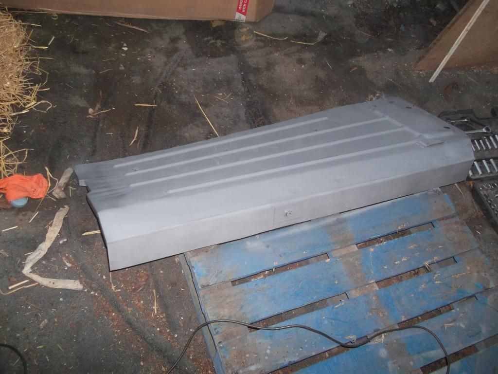

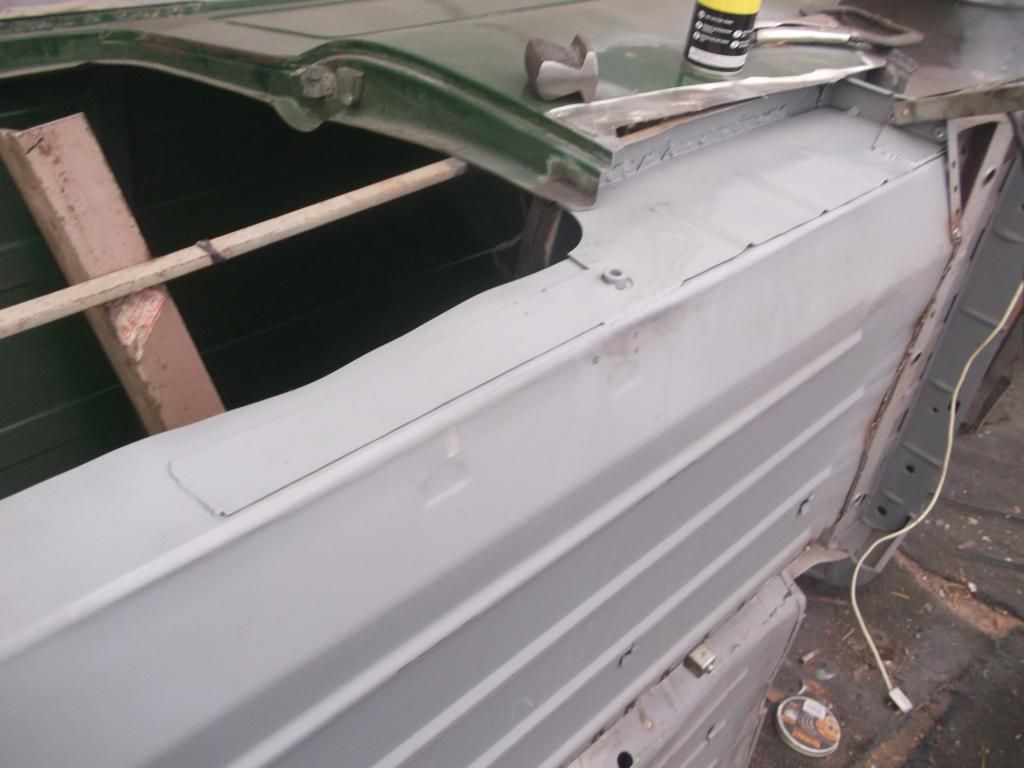

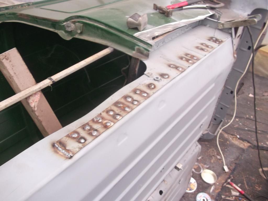

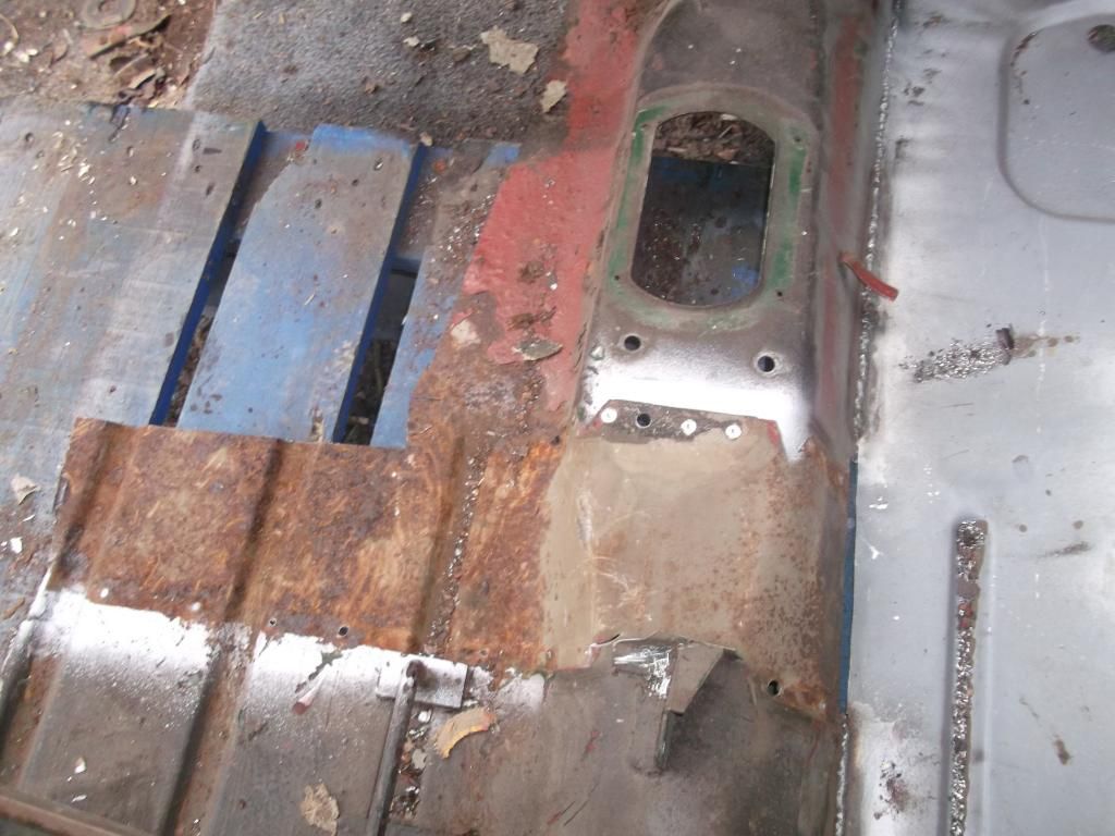

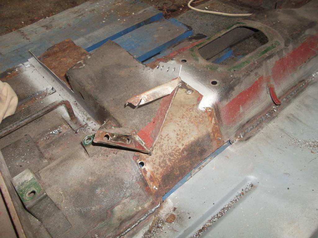

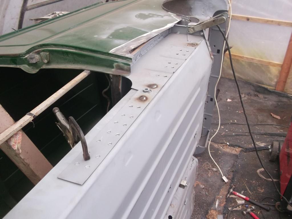

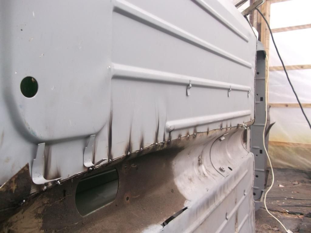

Right an update for you!
Been quite busy over xmas lots of time to spend on the van! and eating sweets!
So first i finished welding the heel board corner on an the drilled the floor to inner sill panel
Cleaned up the edges of the new floor and painted with 182
Removed the rest of the cross member
Then i got the floor clamped up and welded the strengthener panel to the inner sill
Double cut the bottom edge and tacked it all the way along
heel board edge welded up. i will fill in the gaps between the tacks tomorrow!

No messing there! Keep going, this is good stuff. I'm interested in those inner sill strengtheners. Are those 'optional extras' ? Or vitals? I dont't seem to have them on mine.
Cheers,
M
