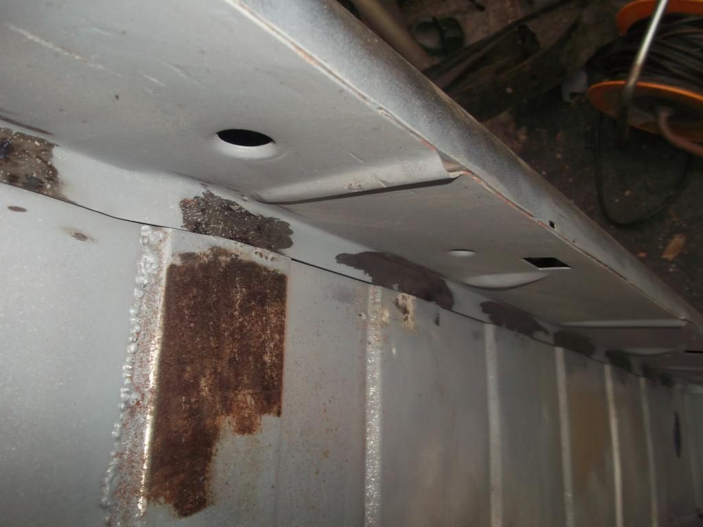

No messing there! Keep going, this is good stuff. I'm interested in those inner sill strengtheners. Are those 'optional extras' ? Or vitals? I dont't seem to have them on mine.
Cheers,
M
i think they are a vital panel as i removed the standard ones !
http://www.somerfordmini.co.uk/eshop/index.php?main_page=product_info&products_id=1328
If you didnt have them if you looked were the spare wheel goes there would be gaps between the load floor and inner sill

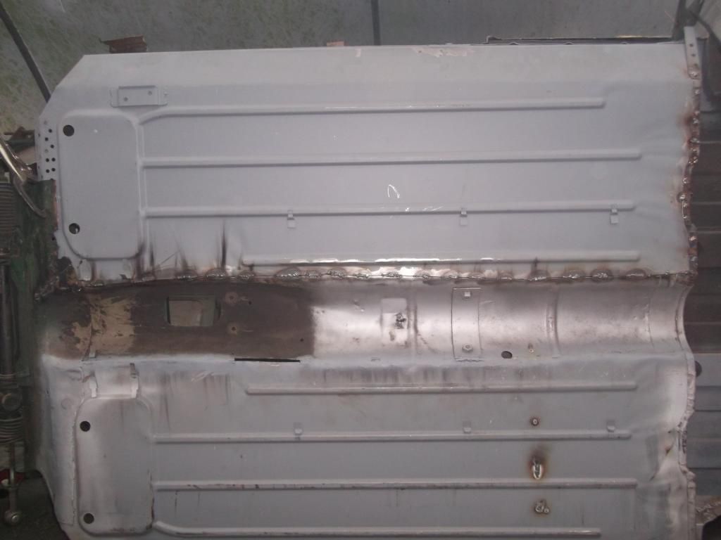

Done some more this afternoon !
Started with sweeping the carpet up ! well at least some of the bits of rust XD
Then i solved the problem with the welder and fixed it with welding wire :)
Cleaned up all the welds on the valence closing panel as these were getting on my nerves
Weld an inch,miss an inch, weld an inch, miss an inch and so on lol
And finally cleaned up the edge and primmed it up !

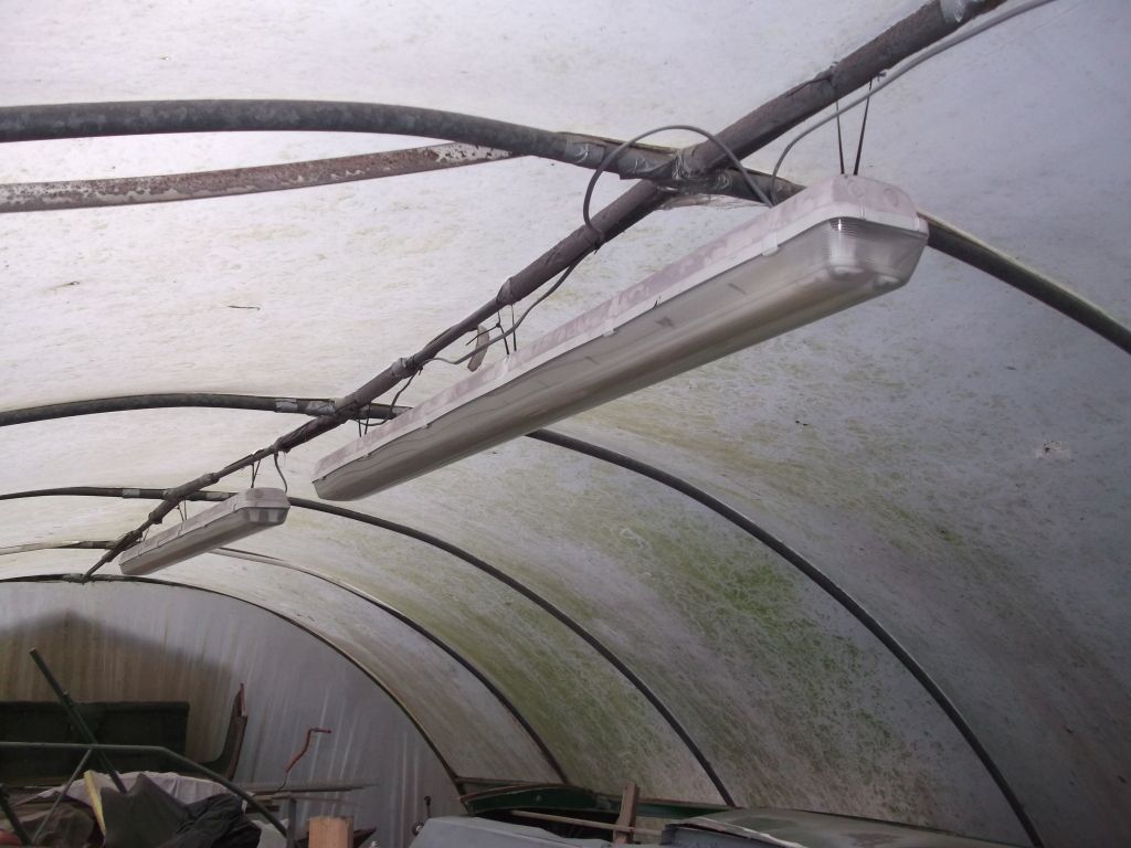

Couldn't get much done this week as i have been working every day ! but my dad has helped by putting some strip lights up so i can do all the grinding/ cleaning up in the evenings and welding when its light (extension lead cant run welder and lights)

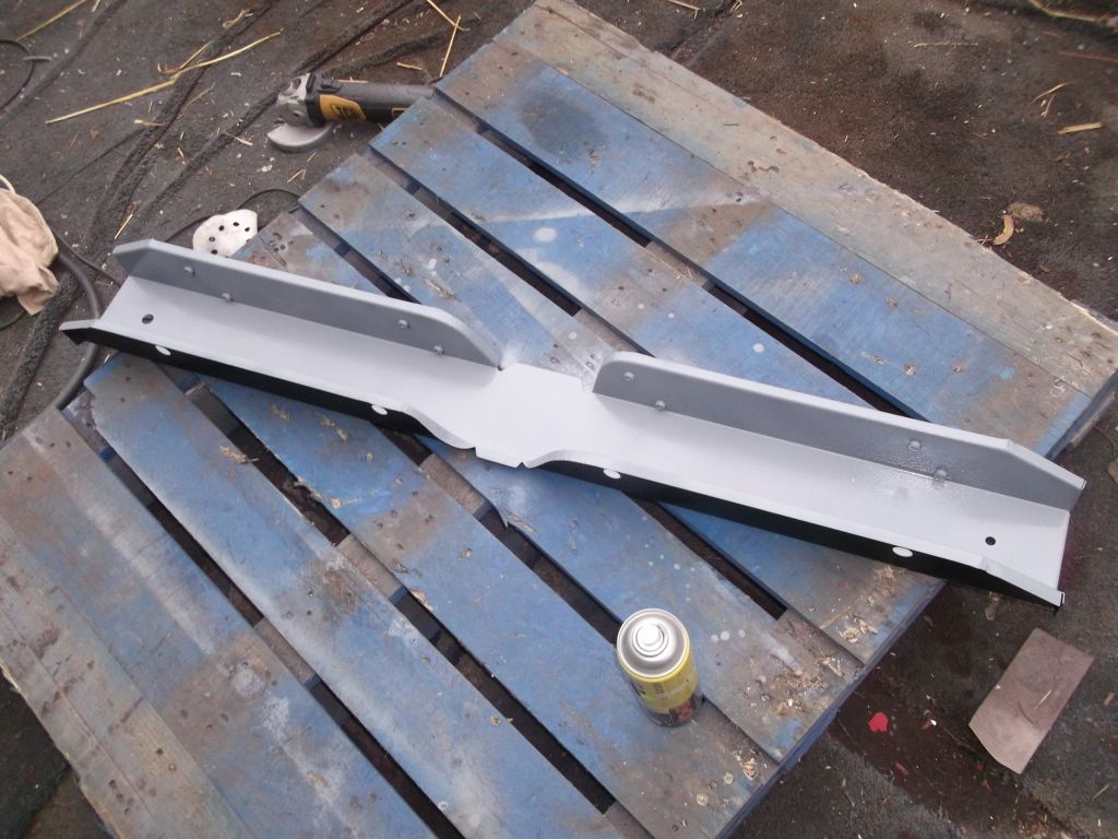

Also the cross member has just arrived so that will be fitted asap! :)

Got new crossmember today!
zinc primmed it up
New lights :)

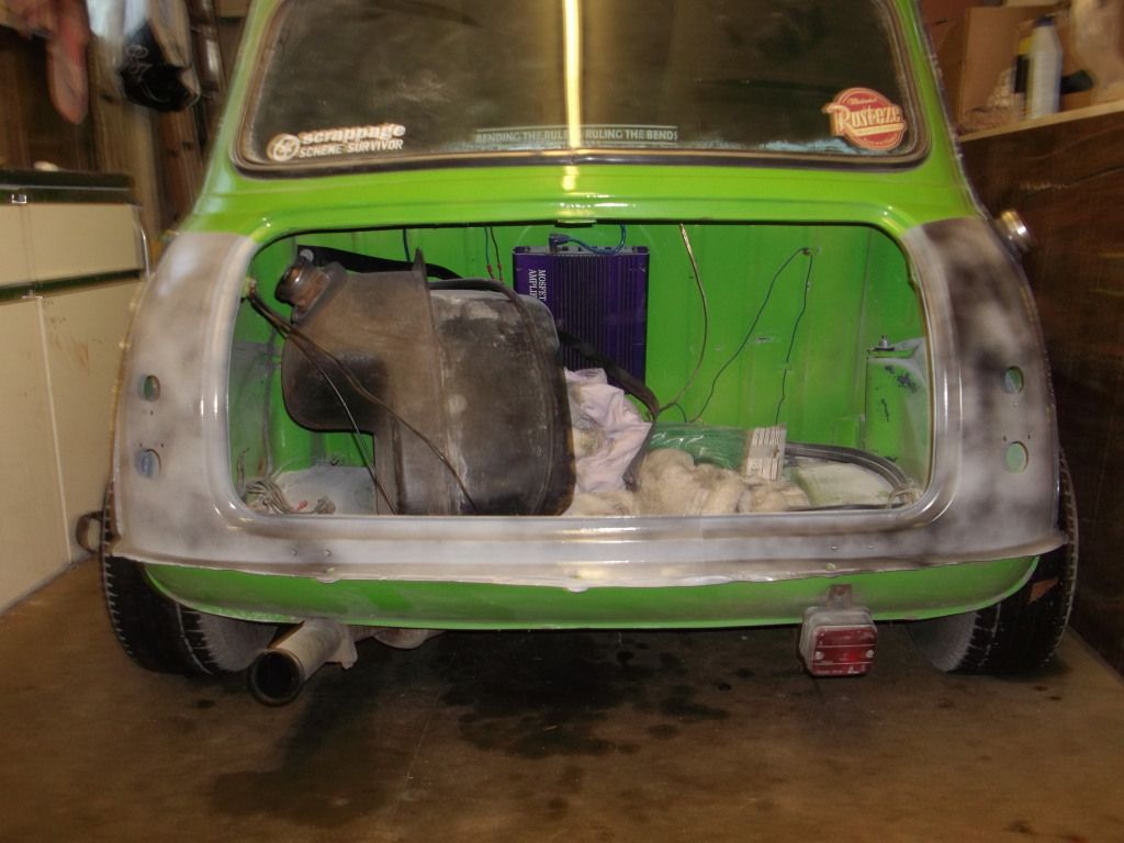

No updates for a while as i have been sorting out the bum of my daily driver!
primed both sides
rubbed down,painted, clear coat and put back together :)
i will get to work on the van now!
