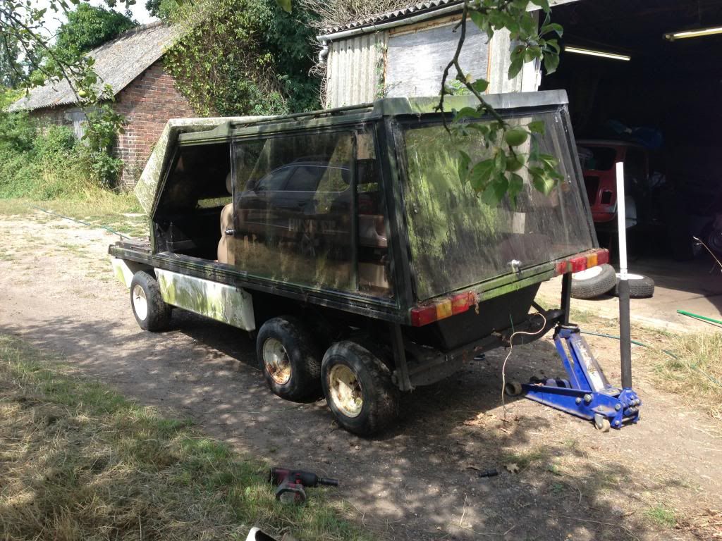

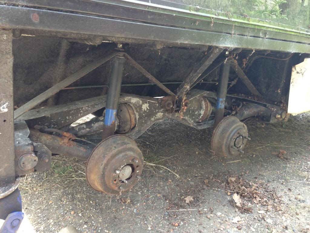

Something different to work on
Six wheel Hustler than Paul and his mate bought many moons ago, we are stripping out the galvanised subframes which Paul will be moving on. Very easy to work on i must say and a strange beastie.

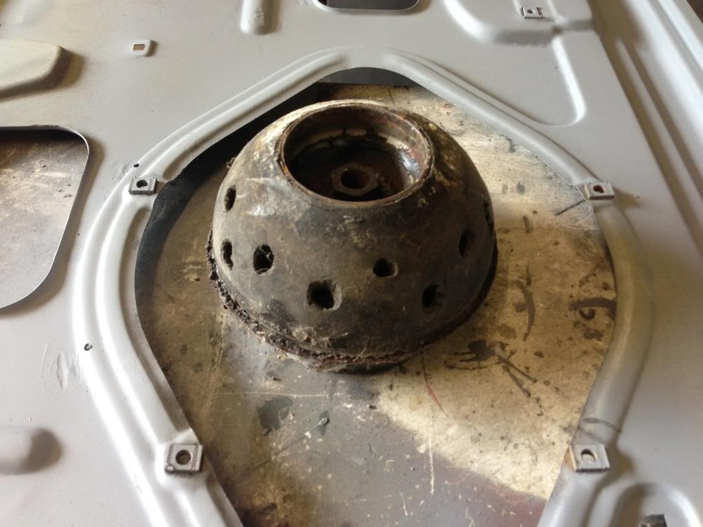

and modified cones
this was done apparently to soften the ride???

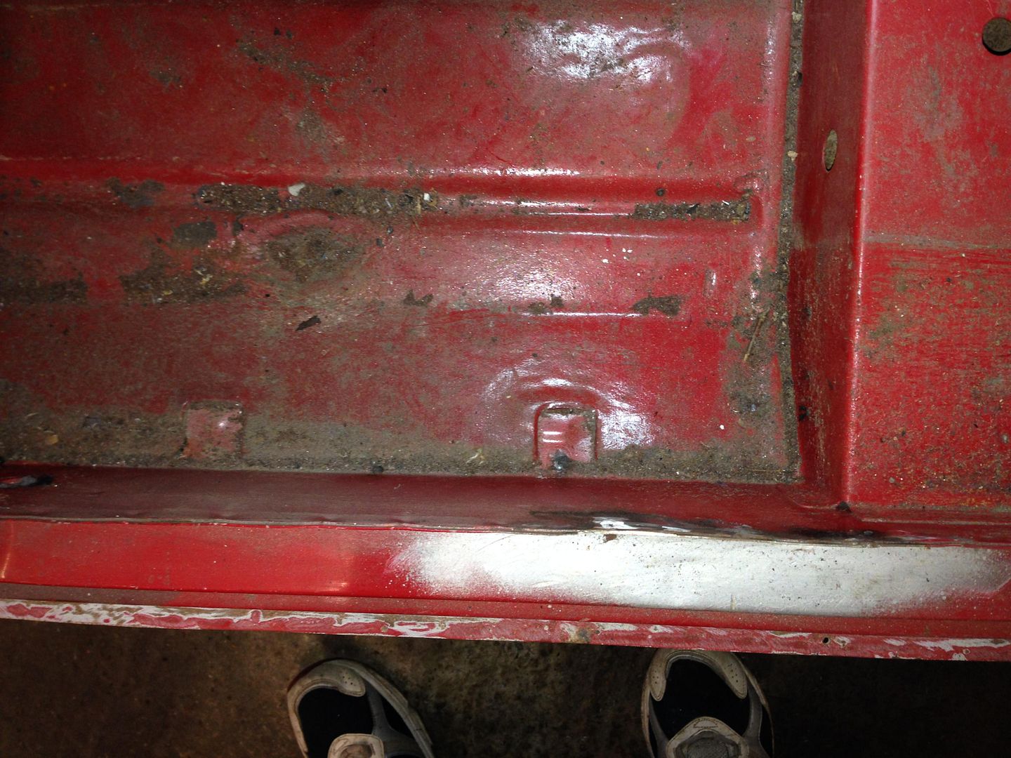

Back on the red one today with his crusty inner sills
Nothing to see here apart from my scabby trainers and i know i should be wearing work boots but i have issues with my arches hence why i'm wearing trainers.

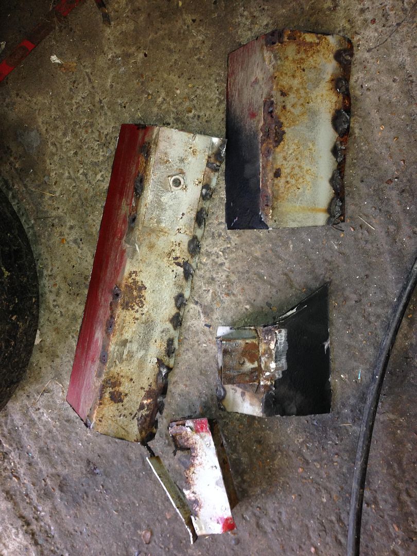

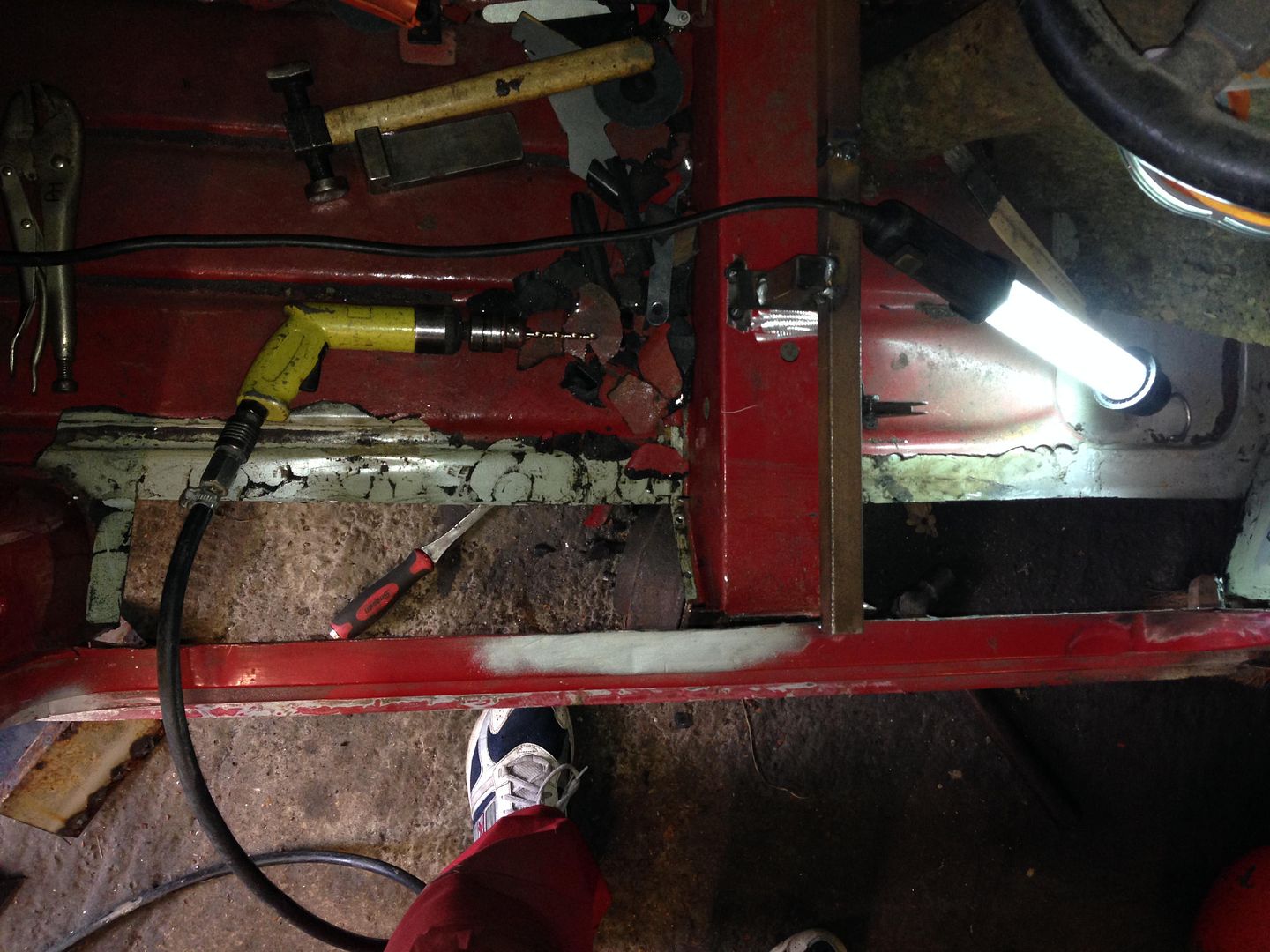

But this one is not so good

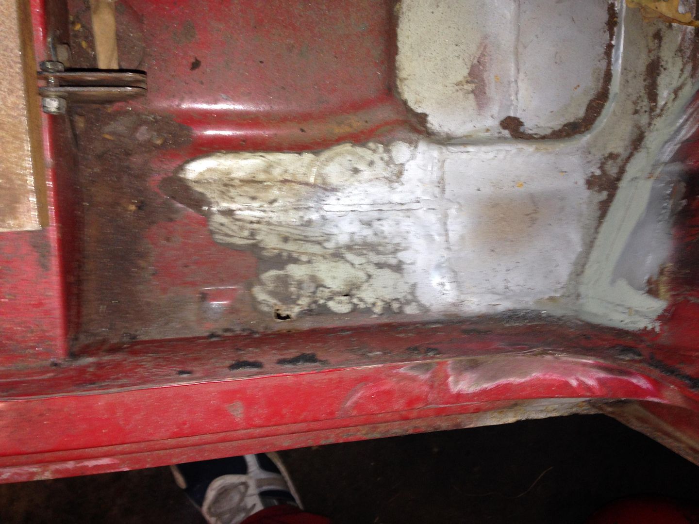

so half an hour later i was left with this
Rust lurking within the slinging bracket

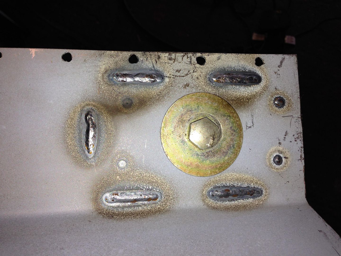

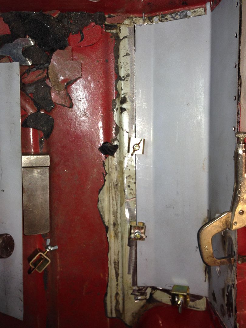

New inner sill sectio with the returns folded

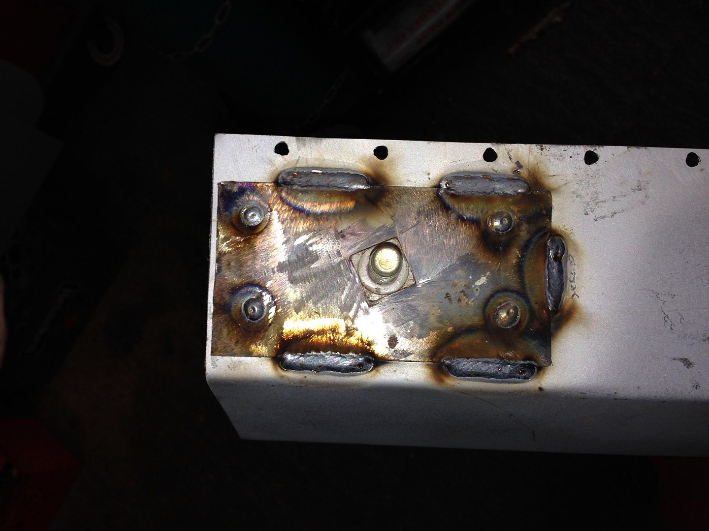

Seat belt attachment transferred over and welded in place
and then clamped in place
All ready to weld in tomorrow.

Nice to see some progress on the red one again
Got a similar repair to do on my passenger side inner sill so this will be a very useful guide.
Just out of interest is that a repair panel or have you fabricated it ??
Cheers Neil.

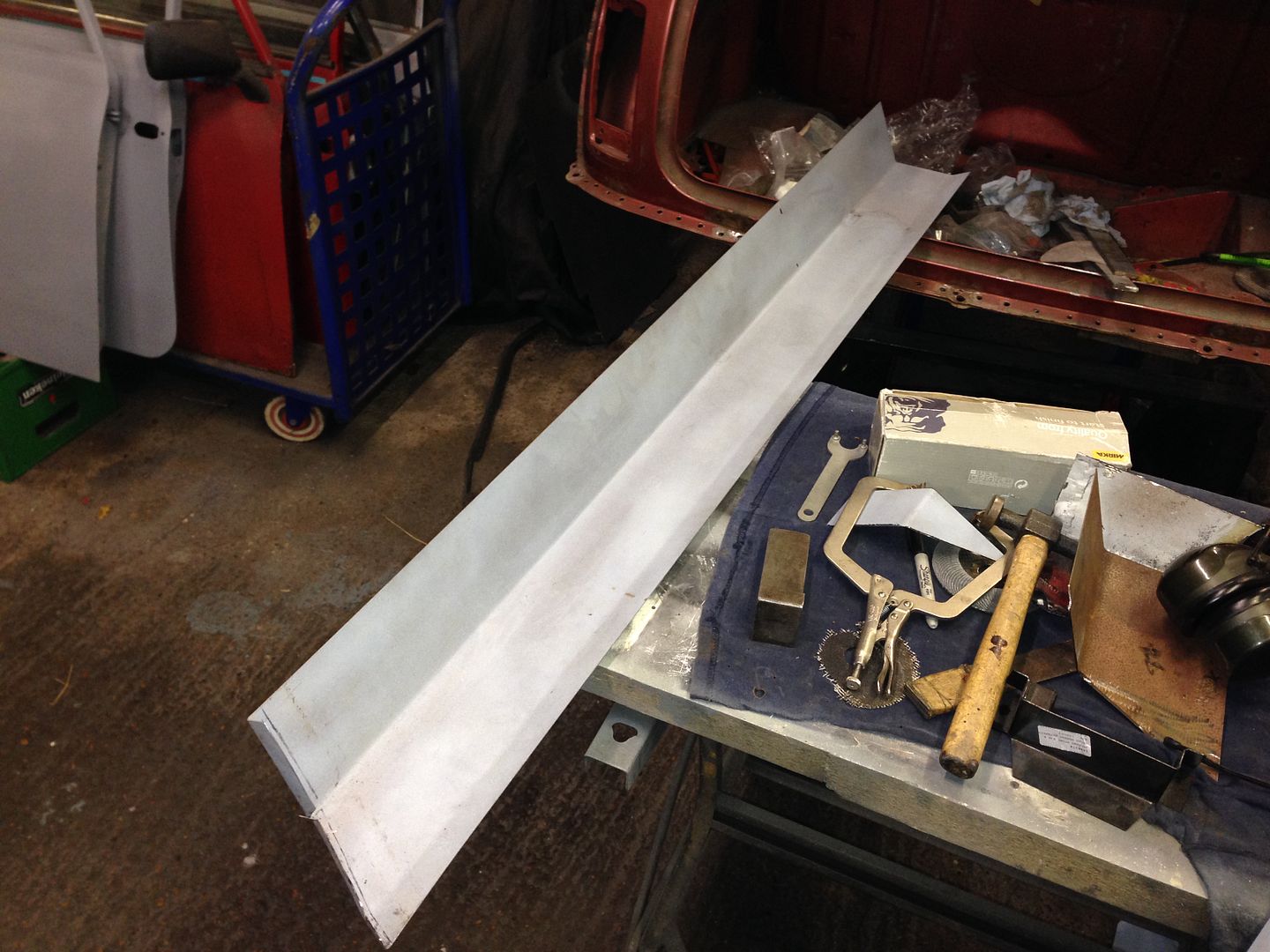

#60 sonikk4
sonikk4
    Twisted Paint Polisher!!!
  • 16,184 posts
  • Name: Neil
  • Location: Cotwolds.
Posted 23 October 2013 - 07:58 AM
Cheers Neil.
Marco these are fabricated. I normally fold these up at work but our folder is six inches short of a full inner sill. Alan the chap who I purchase my sheet steel from has a large machine / fabrication shop and a very large folder so he kindly did these for me. Also he is a serious mini man to boot which helps.
