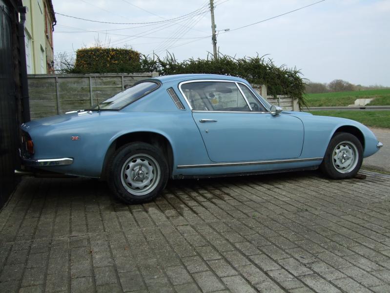

Yes I have the Lotus and 1 Mini. Which is not a lot for me.
The wife always had a Mini up until 5 years ago and I had at least one. The garage is a big double but its packed with Mini panels at the moment. If I want more Minis then I need a bigger garage.
