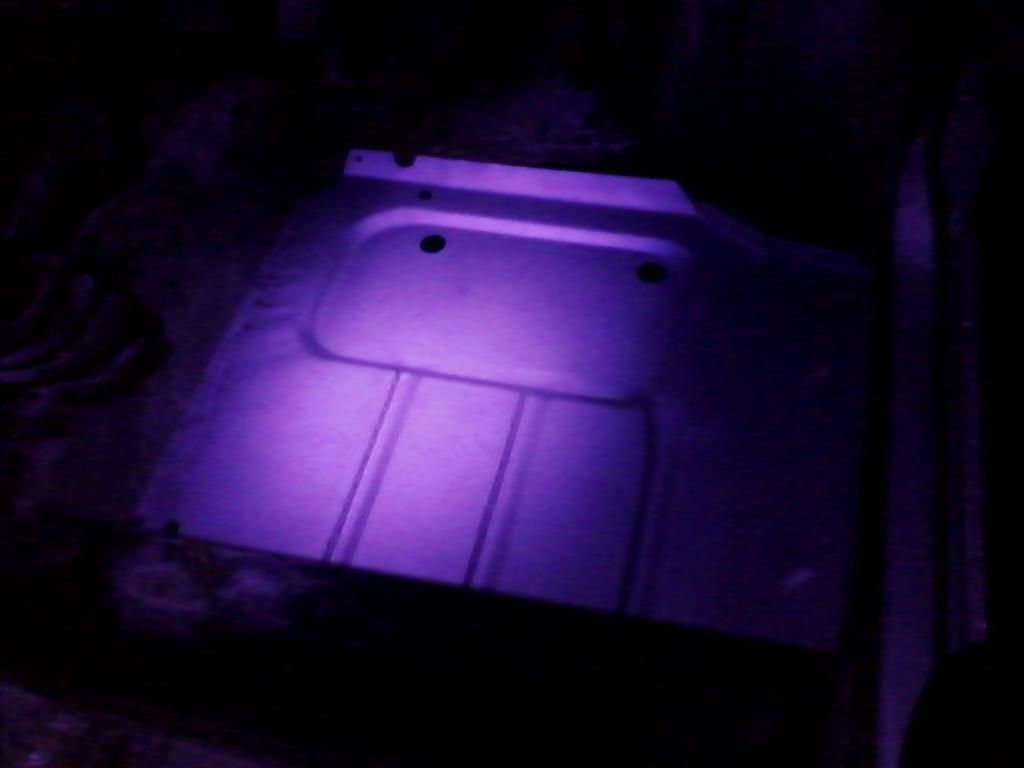

Well I got a bit more done tonight, the Floor Pan is now Zinc primed and ready to be welded in Friday hopefully. Or it may be that I have to do Toe board repairs if I'm unlucky Haha.
Cheers,
Cliff

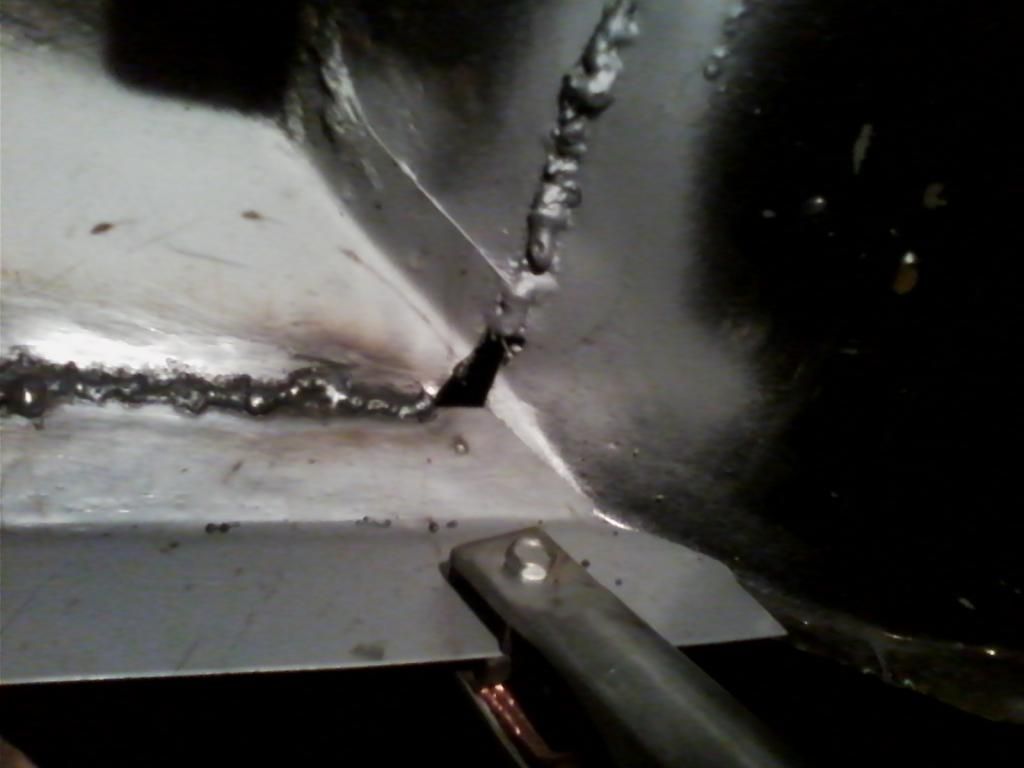

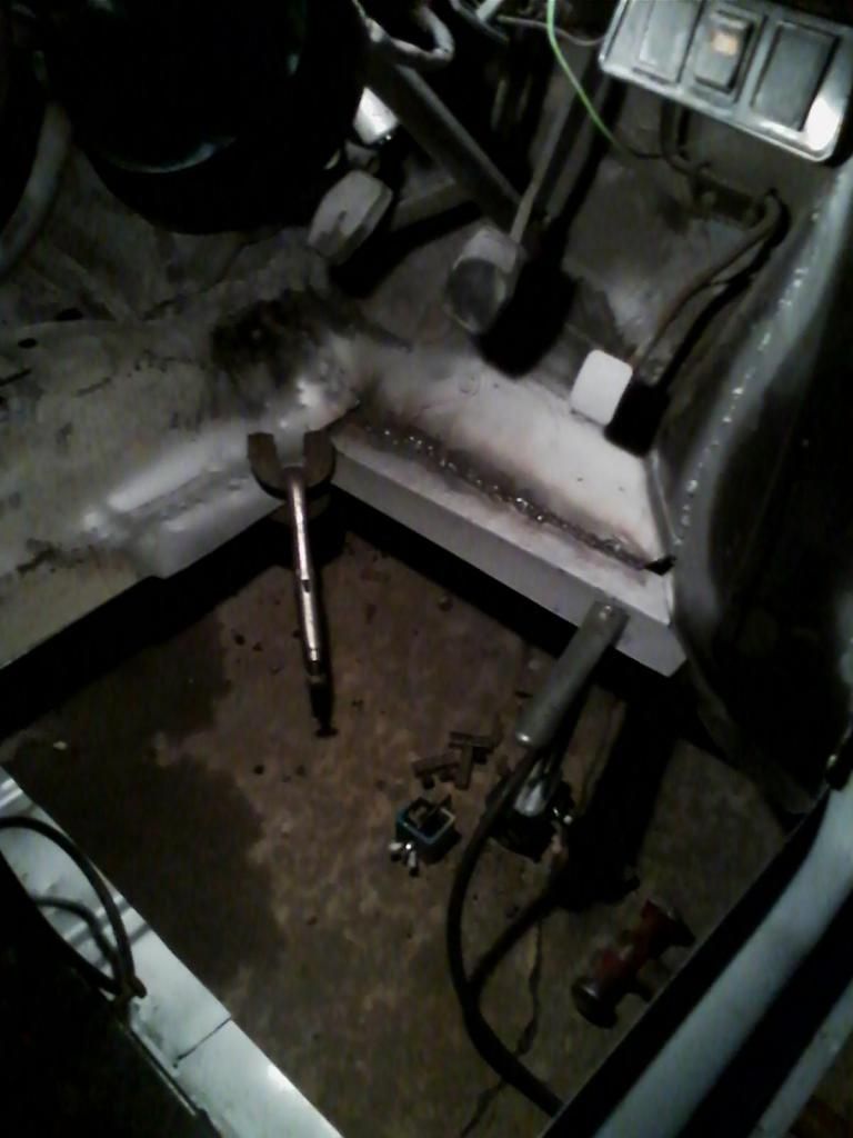

Well I wasn't too well today as a result of the weather. but I managed to pop out later on and get the floor pan trimmed and adjusted in certain places.
The bad news is the Toeboard, I'm afraid my concerns came to light (in the dark funnily enough!), and the toeboard had rot about 1.5inch up it.
So here are some more terrible camera pictures!
Cliff

Oh well, that won't take you 5 mins to knock up a toeboard repair mate!

No not at all, but it's one more thing to doo isn't it.
I couldn't carry on tonight because I ran out of day light, and also had to cut out the bracing as there isn't much room even now to get in with the grinder (without having the usual face full of sparks!)

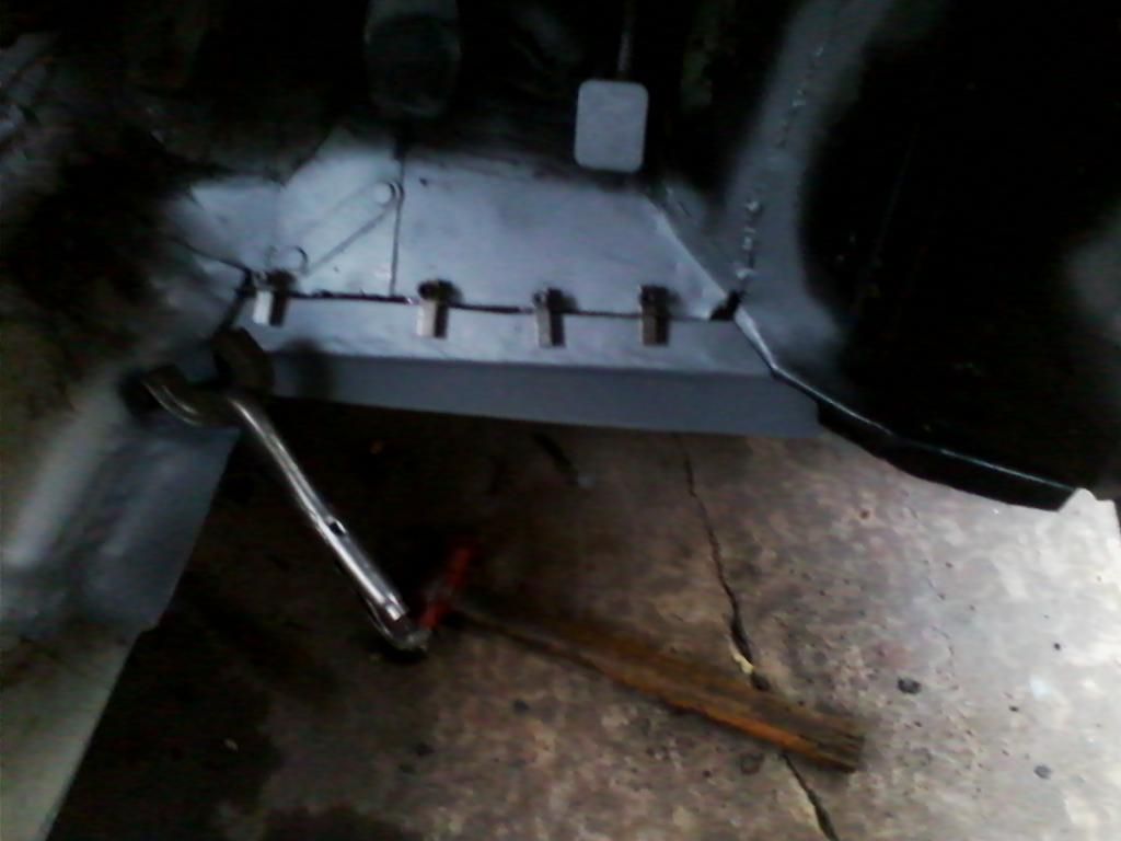

Have got the Toe board repair piece made up toady and ready to grind down the welds tomorrow, unfortunately my welding isn't great due to a dicky welding reel and being a little out of practice.
As you can see it's far from great, but It does it's job :)
Cliff
