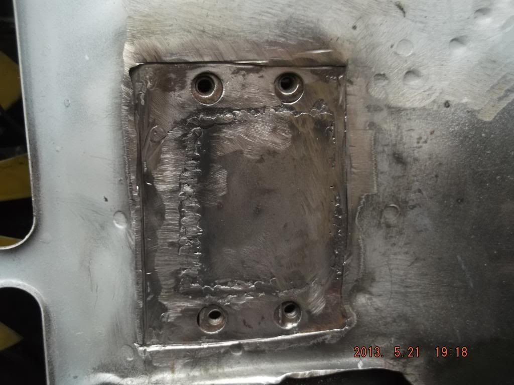

today i did a bit on the shocker mount as planned and have cut the outer plate ready for welding in another day.
So heres what i started with:
Cut back to see.... O_O :
Made and magneticaly positioned ;D  repair piece:
Welded in :
And zinc primed:
So inner repair done, awiting spare time to weld in the other..

Couldn't use my panel clamps as i wouldn't be able to get the thing off as theres a square pin on one side :/

Yeah it worked, i normaly use the magnet out of a car speaker i butchered for but panel clamps level out the repair piece to the shell so when i grind back the welds it more or less blends in.

Yes but not as id like, panel clamps put pressure either side as you tighten them up and force the panel up level, also something worth noting for everyone is that large magnets on small repairs (close to your welding) make the weld spatter so probably creates a crap/un-safe weld so best to avoid that :proud: .

I,ve almost finished off welding the final shocker mount repair piece in:
90% welded in and zinc primed for tonight:
Then i re-found this:
Then this happened O_O :
Then this happened too, the bonnet grew teeth  O_O :
Thankyou for viewing todays/a couple of hours work, next task i'l finish removing the bonnet lip then prime surface, start (finaly) on prepping the area for the flitch repair to be welded in.
