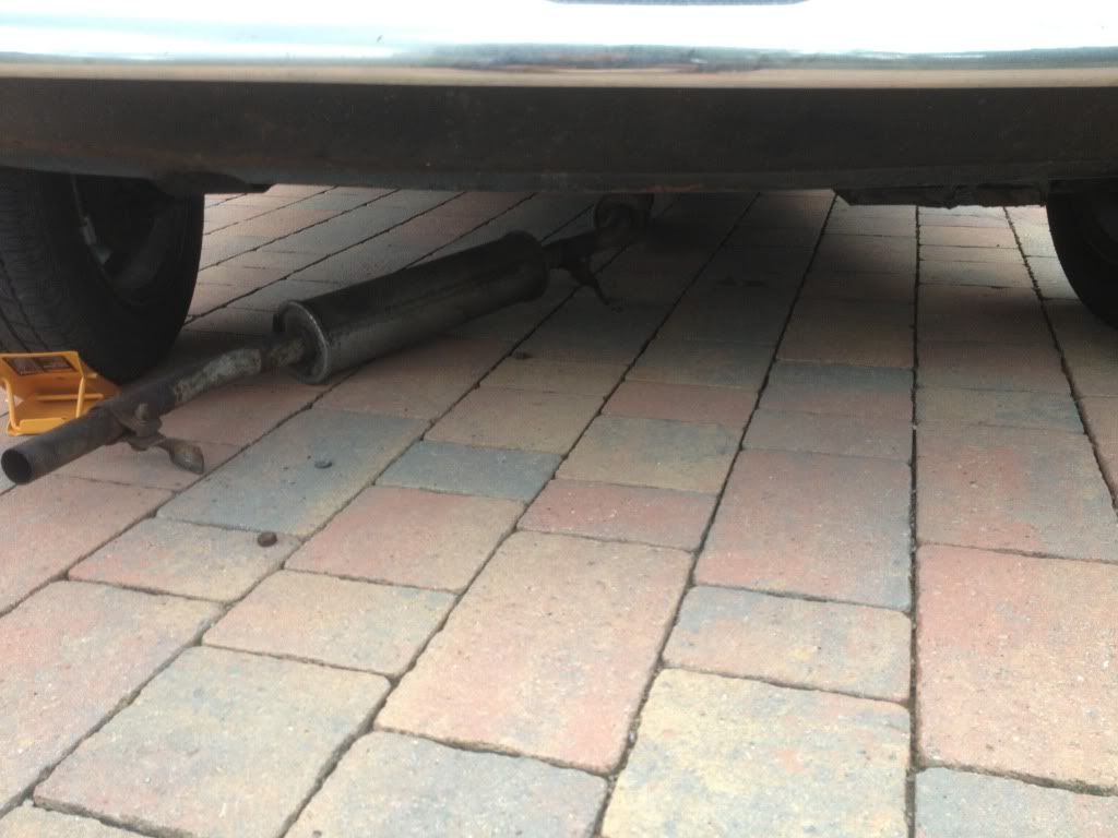

so today i started my stage 1 upgrade on the checkmate (after popping to a classic car rally in the landy)  ive got the old exhaust off
EE324921-0E44-499C-A157-C839754321D0-460

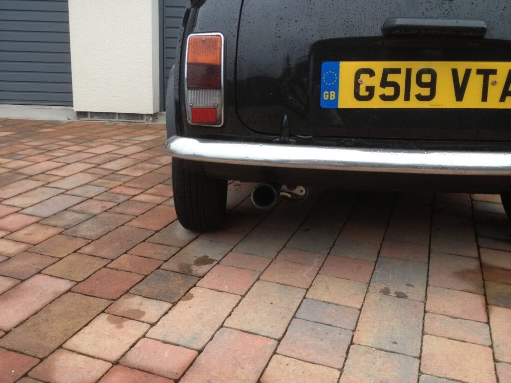

i got the new exhaust in :D
33FE78E7-B096-4FA0-A14D-4DD38236A34D-460
so the RC40 exhaust, maniflow exhaust manifold, mini speed inlet manifold all fitted.
i tested her before i drove her tomorrow morn, and she is running like a bag!!
ive got a 'Red' spring for the carb a pipercross air filter and a stage 1 needle for the carb but they havnt been fitted yet. is this just a case of no air getting in but no back pressure as too much air is getting out ??
