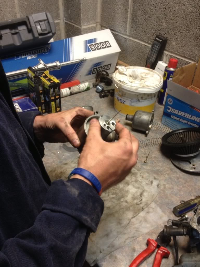

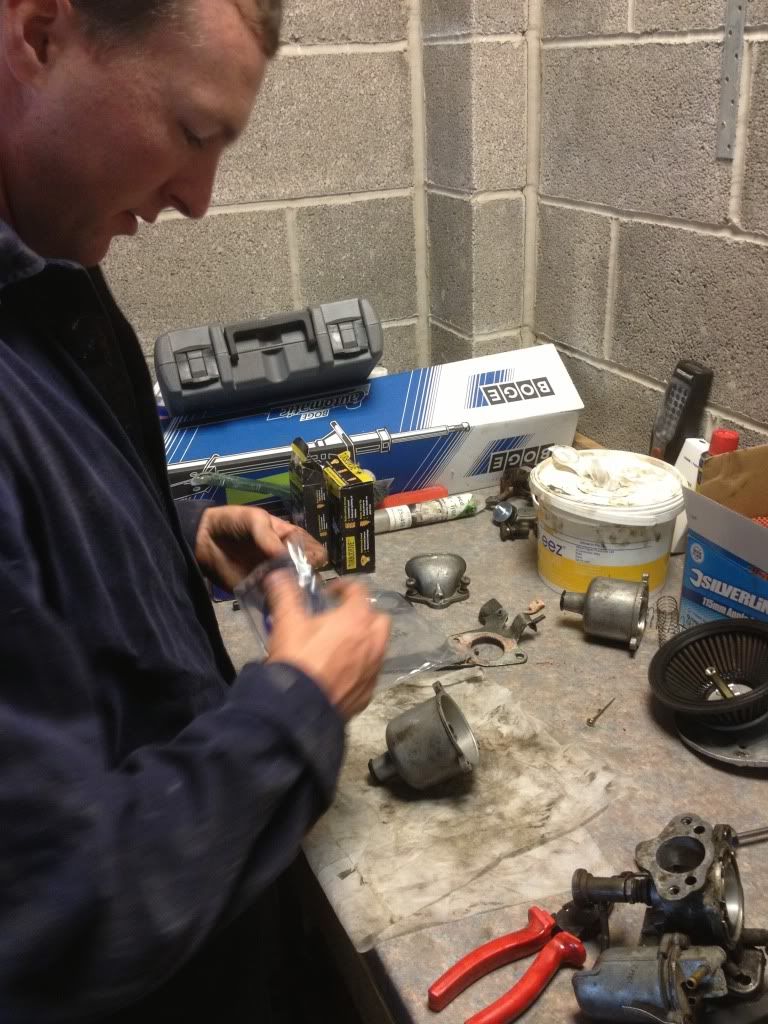

6AF45609-7632-46AC-9D17-24605A81E77D-553
B5FDAC86-F3A8-4198-B23E-7B179C03E562-553
this was me today i made 1 carb out of 2 as the original needle in mine is seized in the piston!
So i dont need to fill the whole dashpot with oil just the center pipe that the dampening piston goes into ??
#40 jaydee
jaydee
  • 8,565 posts
Posted 05 August 2013 - 07:39 PM
Exactly, just the small inner pipe
Fill it with engine oil, then carb will 'self-level'
