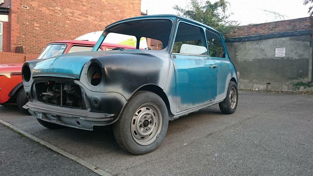

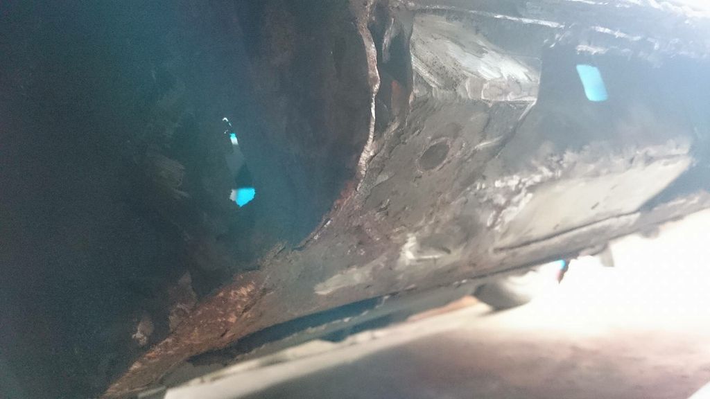

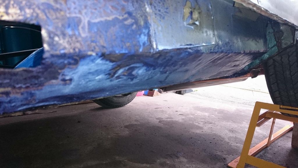

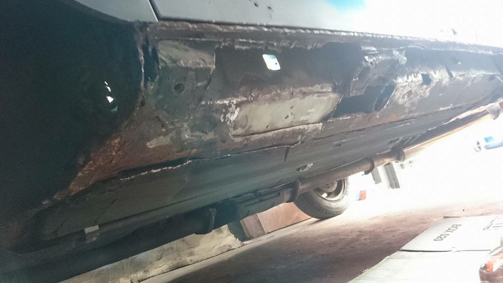

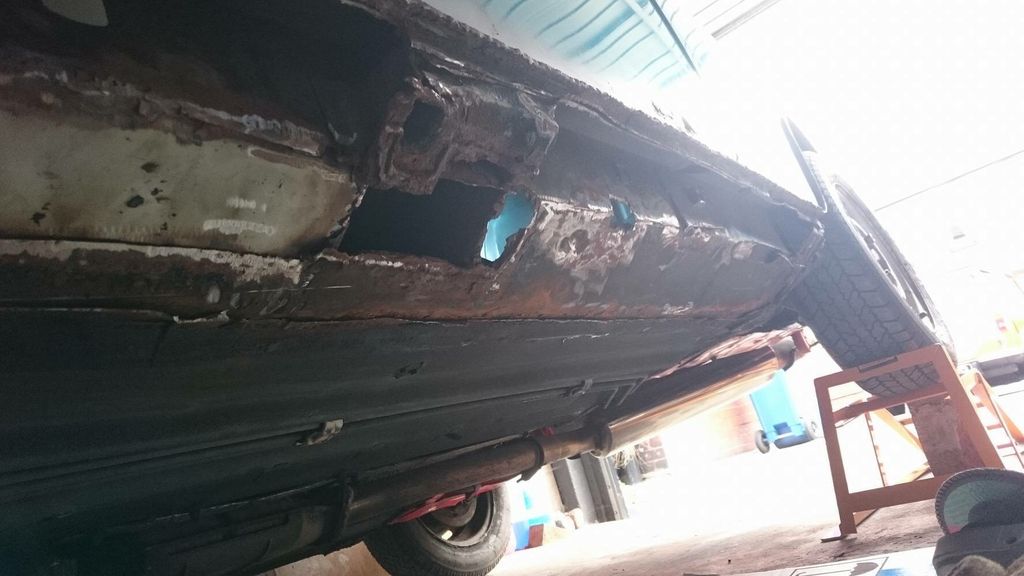

Hi all right made at start again. Started where I left off and that is with the passenger side over sill issue. Started to cut back and get the inner sill ready for some new metal have to admit she is worse than I thought in this department. Some pics to do the talking.
Up on stands ready for work
10fb4d8b096c35524c8e213c6e748b33_zpsfqig
aae0a3b90af4af4c62c227e2af6994cb_zpshoxu

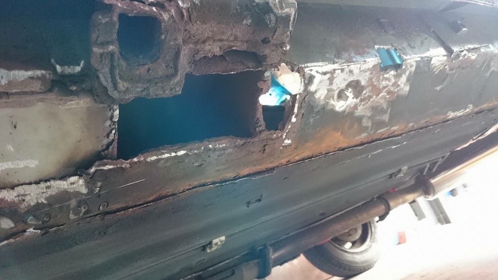

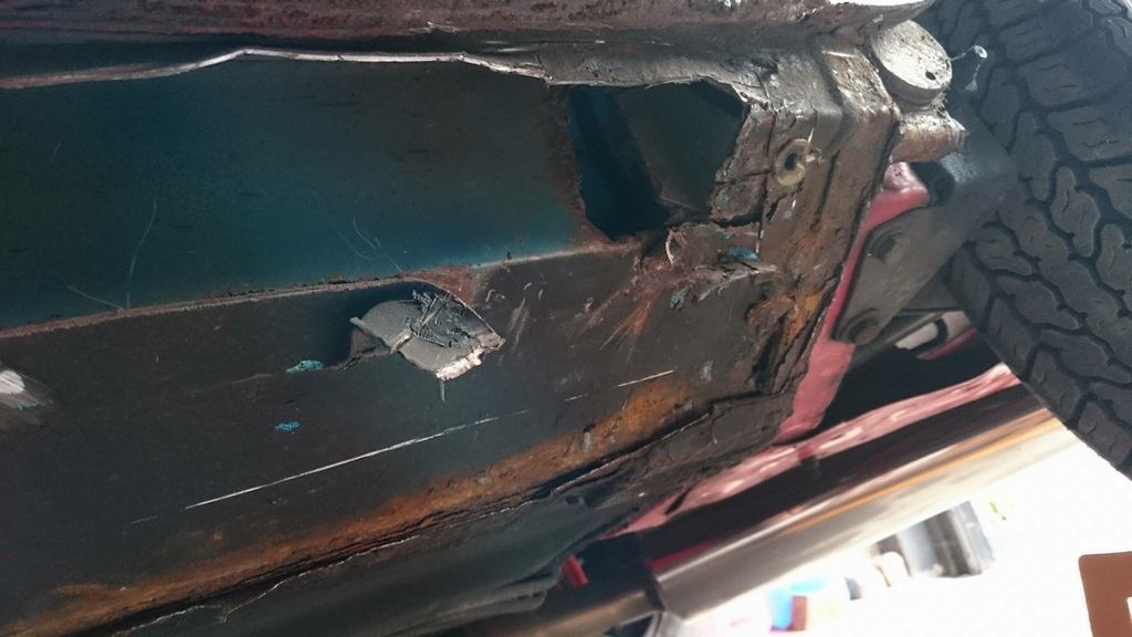

I will need a patch in the flitch panel as well
f37f65e3a315ca1ceb179b74691a2e95_zpsbf1n
4a0c88eab5a5b7f8e4c9e39c73749897_zpsqtzo
9778848845c6568cd44496bfbe742463_zps4pq1

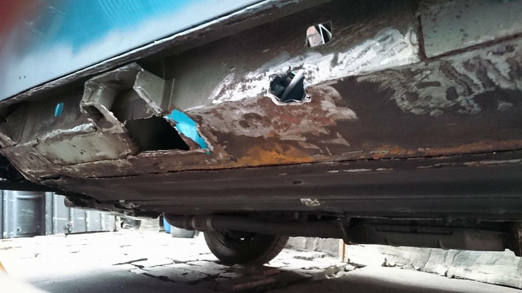

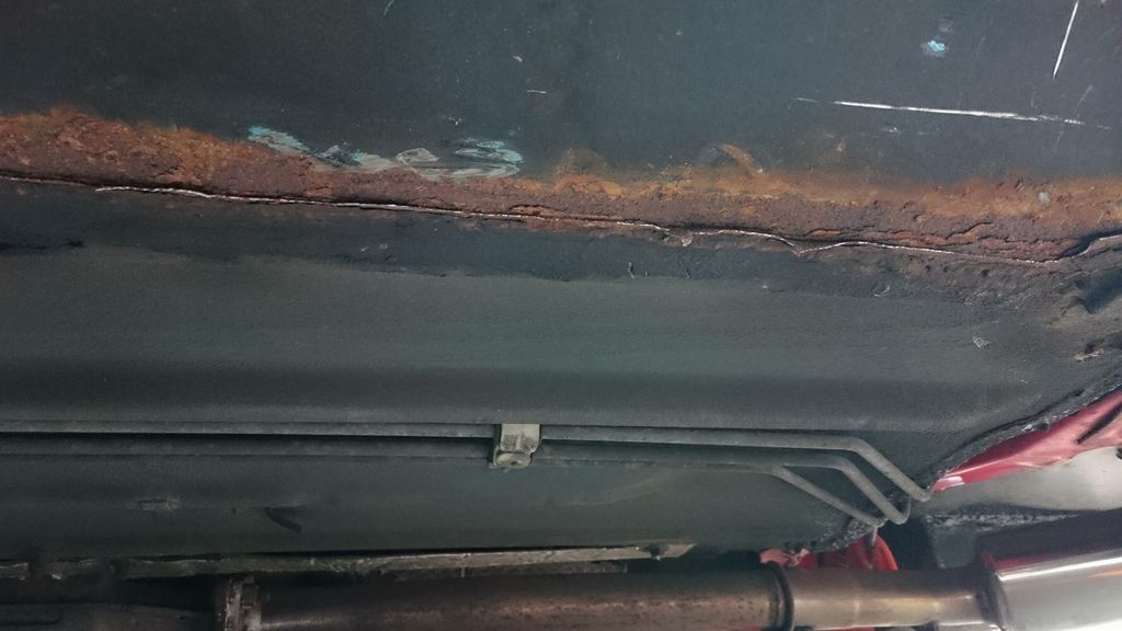

Nearer the rear

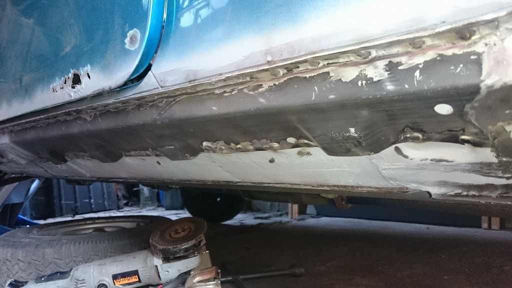

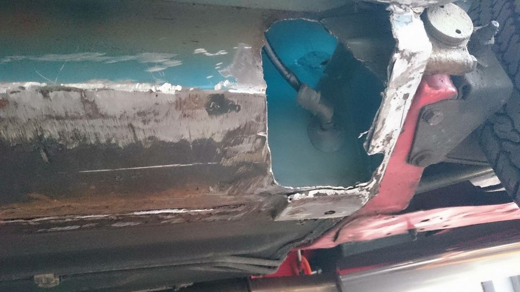

Started to clean metal up and cut ready for new metal.
2abd88acde0630009e429d7d9dee68bd_zpscep5
d5f49066c95443d53ae01b6e014f002e_zpshhpx

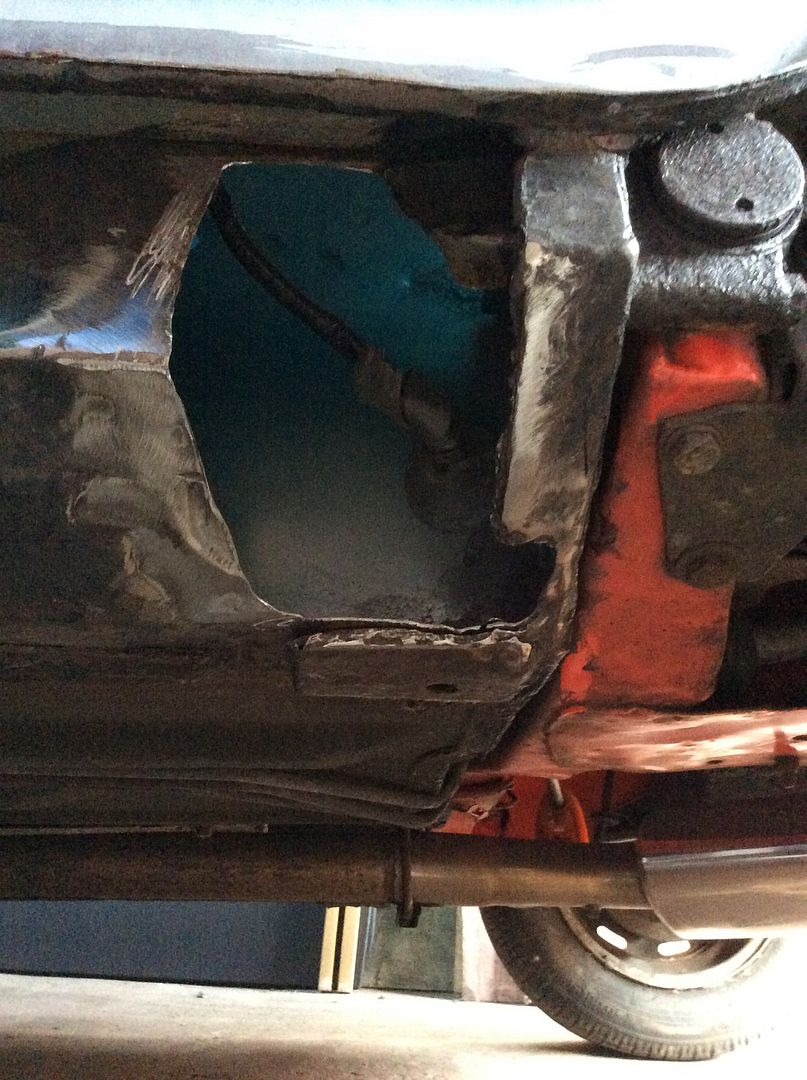

Got an even bigger hole in my rear companion bin
25a3b3fff26ae99c423b7b71041ae5c5_zpswa7f
Rust treated.
656dff9f36a88524cb1ea9b23551ca9e_zpsyh4q
This is as far as I got more to come. It has got to be said I hate over sills.... The amount of damage they cause and cover is mental.

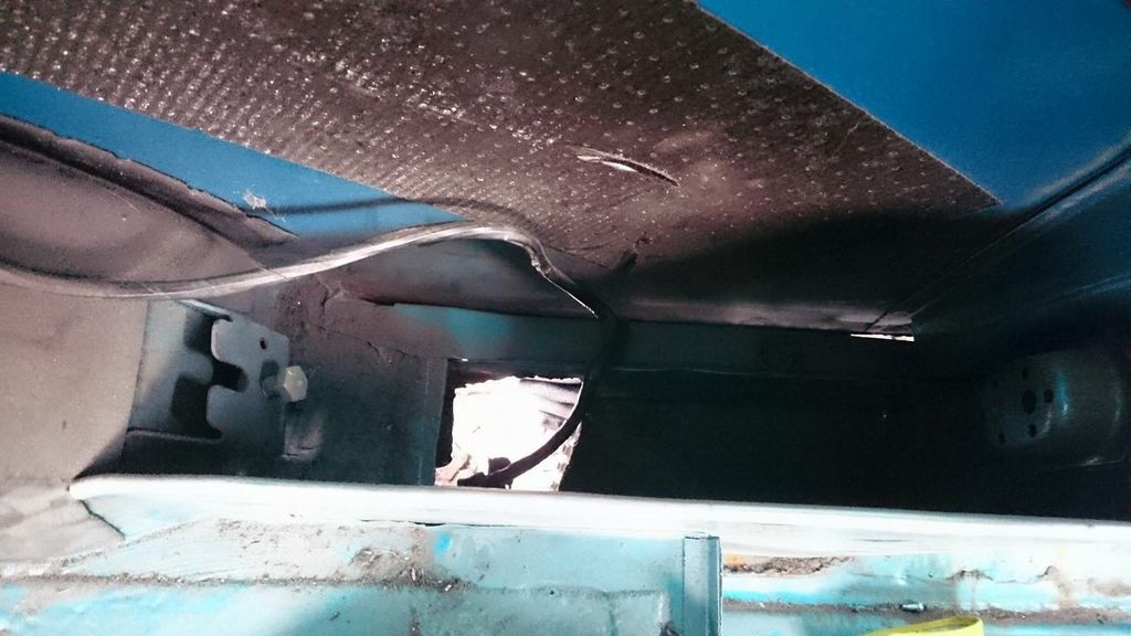

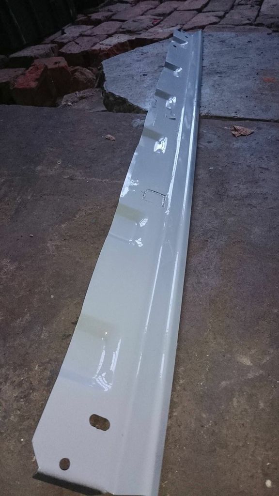

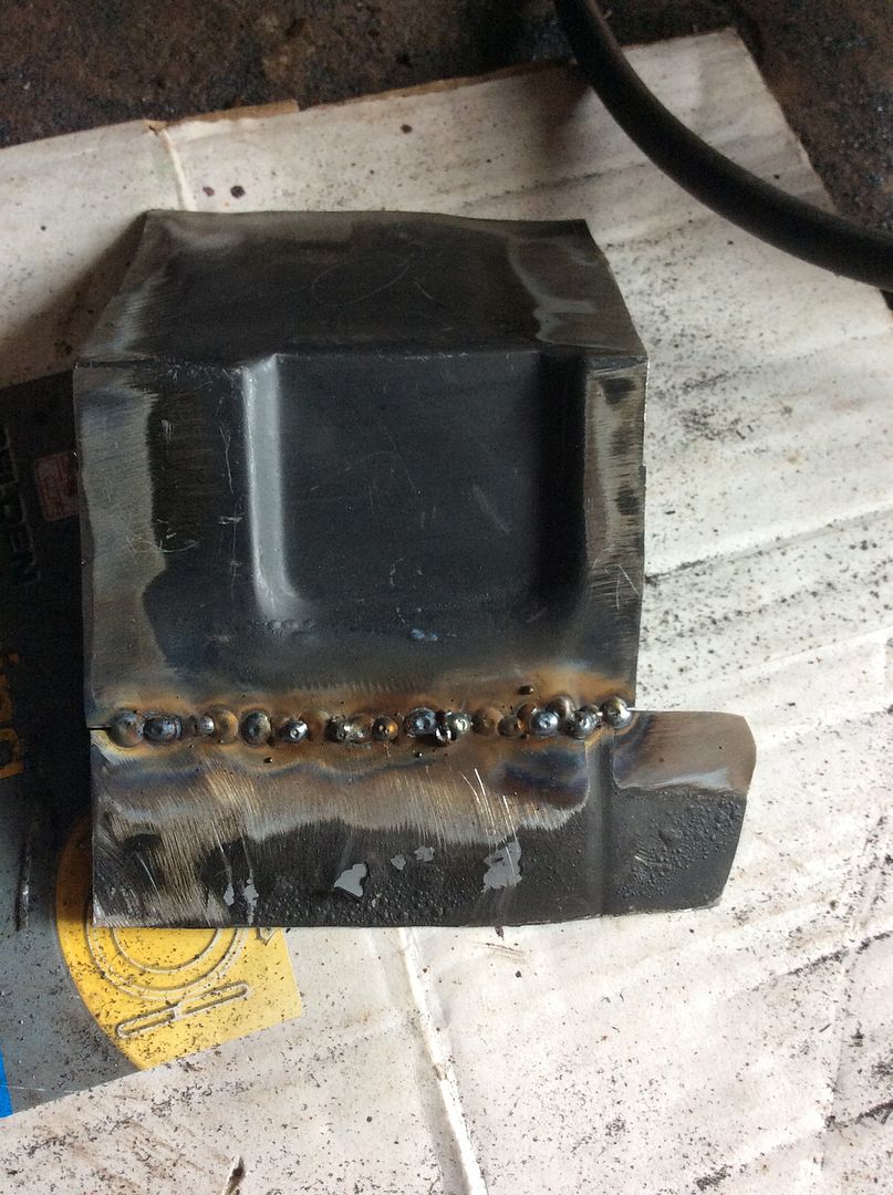

Managed to get some more done today started with prepping the repair pieces ready to make the inner sill solid again. The inner sill is now all welded up, etch primed and seam sealed we are so very nearly ready for the new sill.
The aim is to have both sills and inner sills sorted in the next few weeks and then I will stone chip the floor pans.
5557337fe5911e09dbf0dd24c759f15e_zpsvvid
Made a repair section up for the rear part of the inner sill
5fe0fdfeeb5995b73c017fce59a214e6_zpsrhwr
3bdc24bb8c326b97b9e31898fa1a2b90_zpssdta
Ground back and etch primed up, ready for some weld seal. I have done the whole of the inner sill so all holes are gone but forgot to get a picture of the middle bit.

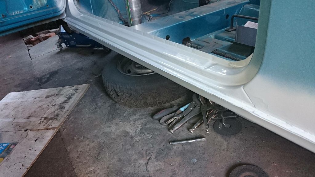

  • Local Club: M.M.O.C
Posted 02 November 2015 - 11:15 PM
Update time,

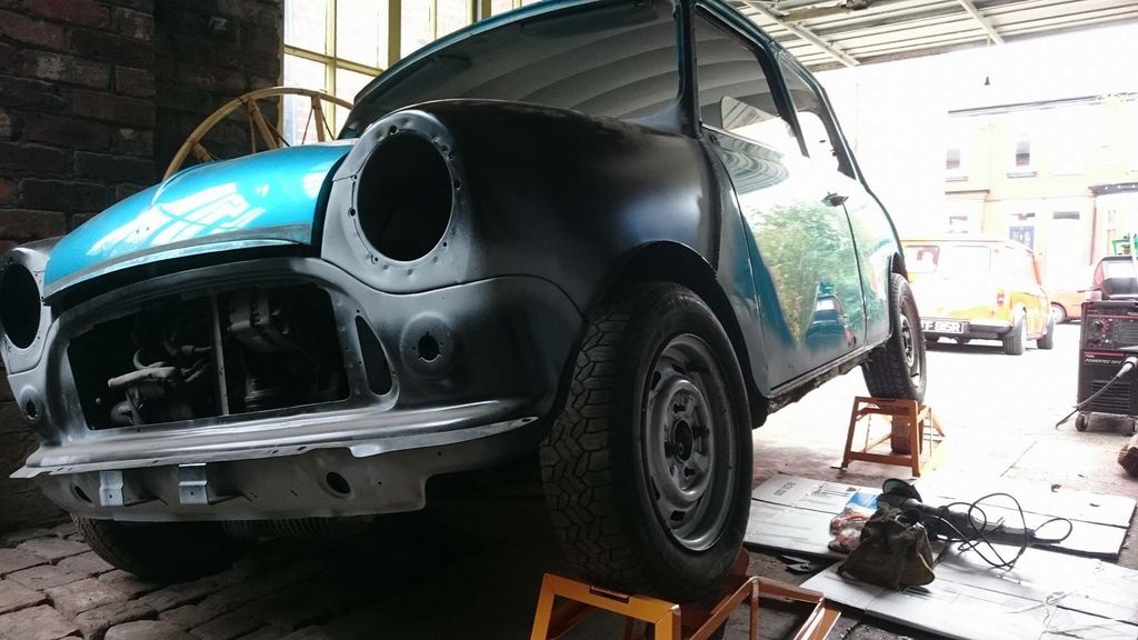

I now have the sill on the passenger side and the repairs all done, I am quite happy with it, need to tidy the underneath up still where the old sill went but so happy that that is one side done and solid again, everything has been sealed and zinc primed. Also cleaned door step up and primed that.
Next job is over to the other side to start the same process again this time I can see there has been a previous repair that just looks terrible so that will come out as well.

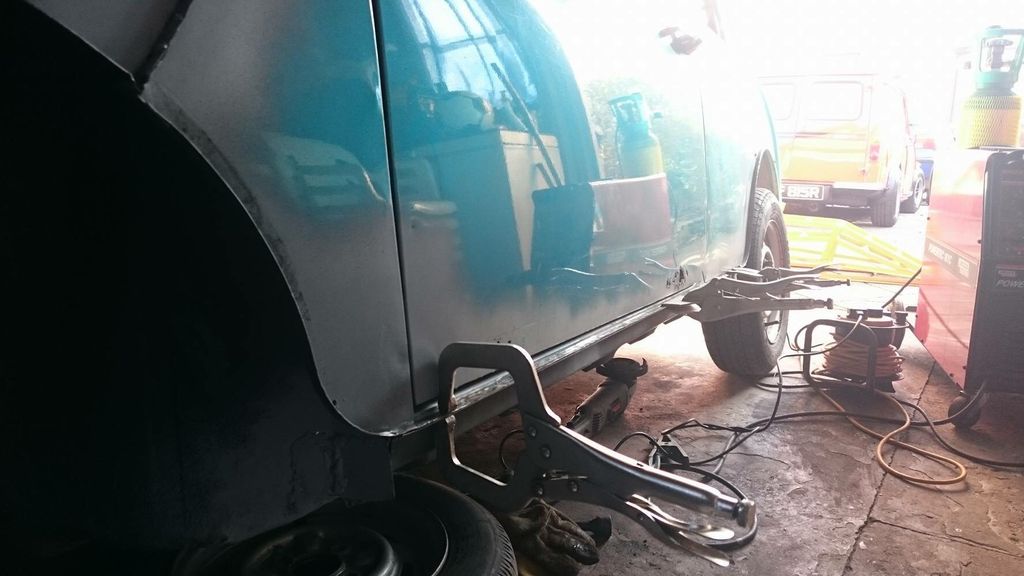

Pics of progress, comments welcome :)
Clamped up and ready to go,

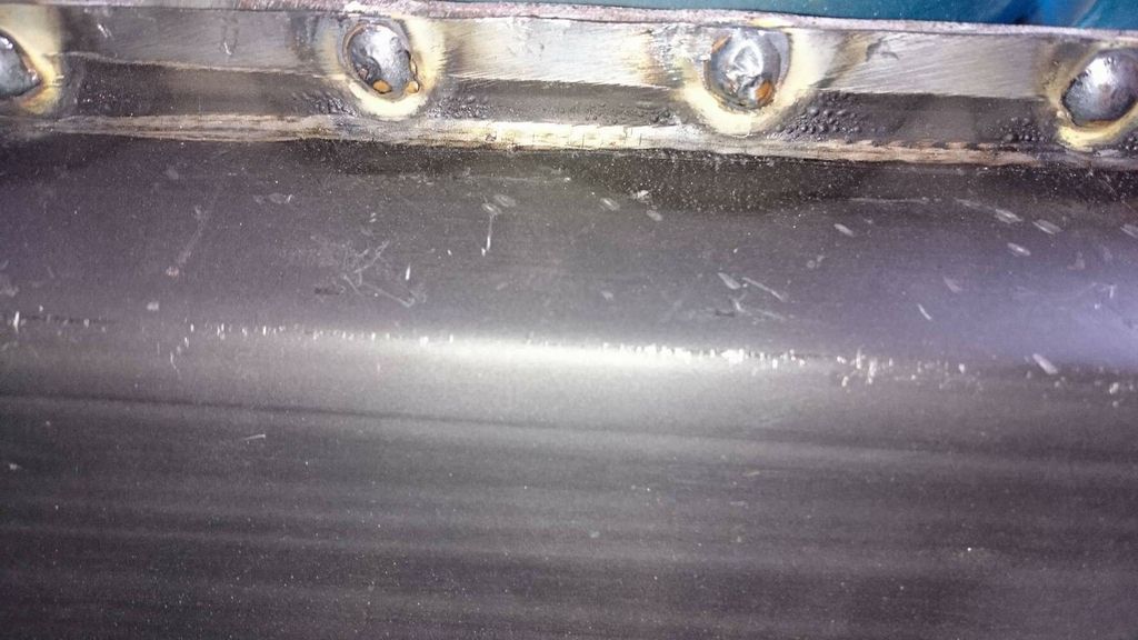

13c63c0b6daad1dcfcc68a0c37f91cca_zpsymgw

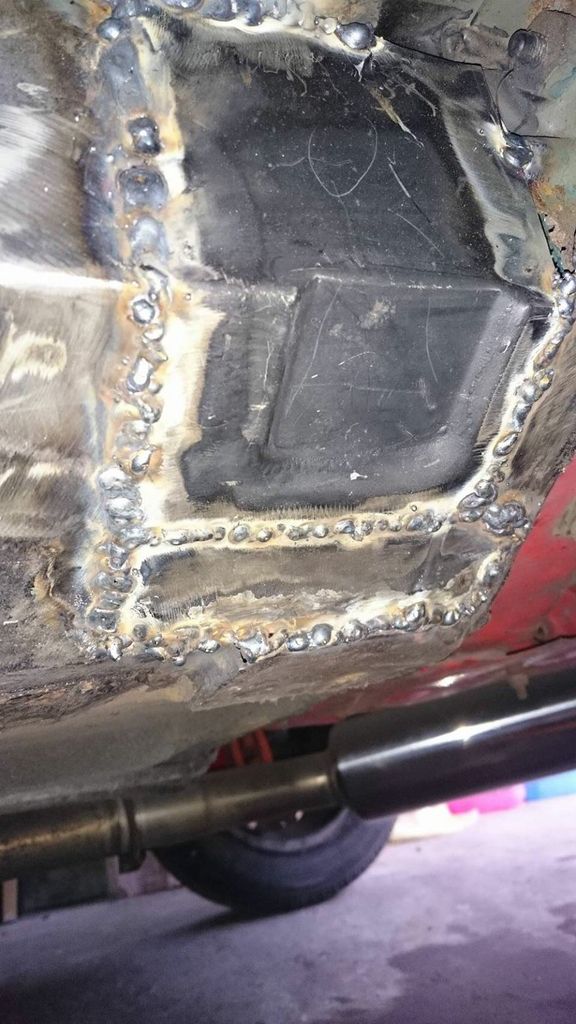

Plug welded up.
8317fae2e6ebfec14b349b5a8e5e6233_zpsqb5q
Ground back the welds.
c028c54194c3b467bf1beb8a8ee71bf7_zps0q95
The sill is on well happy no more over sills this side
87bba95846e26d115ac32f8b40703e22_zpsvqkc
All primed up to protect it all still need to tidy rest of floor up ready for some stone chip but will stone chip the whole floor once the other side done.
583a77c99385831f6d62c6a416457260_zpsjxfp
Cleaned off any surface rust off the door step area treated primed again
e94edeca64d29d43d324267d1e2e09d2_zpstvat
This is how she sits now turned around and ready for the next side to be cut out.
21e4d357ca1a0567c5cd5faad24e4c88_zpsm28b
Thanks for looking
