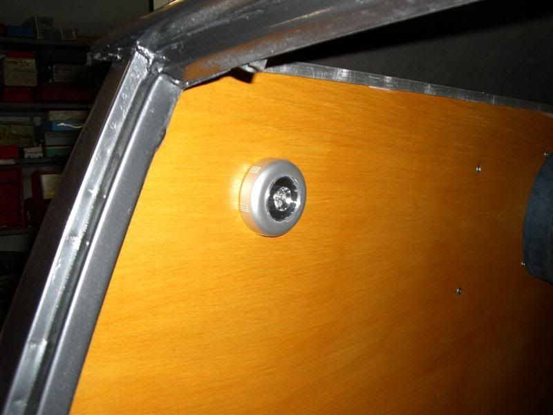

Fitted a pair of LED lights in the back:
Also bolted the seats down, which was a fiddly job, but all done now. Dad changed the needles and springs in the carbs - the old needles were HUGE! probably explains why it was running so C**p... I've fitted AAA needles now as recommended by AC Dodd. I fitted a secondary fusebox on the passenger side as well, and it all works :cry: I think I'm actually getting the hang of this electrics stuff! Also managed to drill my finger as well while I was at it, which wasnt so wonderful :cry:

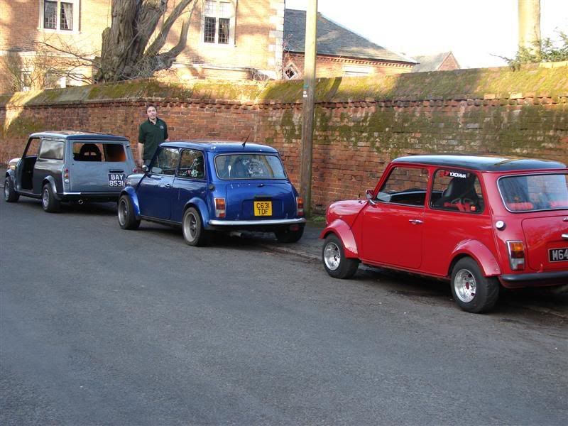

And the van with the rest of the fleet:

Whos is the red one Tom?? Are they the splitties that RacingGreen had made and then sold??

Cheers everybody. Mark, the videos were done by my mum, playing around with some new video editing software, which was very nice :thumbsup: Pie, the red one is my cousins 1380 beastie, he had the wheels done by fastcarl as well.

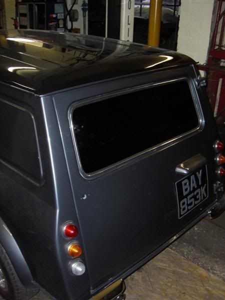

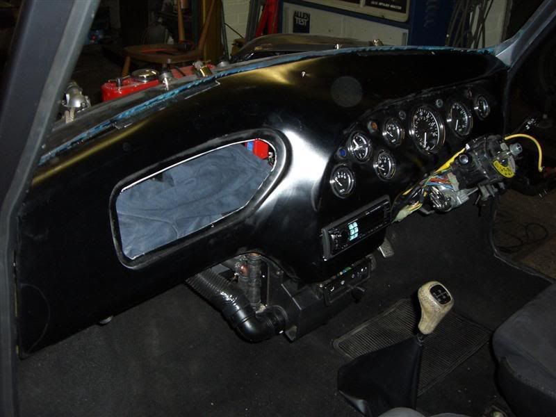

Anyway, been another busy two days. Yesterday I pulled it out of the garage to give the blue one a service, which took a while. Had to replace a CV gator that had split, but that was about it. After that we built the doors up for the van. What a horrible, nasty job that is. If I do it again its definately getting mk3 doors put on it. Also had a nice big sheet of polycarbonate turn up so we got the back window cut to size. Today I went and got it tinted, fitted the window, fitted mpi sound deadening behind the dash and got the dash fitting right. Not a bad days work!
Pimp my ride:
Dash all fitted and it all works now :dontgetit: Not bad for someone who was terrified of anything electrical not so very long ago
