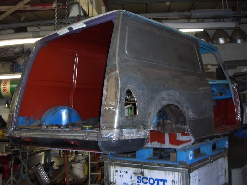

Whoohooo! All the panels are in! Finished the rear valence today. All thats left is some little patches and to fab up a tow bracket. We welded some nuts on the inside of the rear valence to mount the fuel tank to, instead of those crappy little plastic bungs. Repaired each end of the rear step, where some 'tard had abused it with a welder. I also think I've got some 4 pot brakes to fit under 10"s. Life is good!

Ok then. Its official. I'm a complete pillock. Had a look at my twin carbs today to start getting them on an A series manifold. First task - get the old spacers off and the asbestos heat shields. Two sharp cracks with the BFH and a bit of levering, job done. Out of curiosity I measured the bore of the carb - 1.5". Bugger. I've been saying they are 1 3/8" cause thats what the air filter side is. oops. Next job - make em fit the a series manifold (thanks for that Dog) Cut the linkages down by 1/2", and the fuel pipe at the bottom, wonderful - right width. The studs on the a series manifold are about 2mm too big for the hole in the carb, so bang, bang, widen the holes with the pillar drill. Oh feck. Guess who drilled the two holes on the filter side of the carb? Followed by about 10 minutes of solid swearing. :(
Anyway, they go on the manifold, and thats the important thing.
