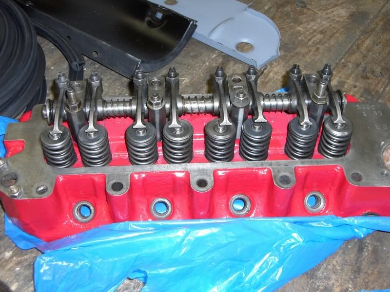

Stage 3 head - ported, big valves, double springs etc.

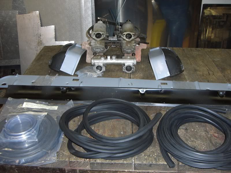

More bits n bobs: all the panels I need to finish off the back end, my twin carbs, and the a series manifold for em, and all the door and window seals I (hope) I'm going to need!
Got the allegro manifold off the carbs and found out they have the wrong linkages - they're about 1/4" out on the studs. I think we'll be able to just machine the linkage down though so they fit. Just spoke to my mate with the MPi, and the insurers are taking their time getting back to him, so it may be nect weekend now when I pick that up.

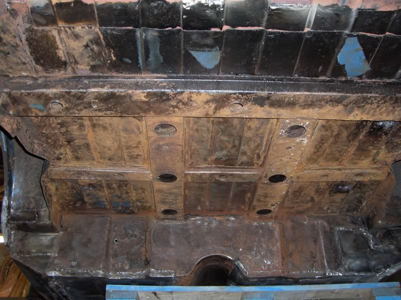

Got most of the scaggy old underseal off under the back, and welded across the heelboard. Got a serious amount of spatter down my back and on my head as well. :P
The front is so very near to being sorted (heres hoping!). Got one little hole to weld up, clean it all up with the grinder and paint it. We also got MiniMatt's 1380 in, so I now have my 1275 to sort out in between bodywork sessions!

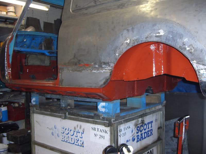

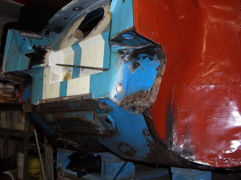

Fappin' great day today. Attacked the nearside rear quarter:

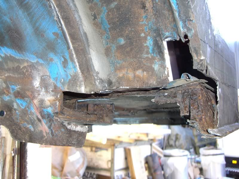

Of course we found more hidden nasties (getting a bit boring now!). Today was the back subframe mounts. Looked ok from the outside, stood up to the screwdriver test, but when we got it opened up it was rusted badly inside. Made a monster repair patch up out af 16 gauge galvanised steel - that aint gonna rust again! 'specially not with all the waxoyl I'm gonna whack in it.
Got the M-machine repair panels welded in, and made a few of our own inside the wheel arch, its come up very tidy.
Ground back the welds and painted it all - I love it when something goes right!
Last night I went down to Northampton and got a windscreen with a green sundym tint from Icklemini, and a pre engaged starter motor for a tenner. Bargain! Spent about two hours talking to him, learning how a mini gearbox works ;)

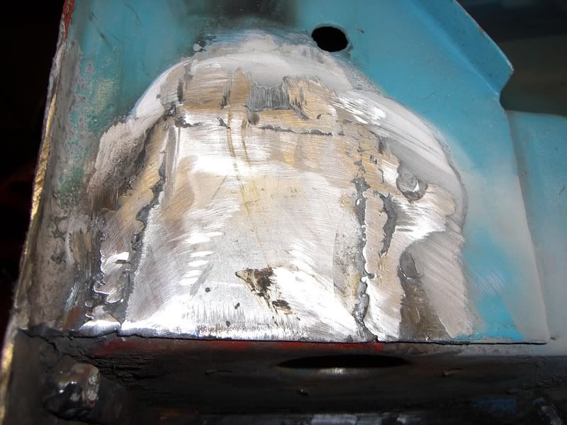

Just when I thought I'd done all the welding on the front, I noticed that the filler on the front of the top subframe mount was bulging suspiciously - so I gave it a crack with the hammer. Of course, a great chunk of rusty filler dropped off, there was that much on there it looked like it had been put on by a plasterer! One swift plate later, and all was well. Front end of the car is done now! whoohooo!
Got all the front painted now. Just need to seam seal it and get some stonechip to spray it with, then paint it with black enamel. Should last a good few years then.

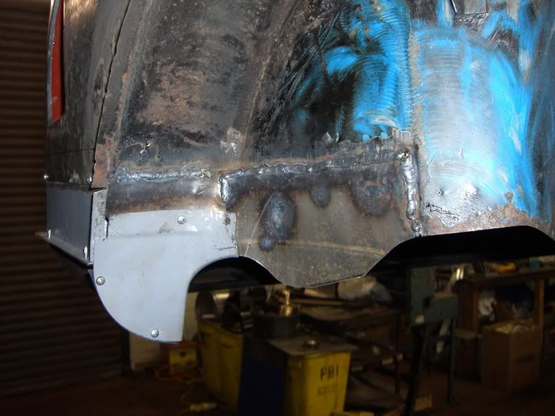

Cleaned the nearside sill off and painted it. We've also got the panel made up for the subframe mount on the other side, and the floor is just about welded up. Another 2 days welding and we should be done :(
#99 minivanman
minivanman
  • 3,454 posts
Posted 08 February 2007 - 08:51 PM

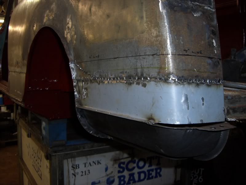

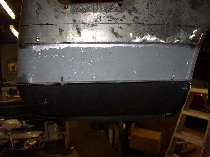

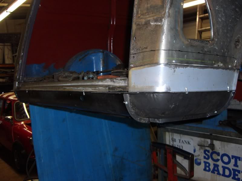

Had another couple of days working on the old girl now, and its moving along swiftly! Today we got the offside subby mount on, all (I'm fairly sure this time!) of the rust cut out and ready to be plated. The rear corner is screwed together to test fit, and when we offered the centre of the valence up it fitted perfectly between them. :angel: One more full day should see the welding done. When I get it back on all fours I need to get it up on its side and weld a bit in the exhaust tunnel and that is it! I have been seam sealing all the welds as well and I've got 2 big cans of stone chip ready to go on.

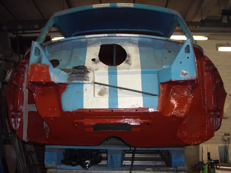

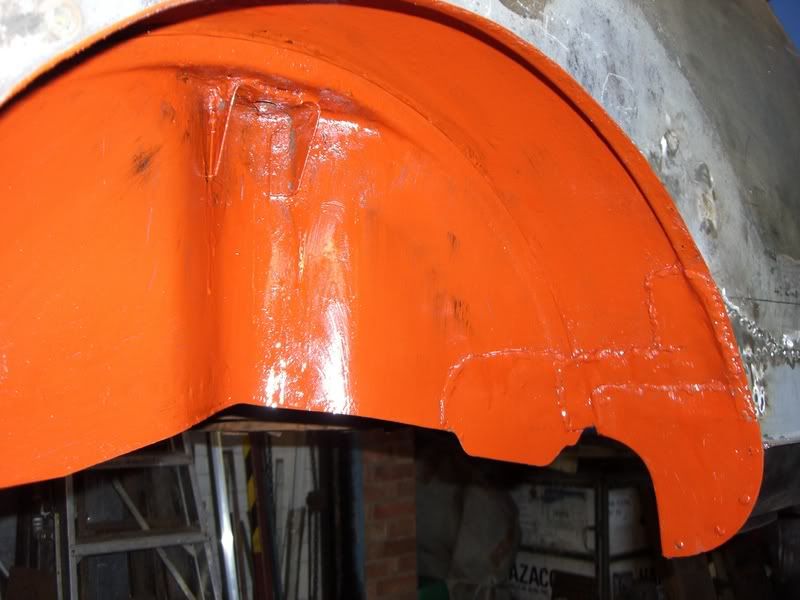

The back end is all assembled with screws now, and I've plated the last few holes in the floor. They aint especially pretty, but I'm not bothered because I'm panelling it out with wood anyway. One thing we are going to do is have provision for a tow bar/ towing eye.
Wheel arch - just needs seam welding and painting up now. Almost there!

Posted 09 February 2007 - 11:30 PM
Missed a bit :angel:
