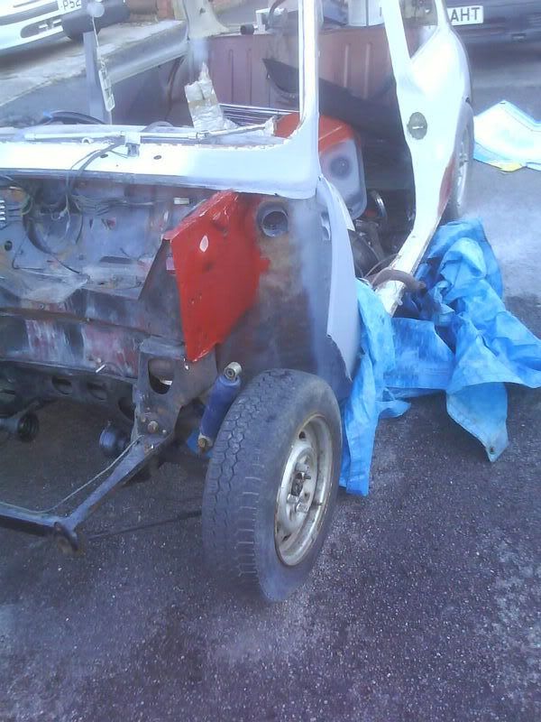

Ok been out today, and had a really good productive day :)
Got the welding 99% finished :withstupid:
Still a little tarting up to do with the grinder and a file, but won't take long.
Also finially got myself a tin of red oxide :ermm: with 750ml of thinners... £17 all in :crazy: not bad eh!?
So after dodging the rain, which was a PITA today, I got most if the welding done...

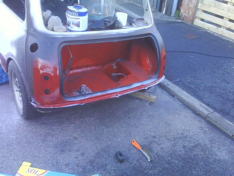

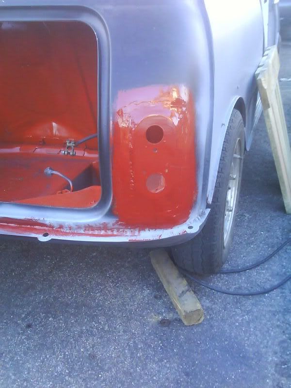

MK1 light plates are now on :( red oxide'd over the top still need to be smoothed off, with filler, but thats a job I can do when the MIni is finially able to stay in the garage...
Also finished trimming the front end up, and red oxiding that, took the shock mounts off, to see what was lurking underneth, and quite surprisingly found the metal underneth is ok :) so a lick of paint and all is good.
Need to order some "lowered" shock mounts next. Loosened my subby bolts, ready for the "big" drop tomorrow.

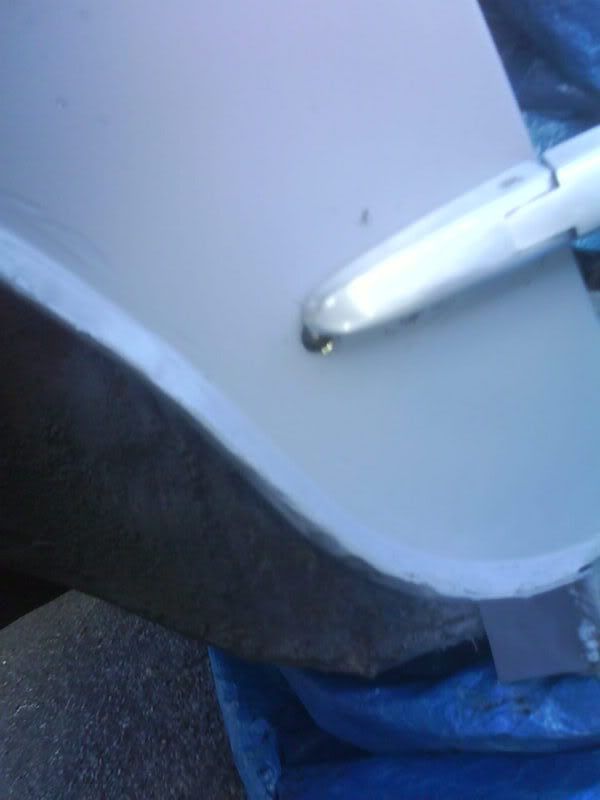

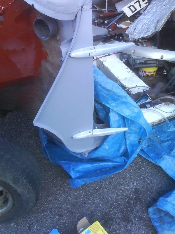

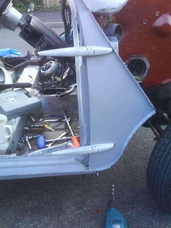

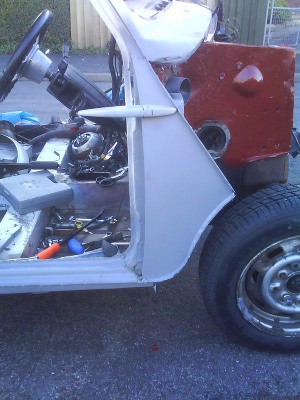

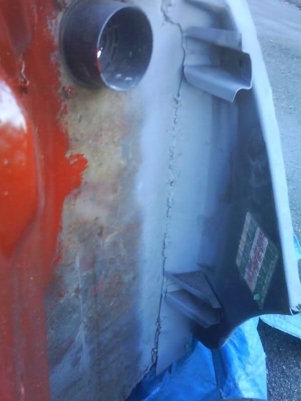

Fitted my exturnal hinges to the A panels... and who ever is doing this, make sure you drill the outter A panels first, as I missed the holes on the lower mounting points, but luckaly the hinges will cover 98% of the hole...
Well thats enough of me waffling... heres some piccys...
One of the hinges fitted :)
One where I was slighty out on my measurements.... :-
Hinges fitted :proud: :D :D :w00t:
Dead easy job to fit... little trimming to get it to line up stright and level, but done all non-genuine panels ;)
Not sure who wanted to know, but this is the inner A panel needed to fit exturnal hinges...
Mk1 light plates fitted all looking pretty....
