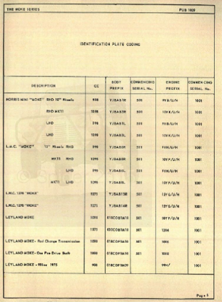

Here's a listing of the Mini Mokes & Mokes and it shows the wheel size and the official name of the vehicle at those times
