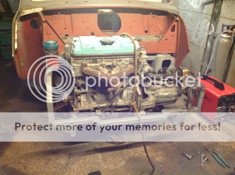

Front subframe nearly completed, still a few bits to sort out to make it look better.
Car level, sorry about the pic.
Engine and gearbox level in frame.
Engine in final position, best I can get it in there, has a slight forwards tilt.image_zpsfz2wyuwx.jpeg
Edited by cookie4343, 07 February 2016 - 06:02 PM.
#35 lawrence
lawrence
  • 1,341 posts
Posted 08 February 2016 - 05:21 PM
Great looking subframe and install there mate, engine looks really happy in the frame.
Now personally if I was yourself I would completely smooth the valve cover over bar a tiny place to top the oil up :) but then again I like the smoothed valve cover type look!

Alternator done today, top original bracket modified and new one made up for bottom, need finishing but it fits and clears the front.
The drivers tie bar is still catching the corner of the block so how bad would it be if I moved the tie bar fixing points say 5mm out just for clearence.
#39 fuzzy-hair-man
fuzzy-hair-man
  • 181 posts
  • Location: Armidale NSW
  • Local Club: Minis in the Gong
Posted 14 February 2016 - 12:10 AM
I think moving the tie bar mount could start all sorts of headaches. I'd be inclined to investigate how much room there is in the sump to relieve some room, on my micra conversion I bashed it back with a hammer, I recently had the sump off to seal it up and there was plenty of room it could've gone in another cm or so easily.
