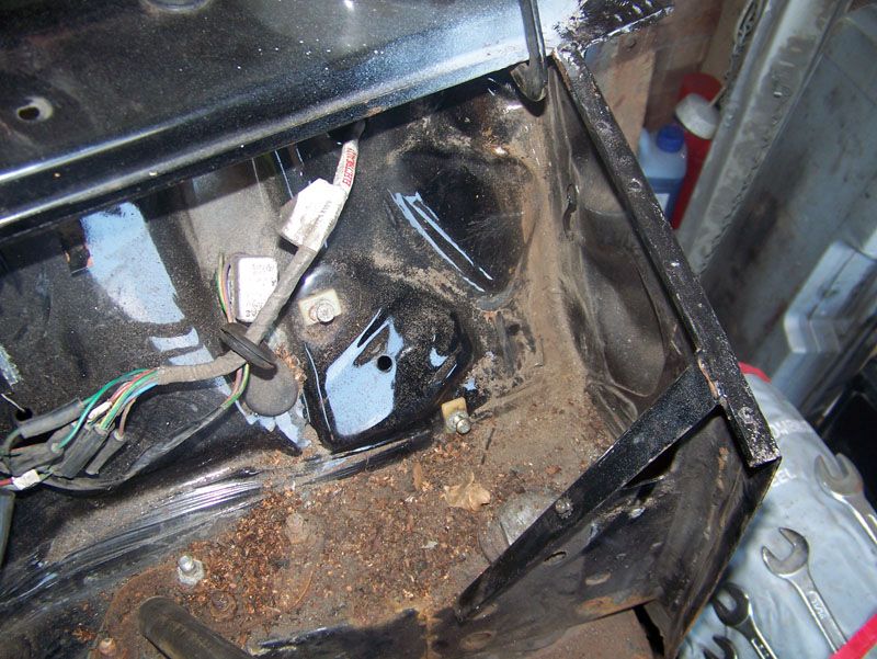

Well thats peculiar. Light Green/Brown and 2x Green is the flasher/Indicator relay.... Purple/Orange and Light Green/Pink is the hazard relay. The latter have been cut.
So what is this flasher on the firewall?
Edit: Ah, the silver flasher may be the old, redundant relay since it was replaced. Apparently there should be wires running to that connector on the firewall, but they have been cut off.
As per this photo
b0bdc690c21481aeeddb84e73e25b448687f9e85
Edited by kws, 15 June 2018 - 10:33 AM.

There's usually 2 flasher units one for hazards, one for flashers.
The flasher one can usually be found near the brake pedal if my memory is any good.
They also moved them about from year to year! Light green wires is usually hazards and dark green for indicators.
Cheers  :proud:

So do I have power at the front park lights?
I removed the lenses to check. Well, at least I actually had bulbs here.
The answer was no. No power. The bulb looked manky, so I swapped for a better bulb and then went digging whilst the park lights were turned to ON. Whilst probing the bundle of wires that runs behind the grille I noticed the park light flashed on. I narrowed it down to a loose connection in the power feed joiner in that bundle of wires. I don't know why they have weird joiners there, but they don't seem very reliable. I cleaned what I could, and this was the result
The other side was a blown bulb
Well that's a great success. Now, what about indicators? I still had nothing at all, so whilst casually browsing the wiring diagrams I made a list of places to check for voltage. I had nothing up to the hazard switch (which the indicator power feed goes through). I removed the switch and noted some corrosion on the terminals. I cleaned the terminals, refitted the switch and heard a faint "click" "click" "click". It turns out this was happening.
Indicators!!!!
I don't have hazards because the wires are cut, but I'll try getting another flasher and seeing if I can get that working too. The rear indicators are working now too, along with the dash indicator.
Very happy with that. I haven't got reverse lights, but hopefully I can get through the inspection without them.
You may also note that the headlight trim is missing on one of the lights. That light works on high beam but not low beam, so obviously its blown. I didn't notice the little words on the bottom of the light, so I removed it to see if it was a sealed beam or not. It is, which means no easy bulb replacement (sealed beam means that the whole light is basically the bulb and gets replaced).
I have ordered a replacement pair of semi-sealed beam lights, with replaceable H4 bulbs and will fit them. I do need to take note to not exceed the standard wattage of the sealed beam bulbs as the wiring wont handle more without adding relays.
Another electrical item I cleaned up was the starter solenoid. The seller advised that two of the wires were getting hot, and looking at the wiring diagram the only option for grounding the unit was against the inner guard via the mounting bolts. Having a look around I noticed that the whole lot was covered in oil and grease, and the mounting bolts were tiny with no washers or anything to spread the contact patch.
I removed the solenoid and hosed the lot down with brake clean
I wire brushed the mounting holes front and back, and found some star washers to put under the nuts
And then I refitted the whole lot. Woo.
The last thing I did today was to fix and refit the wing mirror. The mirror had come off the mount. I removed the mount, disassembled the mirror and reassembled the mirror on the mount.
I know it's not everyone's favourite style of mirror, but it'll suffice for the registration test.
So that was today. Lots of ups and downs, but overall I'm slowly getting there.
